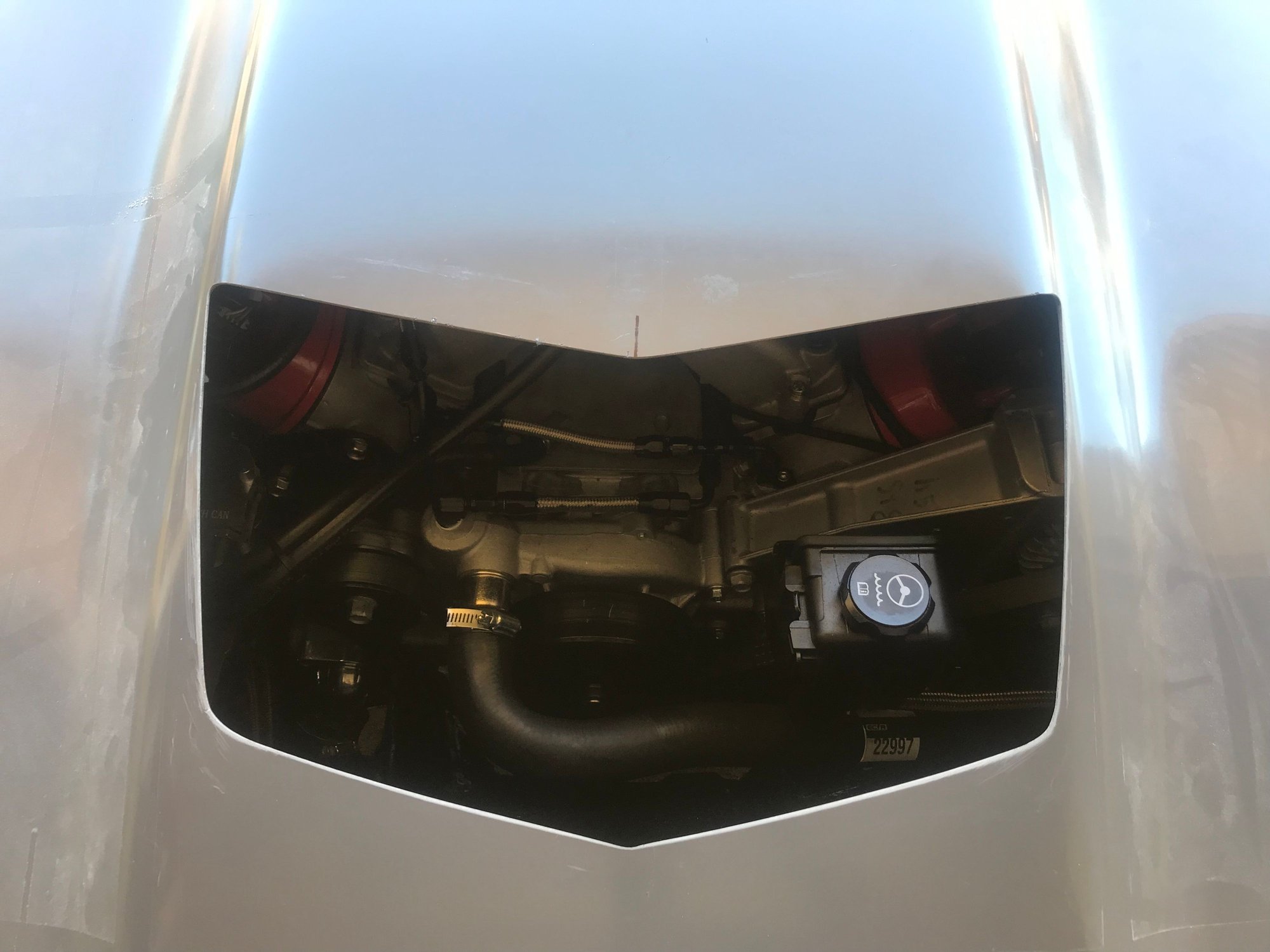

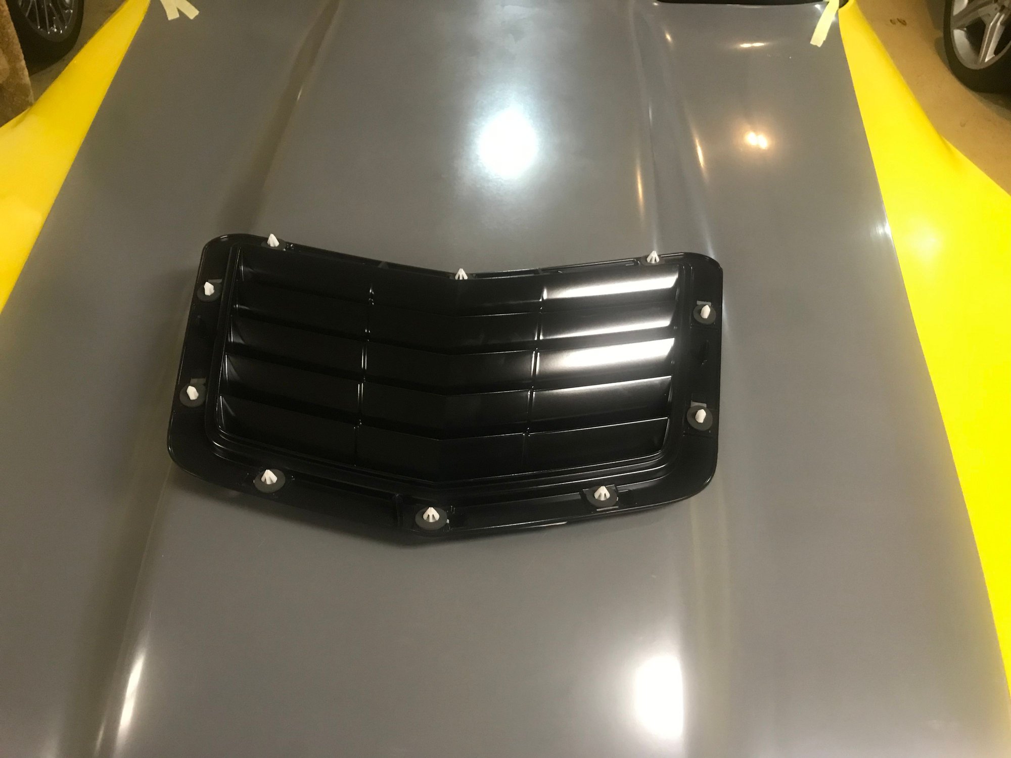

Holy **** Batman. After driving the car like an econobox for two weeks, yesterday I gave it full throttle and redline a few times. Oh my gosh! Traction is very limited in first and second and the start of third gear. Redline (I’m using 6000rpm for now) comes up very quickly and your hauling ***. The car is very quick and almost scary. It could use traction control like the 427 Vert, and I see why they say never turn it off. The 180 degree thermostat is great and the engine runs at 190 degrees now. The C7 hood vent is here, but the backside is 17 1/2” wide. The raised hood surface has narrowed 17” wide. I’ll need to trim the vent in the back before making a template to install.

Factory C7 vent from Corvette Mod. $150

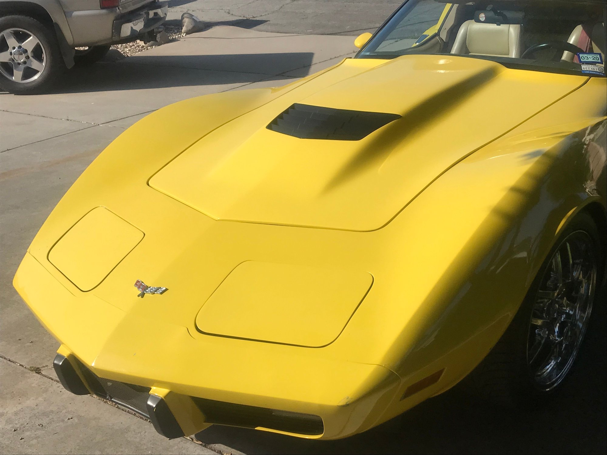

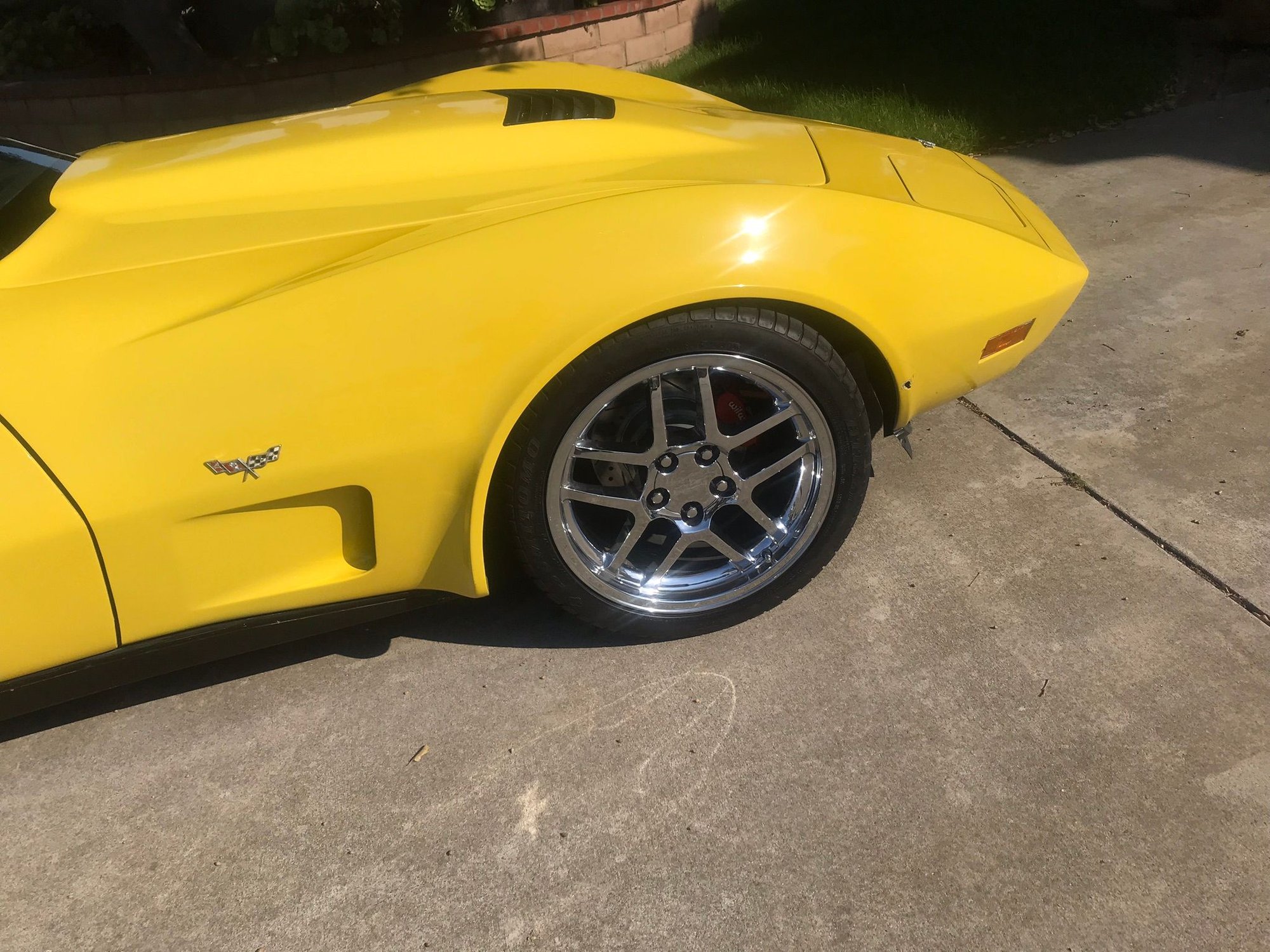

I cut a hole into my brand new hood! It’s ready for paint.

Old Jul 26, 2019 | 11:17 AM

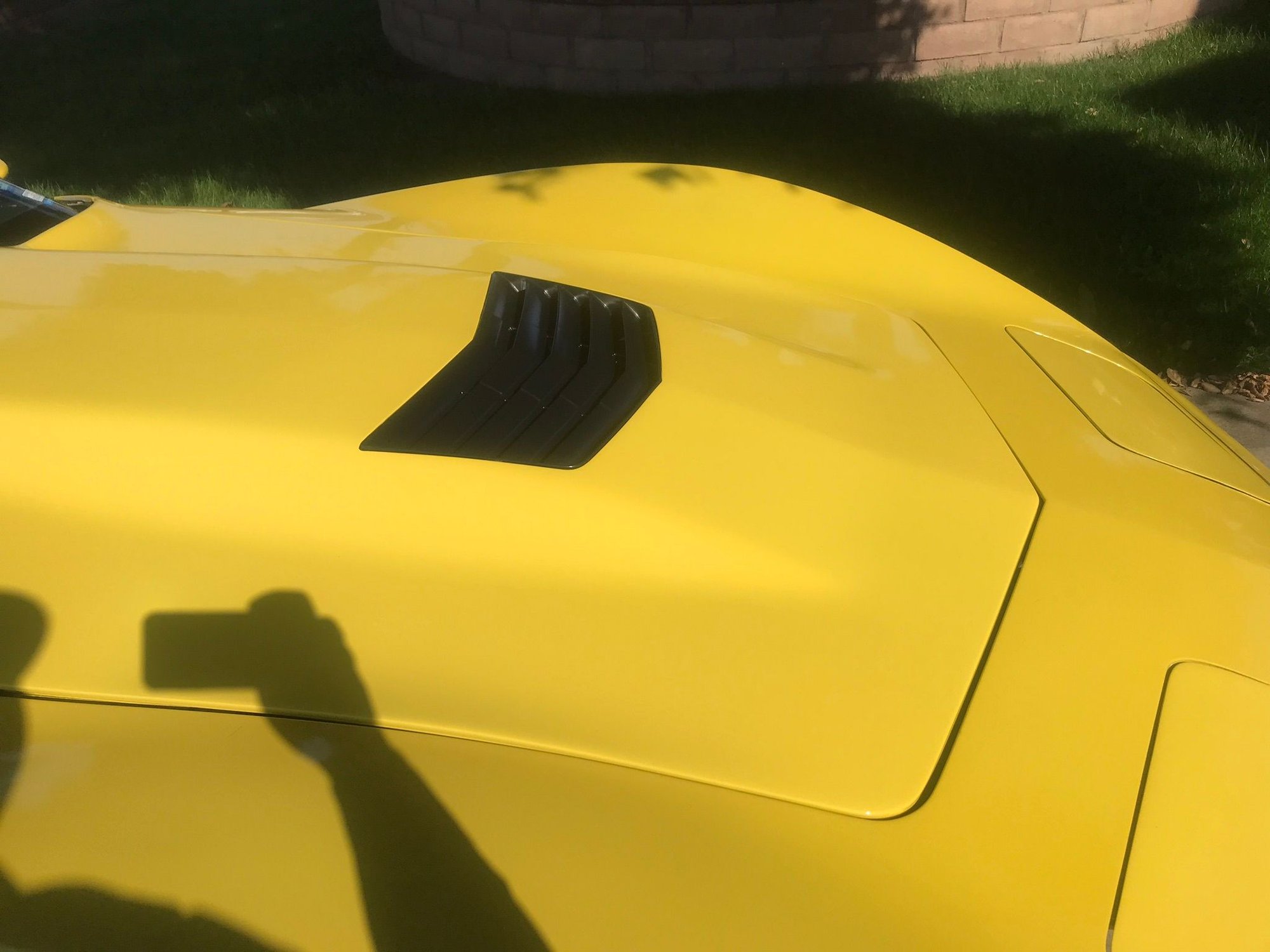

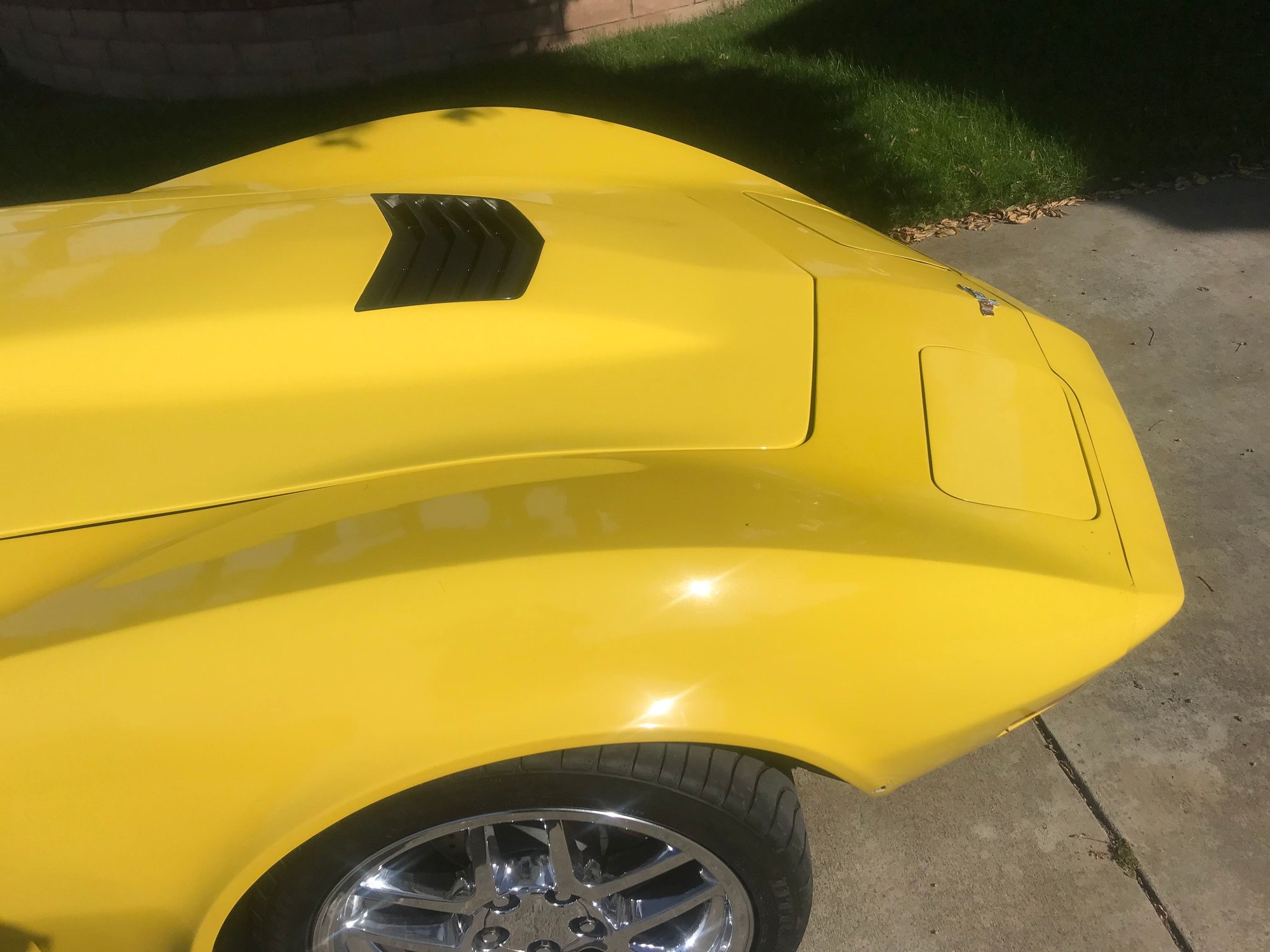

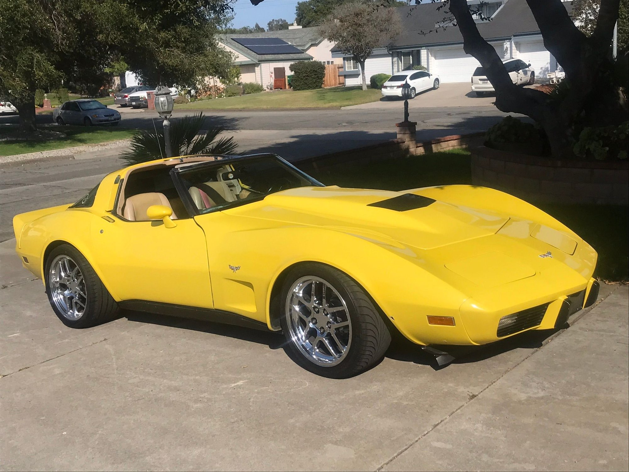

New hood is done. What do you think?

Looks good

There's beauty in function.

The new hood & vent look really good.
I think that if it were mine, I would paint the center of the hood flat black from the vent back to the back end of the hood, but that's just a personal preference.

From: Napa Valley California
That is exactly what I want for my 73.
Looks awesome.
Thanks for sharing.
Are you going to have the car out for the Santa Maria auto-x on the 10th?
-Chris
That would look sharp.
