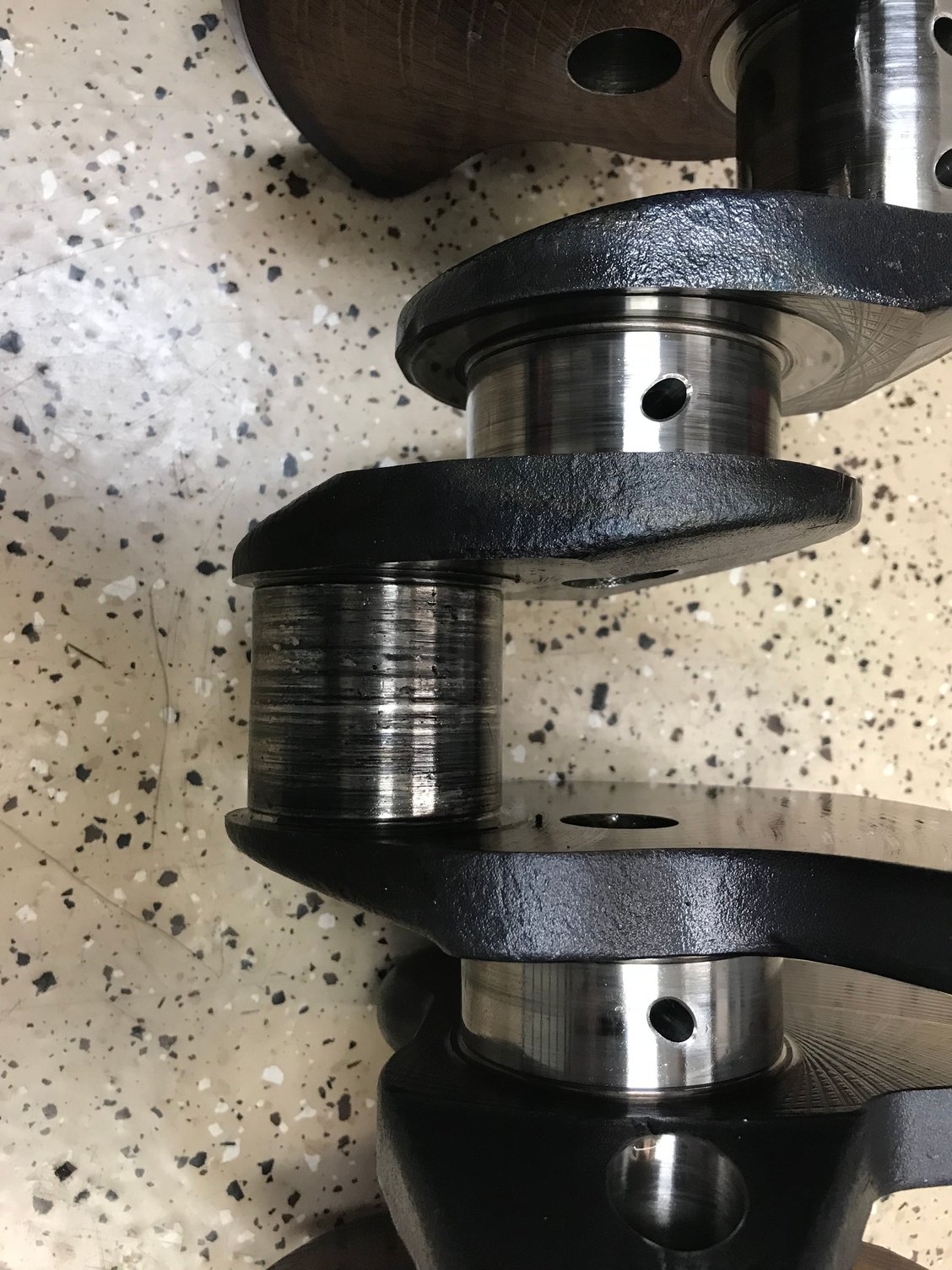

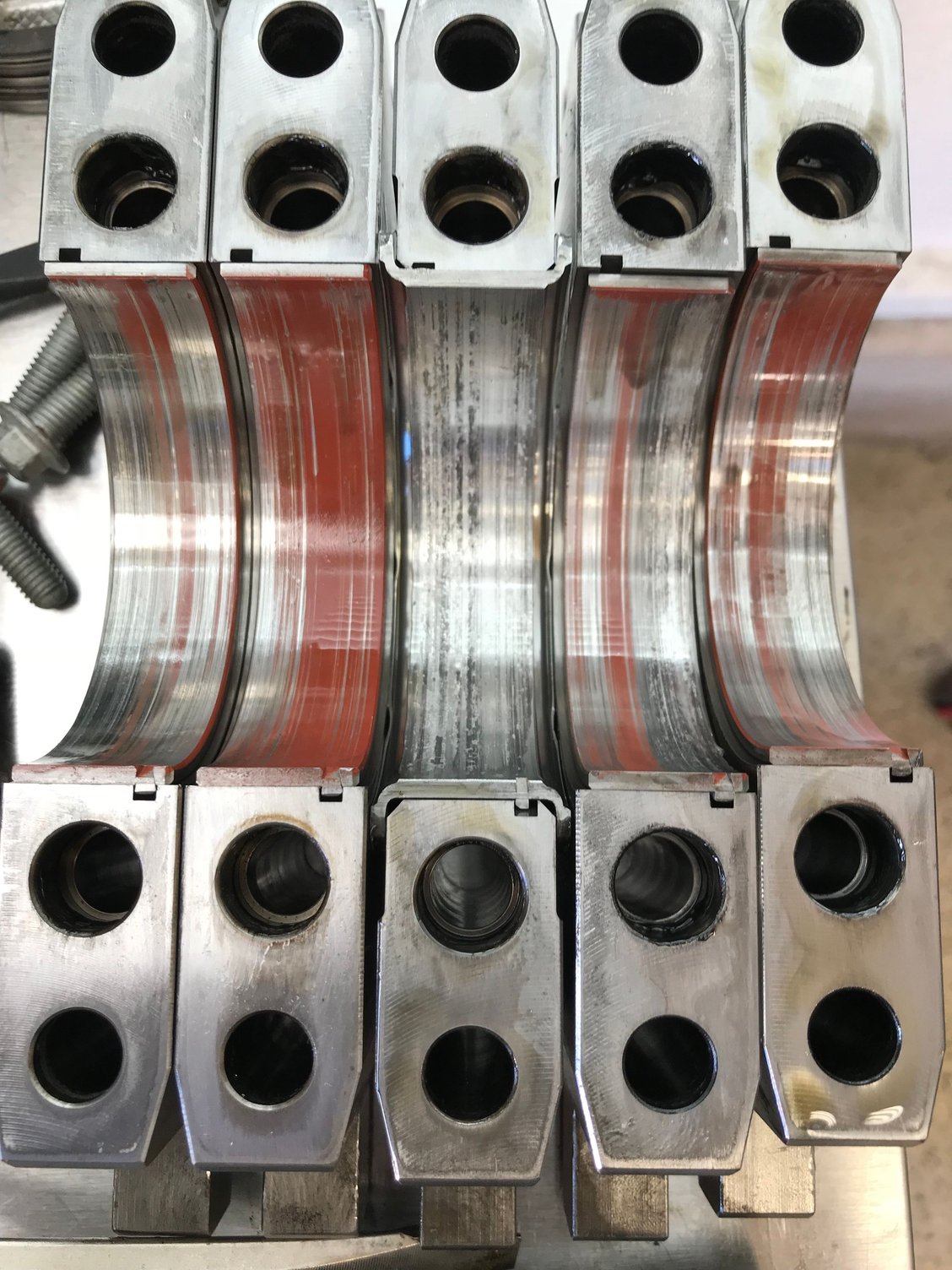

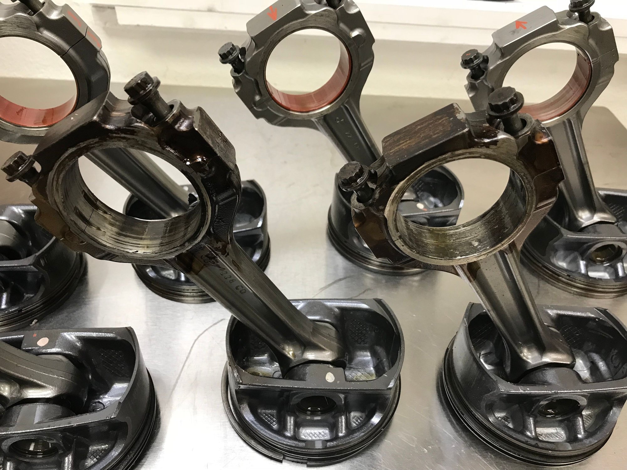

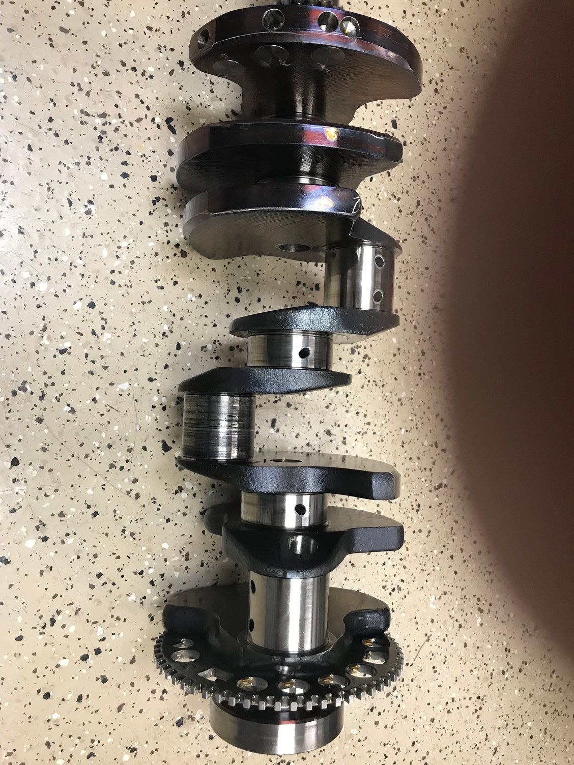

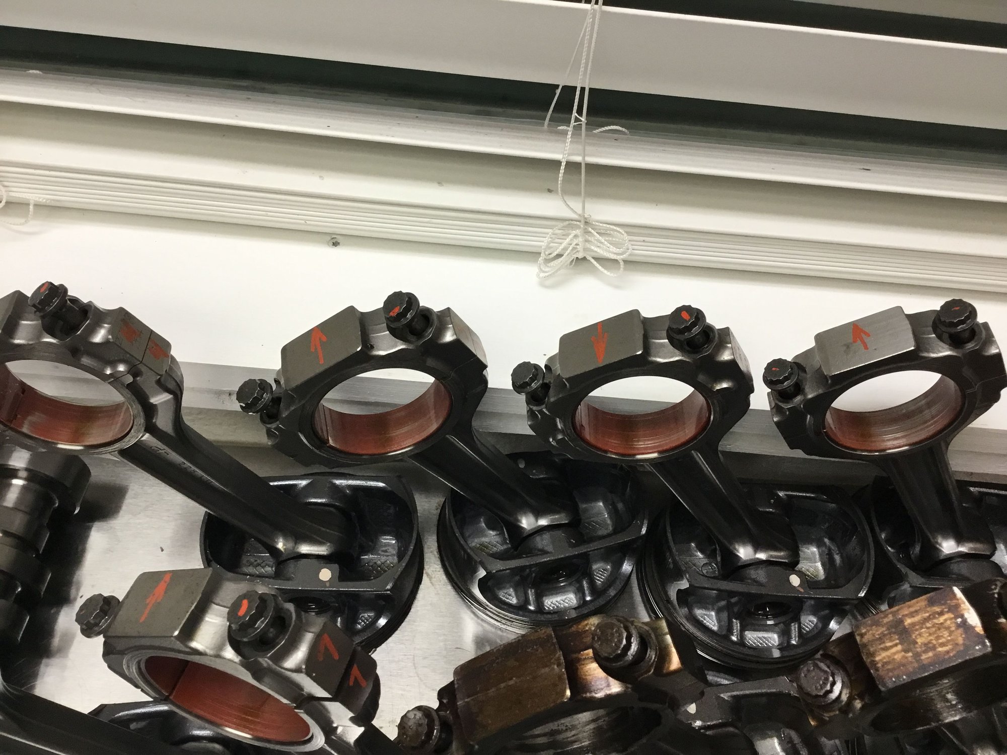

I finished the tear down today. Like I said, the LS engine is different. The engine is tight, even after 7000 miles. It was very difficult to rotate the engine with pistons, rods, and Cam. But after removing the pistons, rods, and camshaft, it still took 60 lb ft to rotate the crank. There are six bolts for every main cap! Take a look at the rod bearings and the crank main bearings. It doesn’t look like the other rod bearings were going to last long. The middle main cap has a larger bearing like what is usually in the back of a gen 1 small block. Is the thrust bearing in the middle of the block?!!!! The two rods that discolored don’t look bad! Can they be reconditioned? The crank looks great except where the rod bearings spun. My next step is to see if the crank can be saved and repaired, and the same for the two rods. Then I’ll have the block lightly honed and cleaned. Look at the tiny rod bolts.

Those should be titanium rods. You might find that the dark color is baked-on oil and it comes off when they're run through a blast cabinet. Crank looks like it will take a turn, no big visible grooves cut into it.
Make sure you have that block line honed before it goes back together!
Good for you, being able to keep it. That's several thousand dollars worth of parts, even unassembled!

Just curious on what the root cause of this is. I don't spend much time over in the other forums or LS forums but is this common on the LS7 motors? what is the fix if this is an issue. That crank on the rod journals looks ugly. Hopefully it can clean up.

Gm changed the rod bearings in 2013 only on the LS7 and after that change, LS7 engines began to blow from spun bearings. 2013 only!!

Actually GM wanted to sell the 2013 427 Corvette Convertible in Europe, so only the 2013 LS7 has "lead free" rod bearings. These bearings are failing at a phenomenal rate, some say 25%. Of course mine failed one week after I purchased it, because I put my foot all the way into it. Fortunately, the car was still under the original warranty, and they put a new Z28 Camaro LS7 in with leaded bearings. I guess the cheap thing GM did was not to test these lead free bearings. They should do the right expensive thing and recall all 2013 LS7s and replace the rod bearings. I'm told its not if they will fail, but when they will fail.

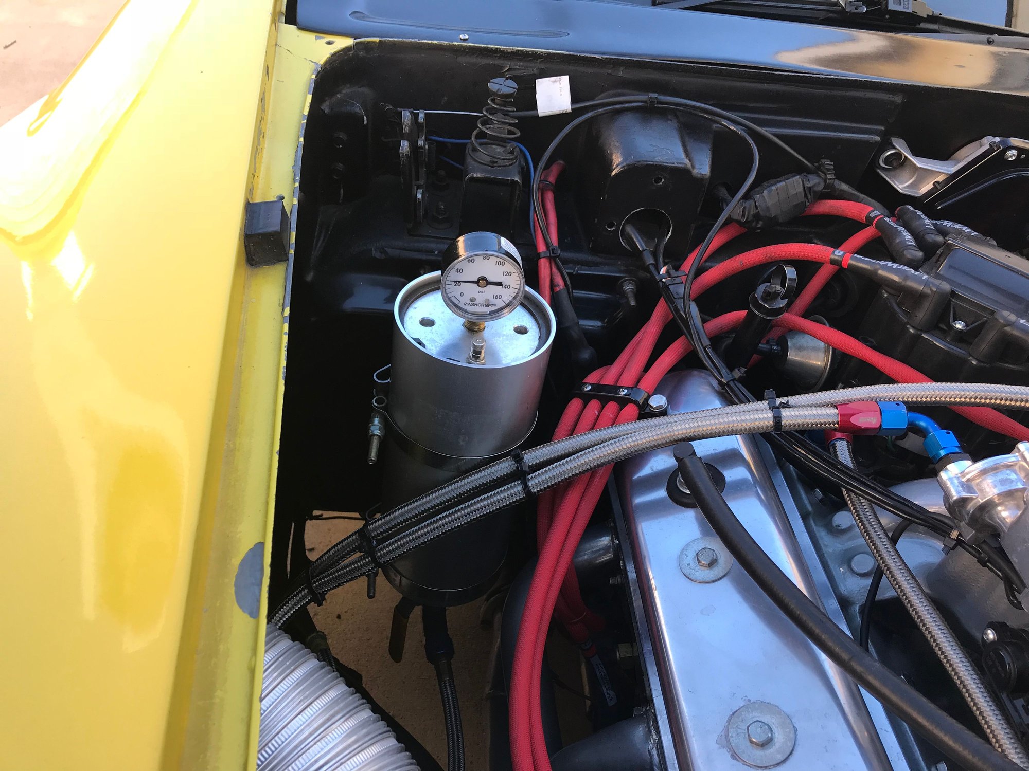

One tank and two lines is all I need. I’ll put the tank here, where my Accusump is now.
