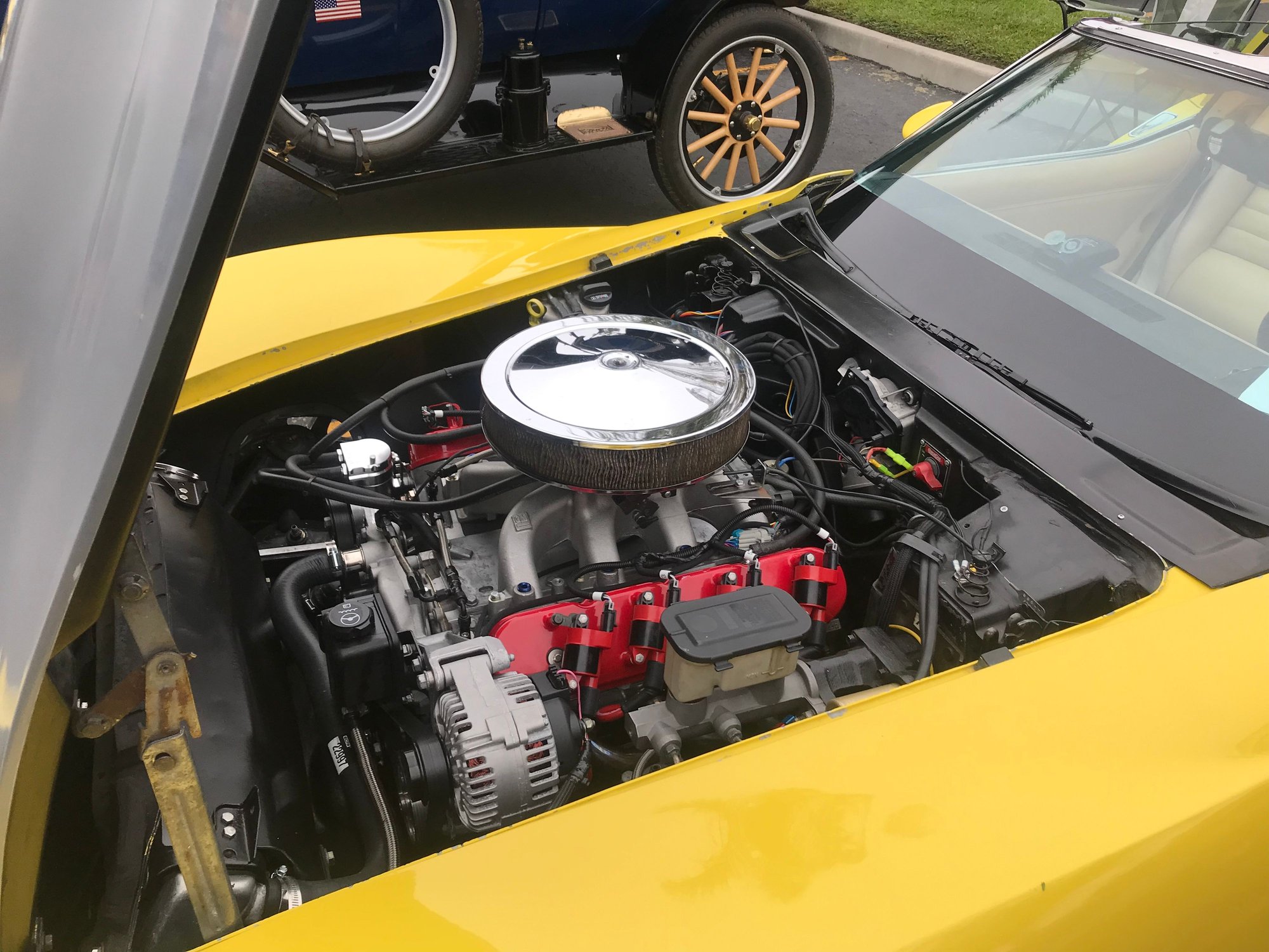

How much carb clearance does that hood give you? I need almost 6” from the drip rails to clear my supercharger but can’t find a reasonable option. Yours has the hump in the right spot though.
No clearance with a 3” air cleaner. I have a 2.5 element ordered. This hood gave me 3” additional clearance over the stock hood. The quality is excellent though.

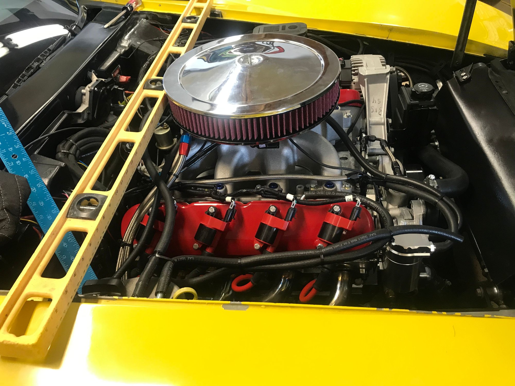

Thanks, any chance you can measure how tall the top of your air cleaner sits above the drip rails?

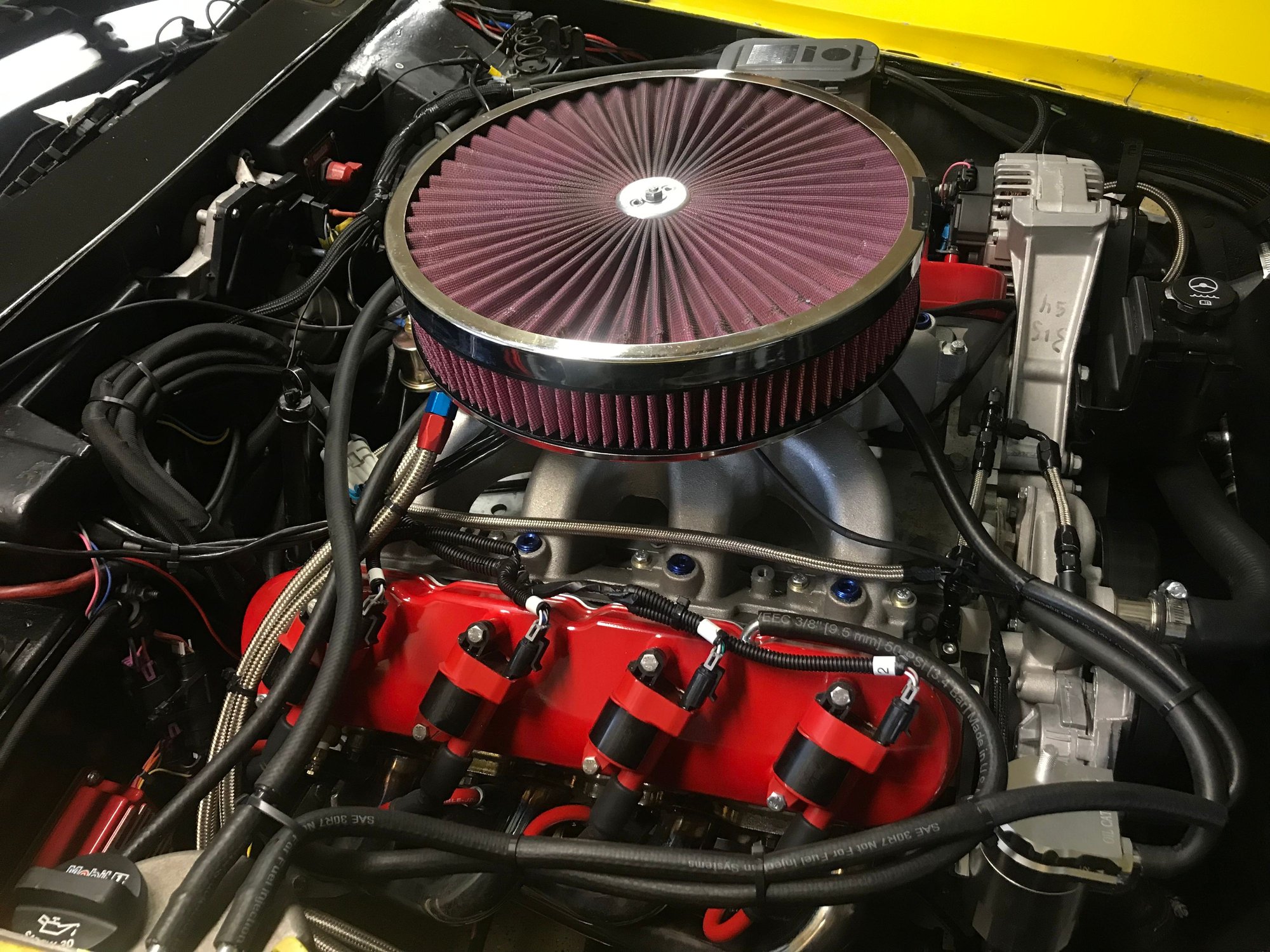

The front of my 3” air filter is 4” higher than the fender, the rear of the air filter 3” higher than the fender. It’s the most I could fit under the hood, but it rubbbed against the hood. So, I’m going with this 2 1/2” tall air cleaner. I hope 2.5” by 14” diameter flows enough for a 427 cubic inch engine.

I forgot I had one stashed. It’s from my Q jet days. The overall height is 3” again, but only the front of the air cleaner is rubbing against the hood. I put a strip of electrical tape to keep it quiet.
