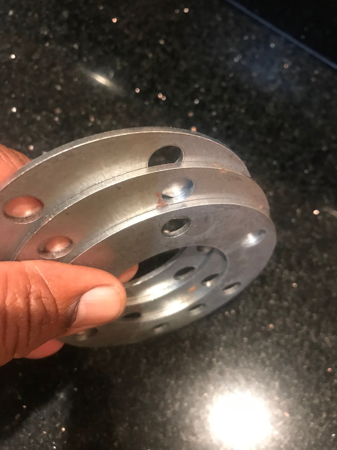

The shims showed up yesterday, so I assembled the engine tranny using two .090” shims. No binding, and the converter had to come out .120” to contact the flexplate. That is damn close to 1/8”. I also installed the starter and cranked until I saw 50 psi on the gauge. 50 psi at crank speed, damn good I think. I also installed the headers. I’m getting close to start. I need to install spark plugs and plug wires. Fill the fluids, hook up fuel and fuel pump relay, and crank. Maybe this weekend.

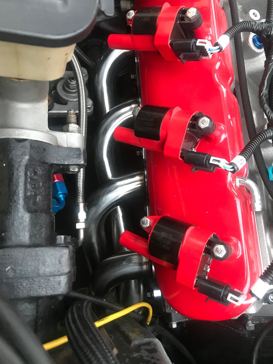

The car is back from the muffler shop. It’s not as loud as I expected. I guess the stick LS7 Cam is a lot milder than the LT4 Hit Cam I had in the 383. The LS7 does not like the 750 rpm idle, so I may increase it to 900-950. I drove it 10 miles to let the Sniper FI learn. I’m trying to behave and keep it under 4000 rpm and 50% idle for a few miles. Only one problem so far. This #%^** Mr Gasket adjustable thermostat housing is leaking. It leakes running and sitting. Maybe I installed wrong. Does anyone make a housing that points down instead of right?

I would see if the one housing bolt thats not visible is bottomed out and not clamping down on that side. I can see the bolt thats visible is a through hole but the other bolt may not be. That was a common problem with aftermarket water necks as the bolts didn't match the waterneck thickness and would hit bottom causing many owners to over-torque and strip out the bolt hole threads. I never liked the O-ringed swivel water necks until we figured this out. Now that's all I use.

Dang it, Cardo, now I owe you a beer. The bottom bolt was 1/8” too long and was bottoming out on the engine block.
