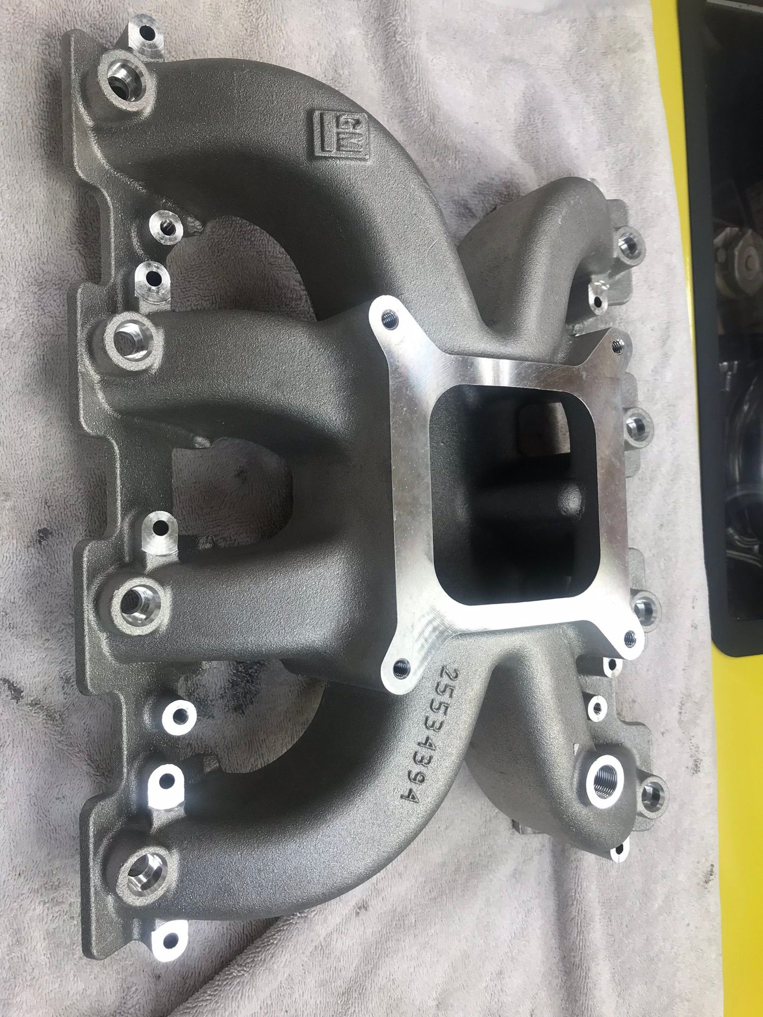

Some things to consider. Might be easier to get a carb LS7 manifold, or run injectors and an air only throttle body. Are you keeping the GM dry sump? Or convert to a wet sump front cover- GM sells one that has a provision for a distributor and a Dailey oil pan and pump. Big $$$ but light years ahead of GM's damp sump. If you are keeping the stock LS& oil pan, add Improved Racing's windage tray and crank scraper. Stock tank? Add the Aviaid baffle or go with the better Peterson tank- 1/2 the price of GM's tank.
This is the GM LS7 carb intake. The Fi holes were an added bonus I guess. I’m hoping there is a freeze plug or plastic plug I can glue into place.

I scored an intake manifold off of eBay. GM 25534413. It’s about the same height as the RPM Airgap I’m running on the 383 now. I need to plug the fuel injection holes. Any ideas? I’m going to put my Holley Sniper Carb replacement FI on top of this.
I like the LS3 dual plane intakes. GMPP in the$500 range and Holley has one under $300. Don't know if they fit an LS7 though. Injector boses are cast in but not machined on the GMPP but nothing on the Holley intake. Just makes a statement for how important mid-range torque is for a street motor.

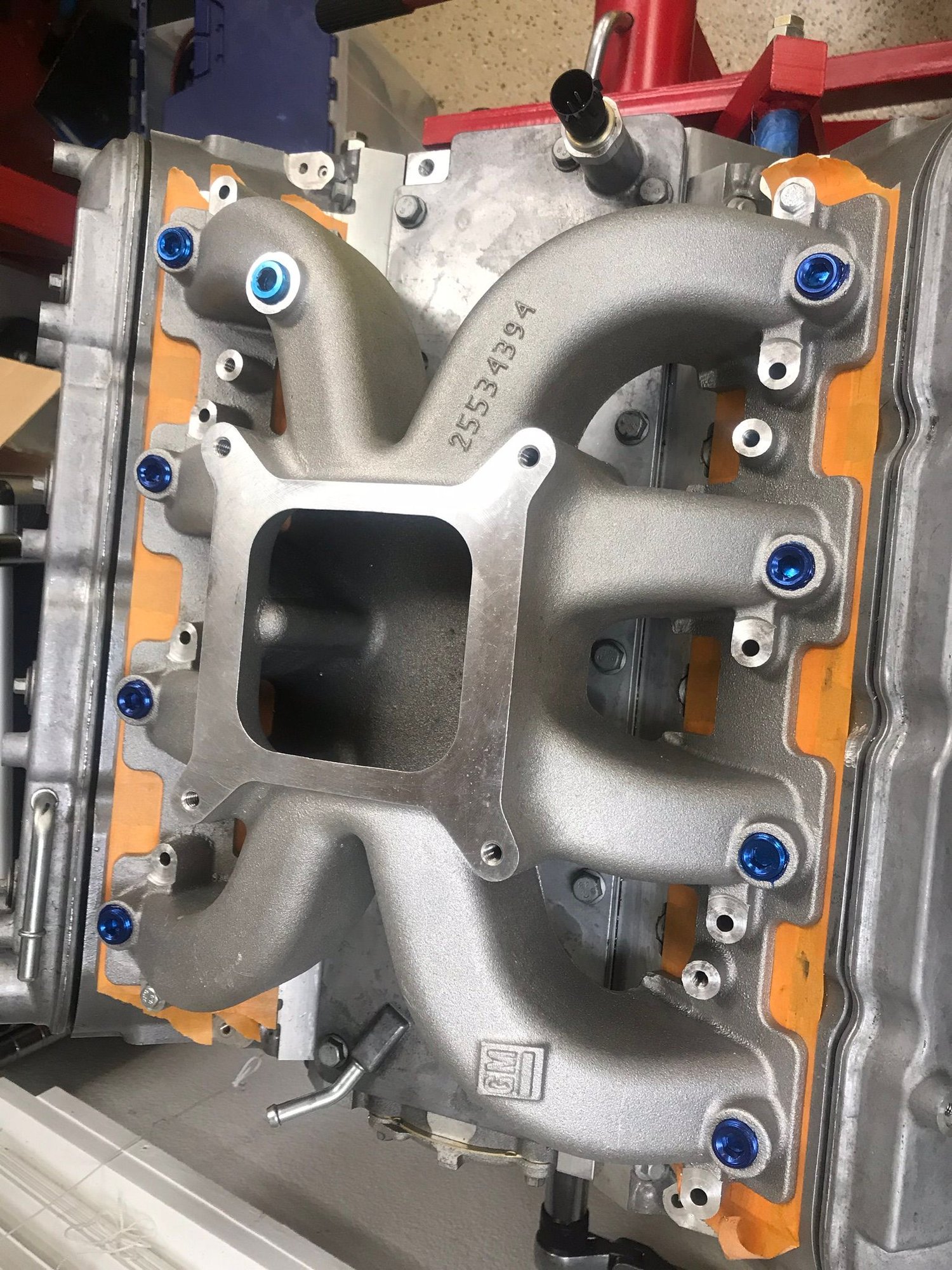

I taped each hole with a 3/8” npt tap. Then I torqued earls hex plugs into each injector hole @ 30 ft lbs with some gasket sealer.

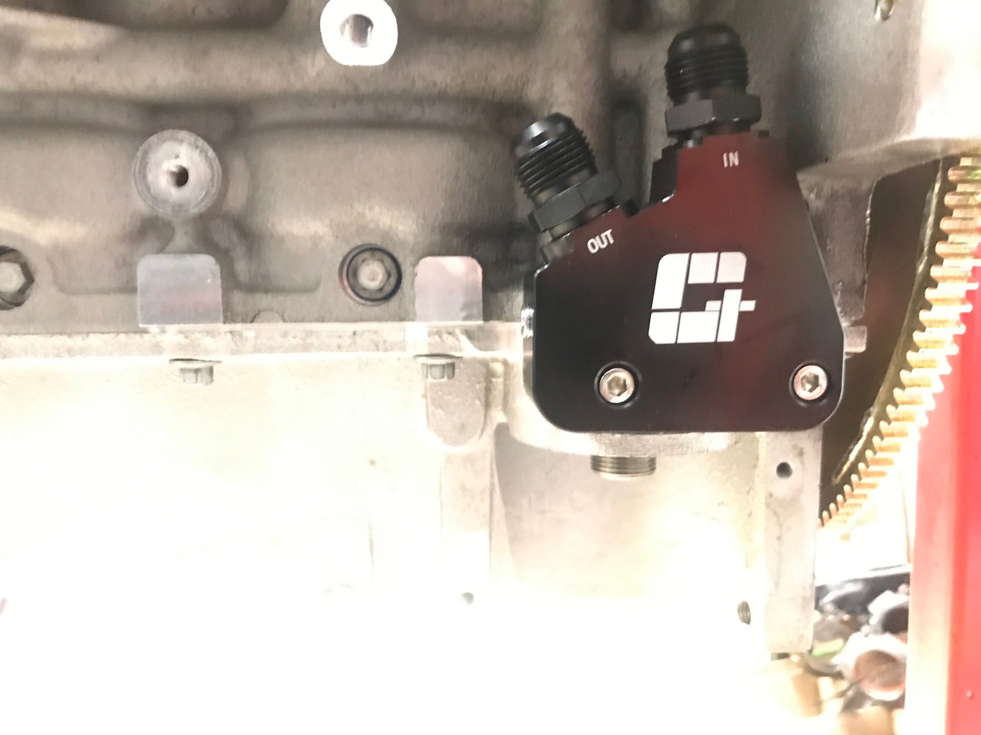

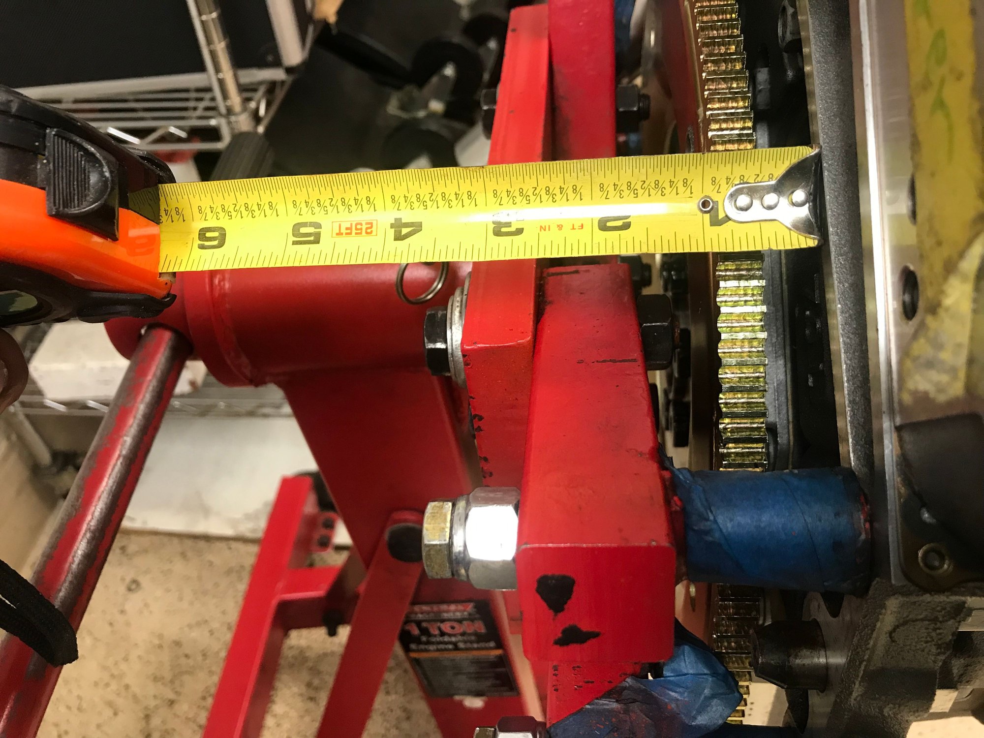

Making slow progress. The crank pulley is mounted, so is the modified flexplate. I bought and modified the water pump. Since I don’t run a heater, I tapped and plugged the heater outlets. I found this really cool oil cooler outlet. I also mounted the LSX motor mounts. I also installed the Trick Flo steam vent lines. The back holes are plugged and need opening.
Oil cooler adapter.
Flexplate redrilled for my 700R4.
The back of the flexplate is about 1” from the trans mount surface.
LS7 pulley and water pump mounted.
Water pump heater hose mod.
LSX motor mounts.
Next purchase, Corvette pulleys, tensioner, idler,and alternator and power steering.

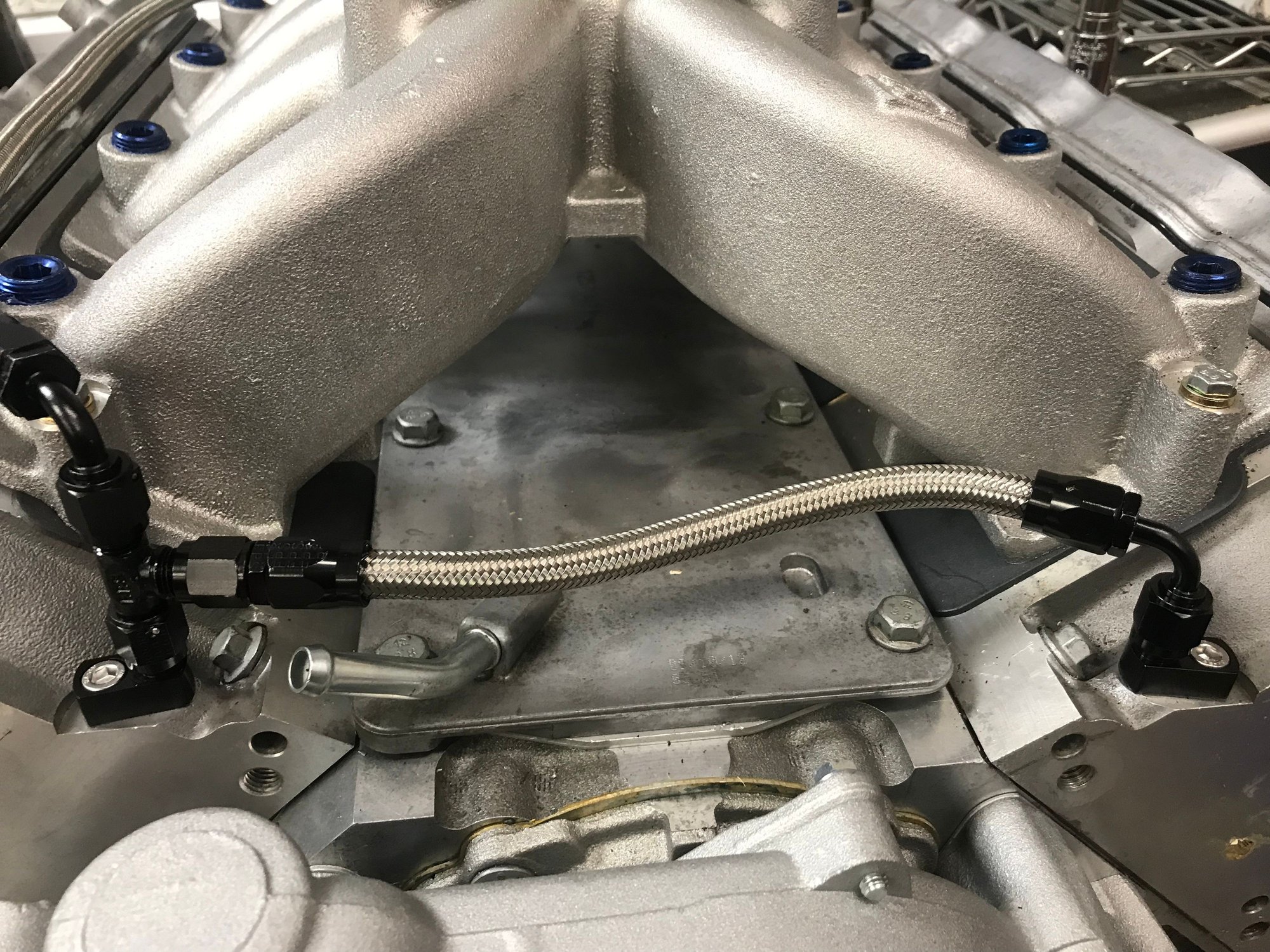

Trick flow Steam vent lines. I think I’ll connect to top of water pump.

Just FYI. I have a 2013 L92 on my engine cart with a stock LS flex plate bolted on and it measures the same as your pic. So your starter should line up. Can I ask why a 700R instead of a built 4L60E or 4L80E?
That is what is behind my 383 sbc now. A built 700R4 with a custom built 2500 stall lock up converter.
