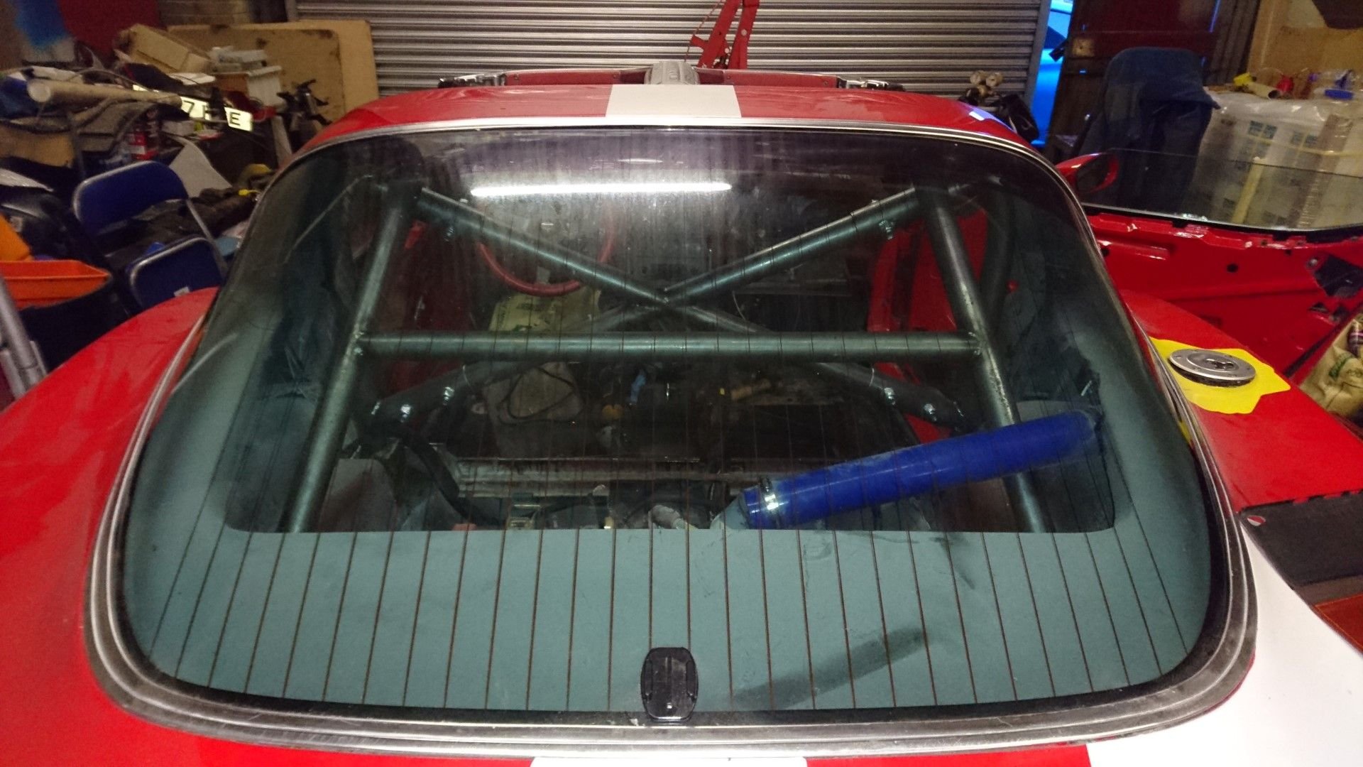

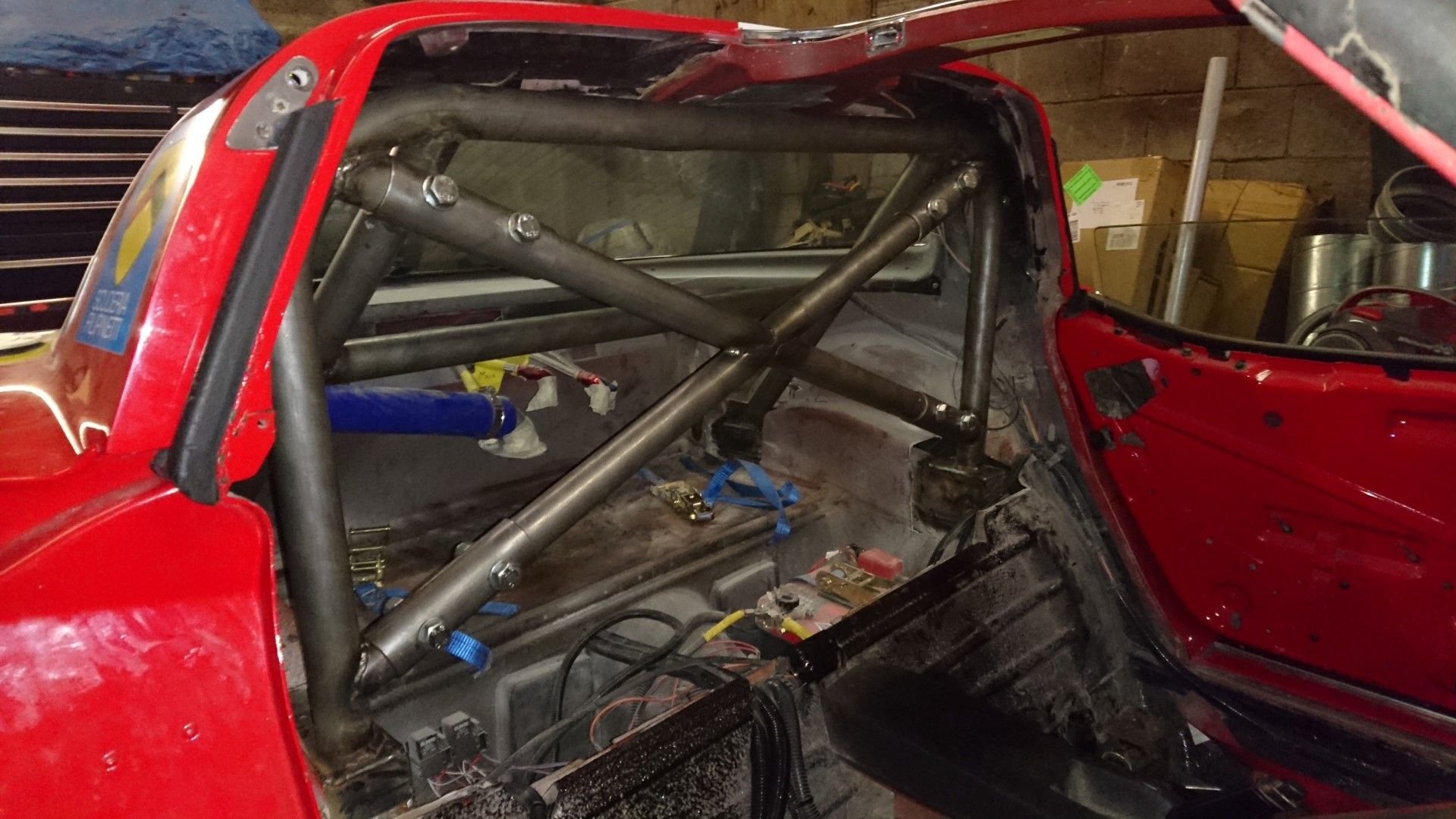

hey guys, thanks for all your inputs
ok sounds like its not going to gain much in gusseting body to cage
heres a pic of progress so far, not lifting body off, just making bigger holes to allow welder in and can get access from wheel area
now need to start moving forwards with tubes
the whole seating thing is a worry, didnt know you can buy seats that bolt directly to the floor, does it end up putting you too low down and you struggle to see over the dash?
Old Feb 12, 2018 | 12:44 PM
corvettedave383's Avatar
corvettedave383
Joined: Apr 2008
Posts: 825
Likes: 40
From: Glasgow, Scotland
also another question
in the rear end there is like a crash bar thing attached to the frame, does that help with the torsional rigidity of the frame?
also same in the front you have a bull bar thing right up front, again does that help with torsional rigidity?
and theres the vac tube, does that help?, or could that be cut off and then some nice strong rollcage tube to replace it?
trying to reduce weight and also improve torsional rigidity of the frame, the full rollcage should have a huge impact on
this area
thoughts anyone?
