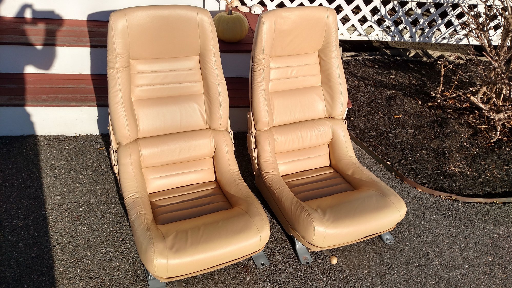

I just did this in November 2017 ^^^^^. I did not use a screwdriver, just my hands but very difficult to install solo. Have a helper hold the cushion in place while you are applying hand pressure to the areas where the connections need to go and they will install moderately easily....
