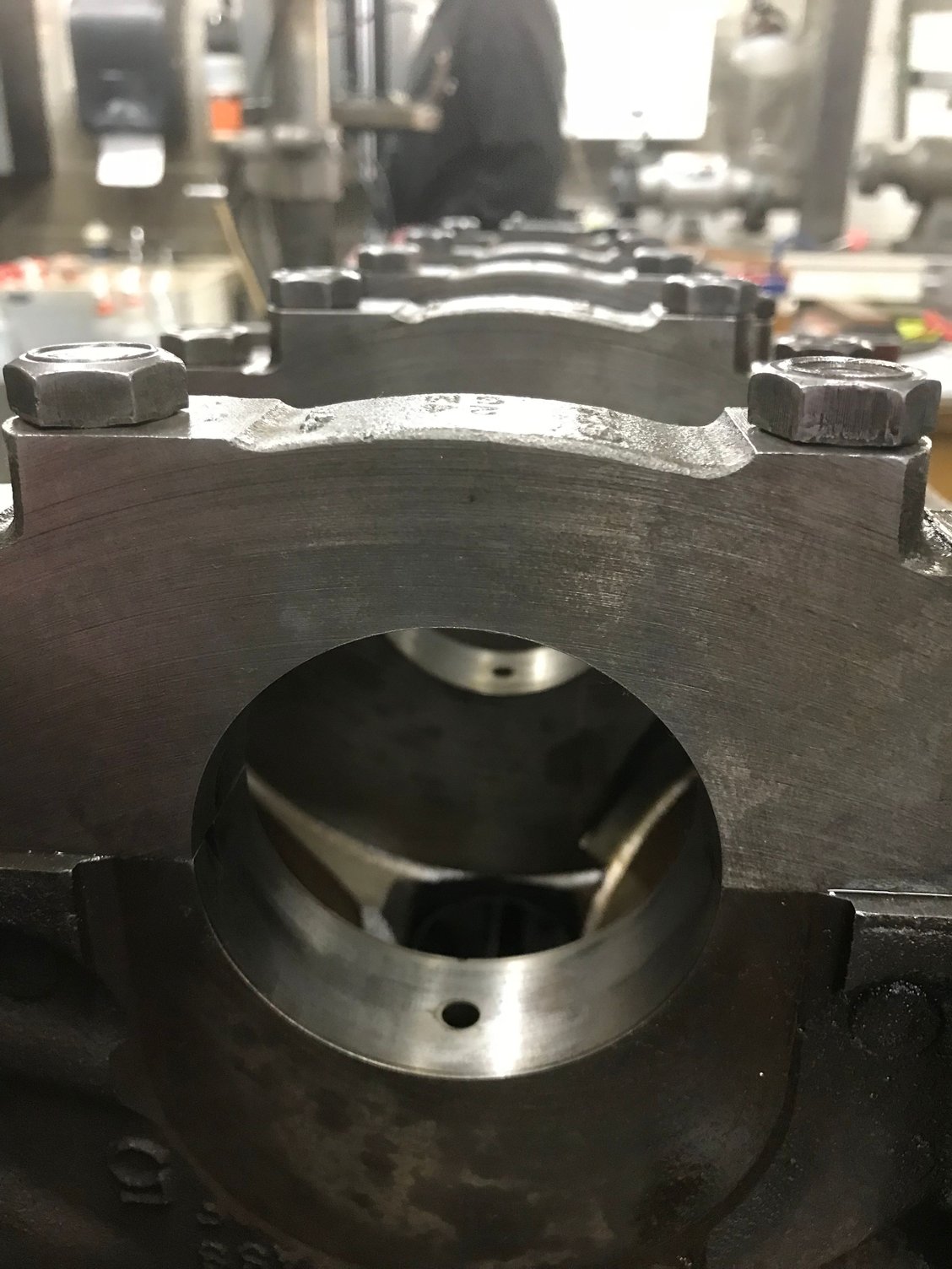

Well my 2 bolt is now a 4 bolt main. Next stop line hone. That was a fun project and fairly easy but my caps were almost a perfect fit so that helped tremendously. Before
all holes were drilled to .8950
Made a dead center on the lathe to use for drill placement. After I was centered I locked the table down and zeroed the readout just in case something shifted and we drilled and tapped and then unlocked the table and on to the next.
Used a center on the Bridgeport to keep tap aligned. Every hole was centered, drilled and tapped with the table locked down to keep everything as perfect as possible.
I got lucky with these caps.
All done.

How did the rear seal from cap to block line up, Sometimes that can be a PIA..............

you know I got extremely lucky with these caps, it was maybe .001 off . Again I couldn’t believe how snug these caps fit in the registers and how close all the bores lined up.

You are very lucky I seem to get all the horror shows to machine. Good job !!!!

Yer welcome. NOW , make sure you remove ALL the plugs in the block to get all the metal chips cleaned out. I even polish the insides to get all the casting flash , you won't believe the casting sand and crud trapped in the cavities. Ya can't get em too clean.
