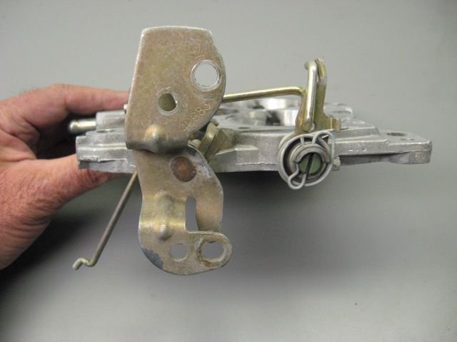

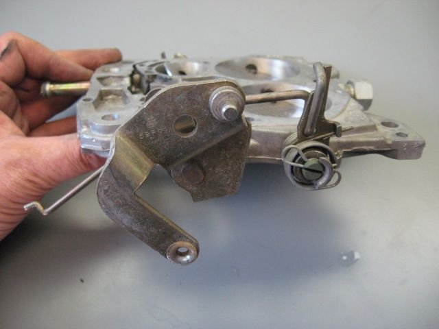

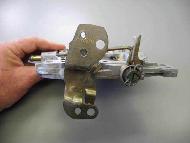

Auto trans carbs generally have a provision on the lower part of the throttle lever for a TH350 kickdown cable, which was attached to the throttle lever. Most Corvettes used the heavy duty TH400 tranny, which did not utilize a kickdown cable, so the lever configuration is irrelevant until you get into the mid/late '70s Vettes that had the TH350.
4MV carb for manual transmission. Same "cut off" throttle lever was used on the big block cars due to manifold clearance and the fact that all big block automatics were TH400's. Not all 4MV carbs for small blocks had the lever cut off for the MT applications:
Auto trans carb showing the lower part of the lever with the hole for the kickdown cable stud:
Manual trans 4MV carb for small block with lever intact:
M4M manual trans carb with cut lever:
M4M carb for automatic:
Lars
