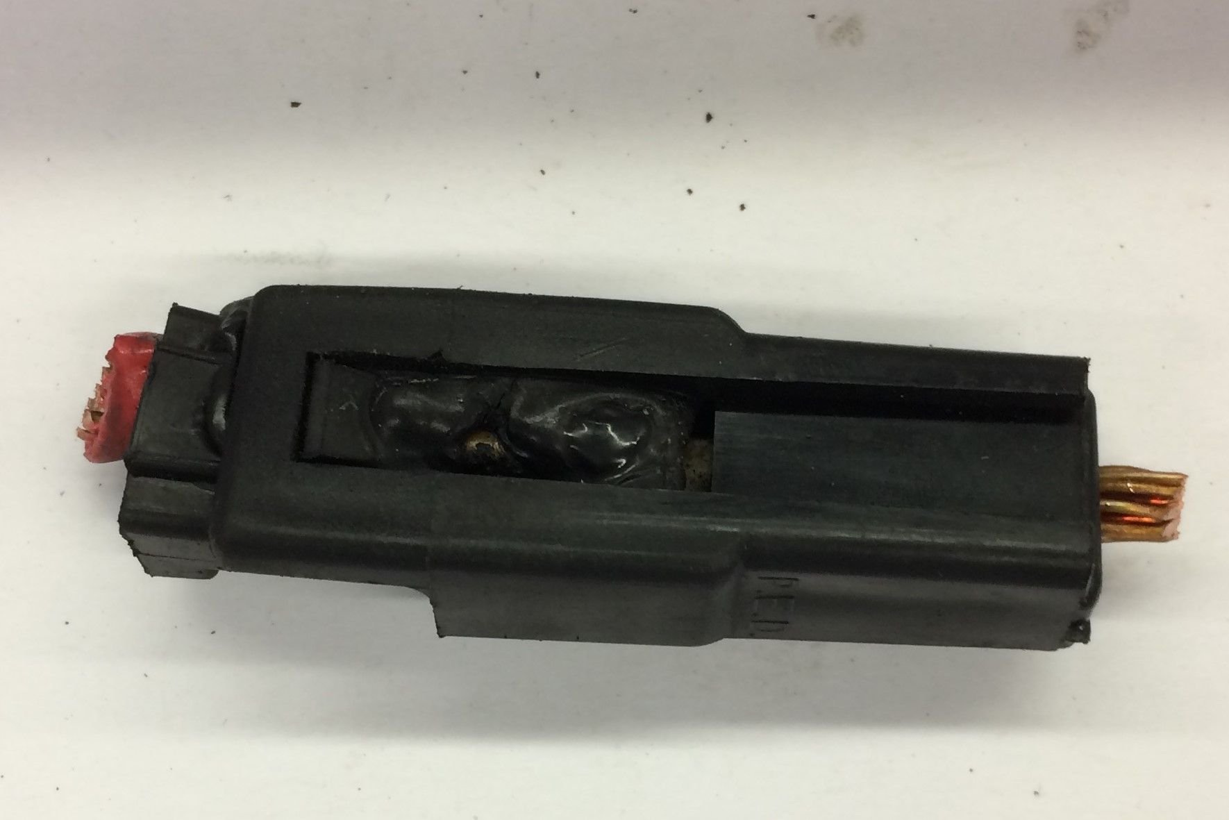

Thanks for the suggestions and tips! Turned out to be a burnt connector in a wire going from the starter to the alternator. Red wire, approx 8-10 ga. plastic connector located just behind the rear of the fuse block. Had voltage on the starter side, but nothing on the alternator side.
Not yet sure why it burnt/melted, but it didn't really look "fresh"; more like it's been happening over time (like 42 years!). Will be keeping an eye on it just in case!

Probably just a bad connection- HOWEVER-
And another thing to check would be the resistance to ground (Chassis) from the engine. A bad ground strap from the engine will also aggravate the problem you had.
Take you meter and measure the resistance from say the alternator case to a clean -bare metal surface on the chassis- should be well under 1Ω. Disclaimer- put the two leads together and see what the meter's own resistance is-subtract that from your total.
