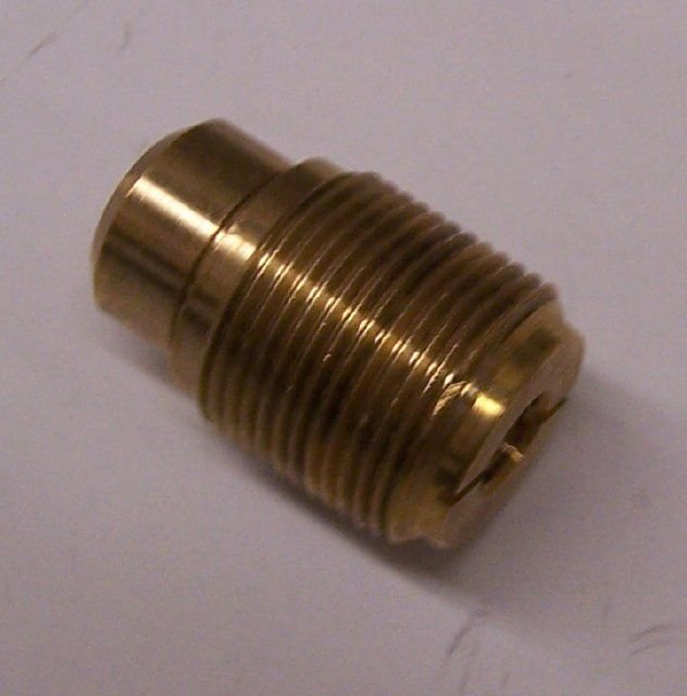

The cable does not need to extend beyond the cable, on either end. The end of the cable goes in the distributor brass coupling, and the fitting on the end of the casing screws over the outside of the coupling. When tightened down, the fitting should bottom out against the brass coupling. The cable actually goes in the end of the shaft of the tach side drive gear, not the coupling. The shaft of the side gear goes all the way through the coupling.
If the inner cable is extending beyond the casings fitting's on either end, then the cable is too far out of the casing.
Below is the brass coupling, the side gear and the coupling with the gear installed. If you look closely at the last picture, you can see the end of the gear's shaft, inside the coupling. That's as far as the cable needs to go into the coupling.

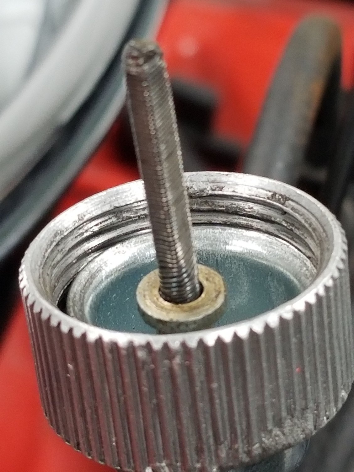

This is the cable inserted into the distributor with the housing removed. notice the brass ferrule. This limits cable movement between the distributor and the housing.

This is the position the cable would be in if installed fully into the dist. Sticks out quite a bit huh?

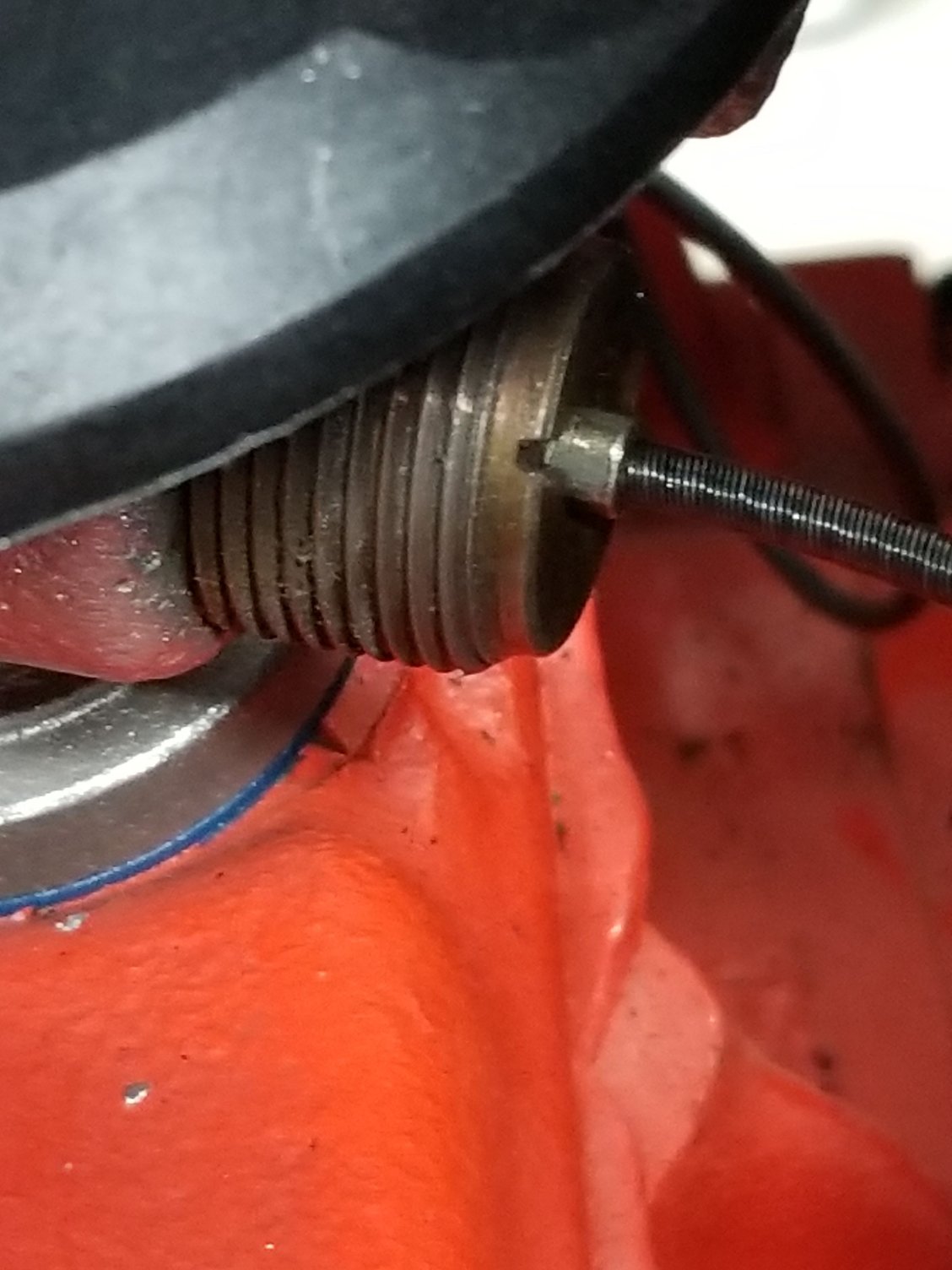

And this illustrates the position of the cable if it were pulled toward the tach. In other words that little brass ferrule is bottomed out on the cable housing.
