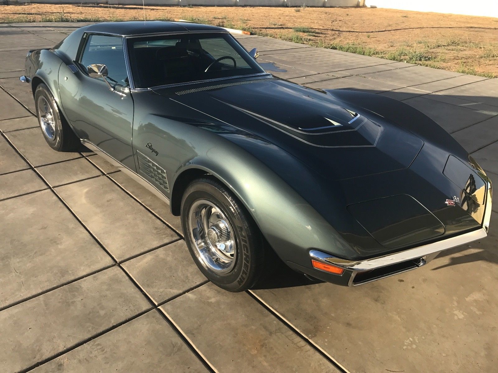

I have been crawling under the new to me car, and noticed it has some nice parts under here.
It seem to have been upgraded with poly bushings, a bigger front bar, a rear bar, and offset aftermarket trailing arms, along with other widgets.

I wanted a CA car, and since had to trust a lot in the photos.
I confirmed there was no rust in the A pillar mounts, and figured I could fix anything other than that.
What a beauty! Love that green!
Jebby
Old Mar 18, 2018 | 07:44 PM
Fredtoo's Avatar
Fredtoo
Joined: Jun 2014
Posts: 706
Likes: 294
From: New Jersey
Jebby
If what I am told is correct, it was resprayed Laguna Grey.
