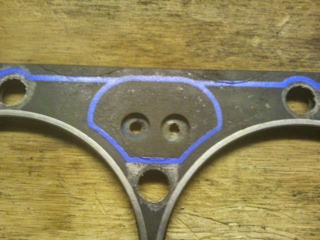

I had a similar situation with the coolant level. I could not figure it out. There was no steam or anything from the tail pipe.
I rented a combustion gas detection kit and bought a bottle of the blue fluid. You fill this thing with special blue fluid then put it in the radiator cap opening and run a line to a vacuum source. If it turns to a yellow color, you got a crack.
I sat their telling myself it wasnt yellow, it was green, maybe turquoise... The middle intake runners were coated in coolant and the center two exhaust valves on each aluminum head had cracks.
The lesson for me was to use the felpro gaskets with the larger coolant passages. Check out the difference below.
One that caused the crack on bottom. replacement on top
