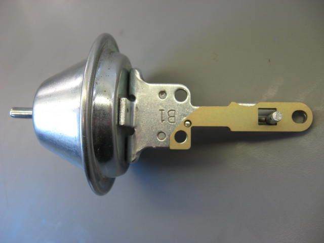

You need to set the mechanical max advance around 35 degrees and then see where the initial advance is. If the initial advance is less then 10 degrees at idle you could install a mechanical advance limit bushing to limit the advance. Between 10 to 15 degrees initial advance at idle combined with 35 degrees at full mechanical advance will give you near best performance. After this is done keep the vaccum advance disconnected and drive the car to see if it pings anymore? If pinging is gone you can then try the vacuum advance, and see what it does, if pinging is gone drive the car and enjoy. If pinging is still present with the vacuum advance hooked up then buy an adjustable advance canister and limit the vacuum advance until the pinging goes away.
If the engine still pinged with just the mechanical advance set 35 degree and no vacuum advance at all you need to check additional items. This could get long so first set the timing correcty and report back.
