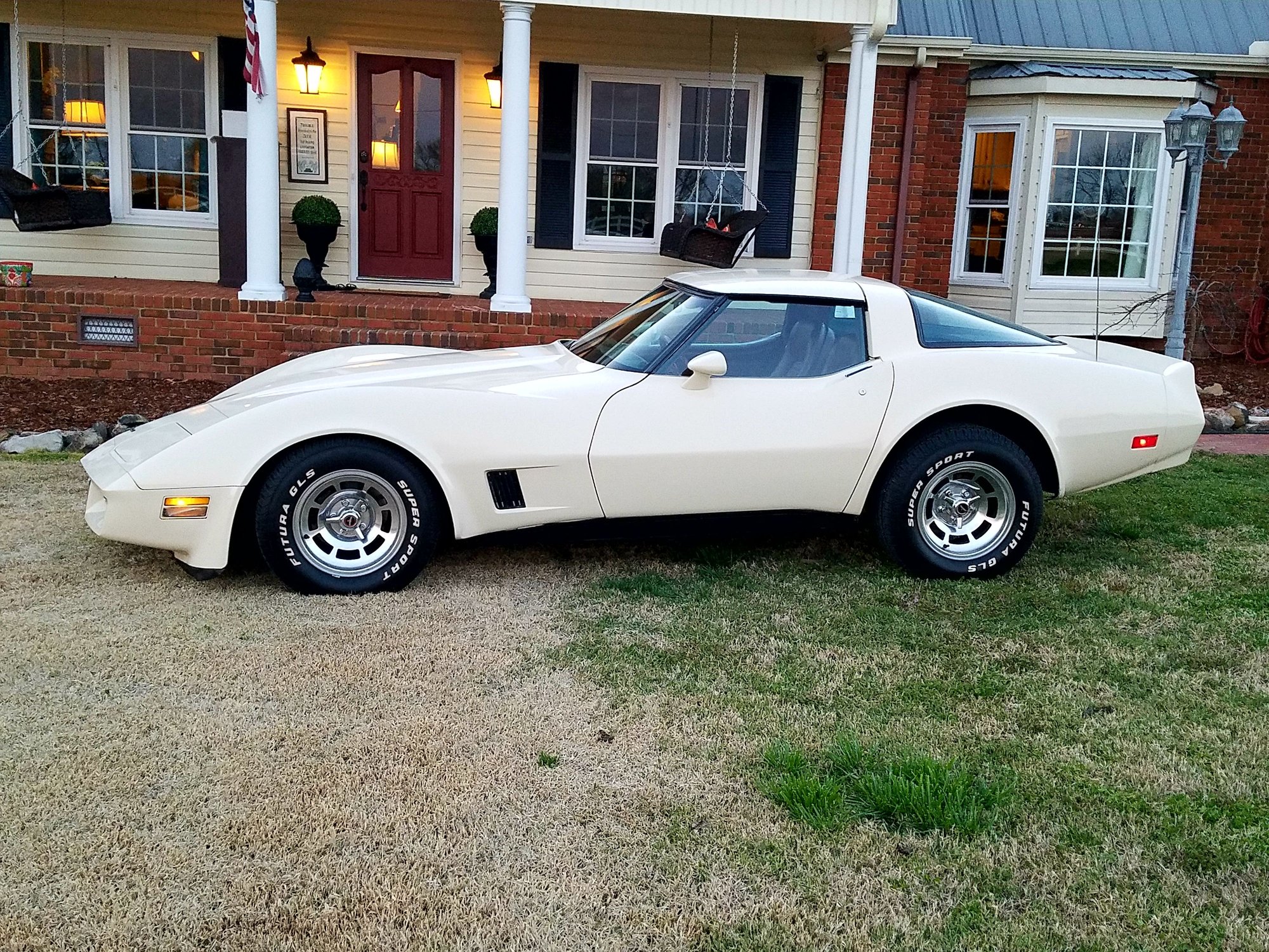

Hey guys.... brand new C3 owner. had 2 C4s but this is what I've always wanted.
So far so good with her, but it seems like the rear end is sitting high. Maybe I'm over thinking it, but it looks like to level it up it needs to be lowered 2 inches or so....
Any feedback would be appreciated! thanks! al

Front looks low and the rear looks high.
Old Mar 28, 2018 | 12:48 AM
7T1vette's Avatar
7T1vette
Posts: 37,637
Likes: 3,118
From: Crossville TN
Rear looks to be 2-3 inches higher than stock stance. That would take bolts for the rear of the T/A's about 1.5-2.0" longer than what it has now. It sounds counter-intuitive to lengthen the bolts to get the back end to go down, but the T/A geometry and pivot in front of the rear wheels makes it so. Depending on who made the rear spring, the ends of it may come pretty close to the inside of the rear tires. Be wary of that. If close, it could hit the sidewall of the tire and cut it when going through a deep turn.

Something is causing the rear of the car to sit so much higher than in the front.
I agree that you should measure the ride height at the center-line of the front and rear wheel arches.
This information will be an indication of how 'low' the front may be, and how 'high' the rear might be.
The size of the tires on the car will affect that height so you need to check that too. The original tires for your car were (I believe) either 225/70/15 or 255/60/15.
When you know all that you'll begin to have a idea what to look at at both the front and rear suspensions that maybe causing what you're seeing.

Something is wrong.
Notice the angle of the half shafts in your photo?
They should be level with the ground when the weight of the car is on the suspension.
My vote is that the rear spring has been replaced with an aftermarket.
I don't remember the brand but there is at least one out on the market that tends to do this.
Fix the rear and measure the front.
You may find that the front suspension has been modified as well.
Good luck and let us know what you find.

Something odd looking with that spring, what's with all that rubber looking stuff in-between each spring? Never saw one like that, that is not stock. I don't think you can lower it that much with that amount of thread left on the bolt. I would do a very detailed inspection under the rear and front, looks like you may have a lot of things to do under there. Good luck and post results.
Old Mar 29, 2018 | 07:08 AM
derekderek's Avatar
derekderek
Posts: 13,082
Likes: 3,399
From: SW Florida.
That looks like a stock 6 and a 1/2 inch bolt. It's also new with new hardware. Get the 8" bolt nut should drop you down about an inch and a 1/2 right there. And that bolt has been run a 1/2 inch farther up the shaft and it should so this should get you about 2" lowering the rear right off the bat for about 30 bucks on eBay. Get the bolt kit with rubber instead of polyurethane bushings. Those poly bushings are too hard and don't squish. That's a little bit more height right there also.

The spring appears to be an aftermarket spring of some sort. The 'shipping band' is the FIRST clue.
What the 'load' specifications for the spring are will be part of what determines the cars ride height.
The plastic strips between each spring leaf are liners and are used on many steel leaf springs.
The liners look like they MAY be the wrong width for this spring. (Some springs are 2-1/2" wide and some are 2-1/4" wide.)

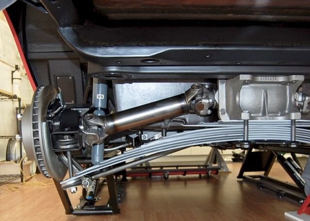

A typical spring and liners.
No weight on the suspension.
Typical 2-1/2" liners. Note how they fit.

1. To start with remove the cotter pin and lower the nut so it still fully engages the threads and a notch lines up with the hole in the bolt and reinsert the cotter pin.
2. Remove the shipping clamps.
3. Both these steps may not get you low enough but they are easy to do and cost nothing.
