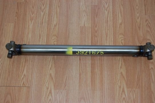

Hi D,
Yes, they're the originals.
They were cleaned.
The pitted surface on the tubes removed. (They weren't too deep.)
The 'heat zone' of the original weld on the tube and flange restored.
Protected with Pre-Lube 6.
Regards,
Alan

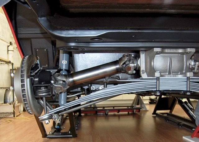

The low mileage 63 swc we did a few years ago is pictured below. Just like Alan, we re-tubed the shafts. The only issue is if you do this they will rust. So you have two choices, paint them with a cast color or grease them up and leave a fine film of grease on them (this is what we did). While there has been a huge discussion about what is correct, GM splash coated the shafts with black undercoat... it didn't keep all the shafts from rusting (we have pictures of the original on this car). But if you are NCRS'ing the car then a bare coat would probably go further than one coated with undercoating.. that would be up to the judges. Personally, I think 1/2 the shafts should have the undercoating and the other half would have been bare.. And this is based solely on original samples we have here and the year of the car.
Also, you can tell in the picture below that the tubes have been replaced on this suspension... why... because the welds are more protrusive than the originals.
[/img]
You can see the original undercoating on these shafts after they were lightly cleaned.
http://repairs.willcoxcorvette.com/1...e-drive-shaft/

Alan,
How did you get the 1/2 shaft to look like it has a new steel tube? I like.
