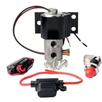

Conversation got me to thinking...what other options do you have?
We overlooked a rather simple one; The line lock.
The C3 I'm pretty sure has a simple two channel brake system. One feed to the front and one feed to the rear. Far easier to work with than today's four channel systems for this.
Fit this in line to the rear and you'll energize the entire rear system. *And lost no rear brake performance for driving needs.

Hmmm.... I'm liking that idea.... well, other than the "engergize" to activate part -

There are manual types also. The electronic models are used for staging purposes where they just hit the button to release it. You can find manual ones that you push down on the pedal and then push a valve down to prevent the pressure from flowing back.

I like that idea.
Whenever I put my car up on ramps I disconnect the battery and put an extension (wood, pipe, whatever) on the brake pedal to lock the wheels and avoid inadvertent "rolling".
