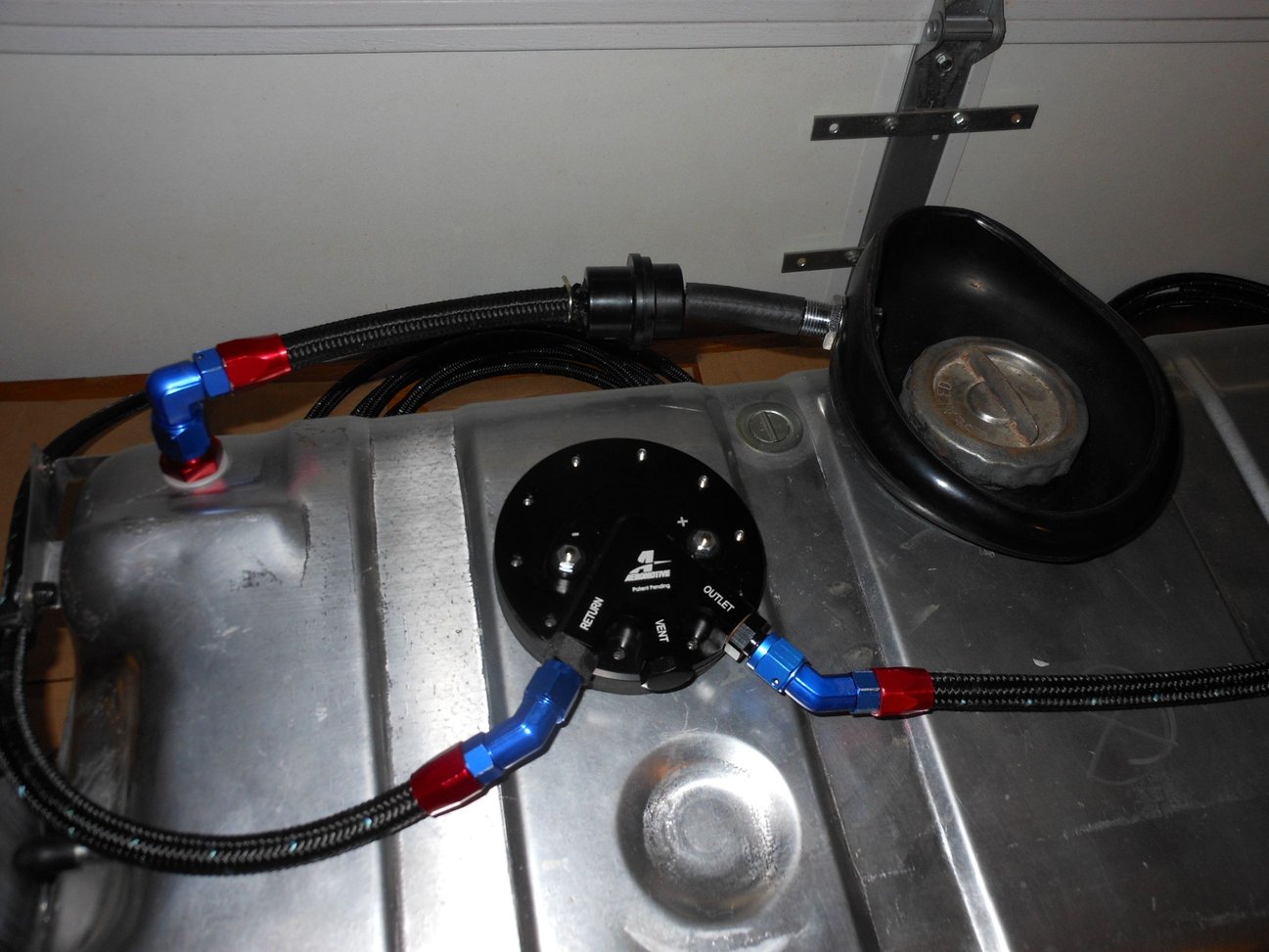

My 71 LS5 uses a sealed cap...
If the unfortunate ever happens- rolling over your car- I would not want a hole in the gas cap- just sayin...
Here's how I did my vent-
Rollover valve and a charcoal canister to knock the smell out-
Is that an inline charcoal filter? If so, do you have a P/N or any info on what it came from?
I'm interested in the p/n and manufacturer as well.
I plan to do something like this and was looking into charcoal canisters for ski boats that use something similar.
GM used it on the Power Brake Booster vacuum - as a filter to keep gas fumes out of it.
Dorman HELP! 80195 Power Brake Filter Gm
Amazon Amazon
https://www.summitracing.com/ga/part...0195/overview/
