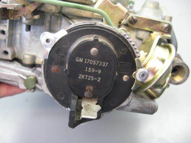

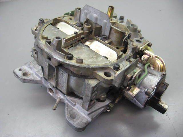

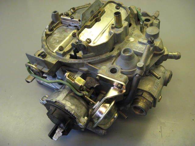

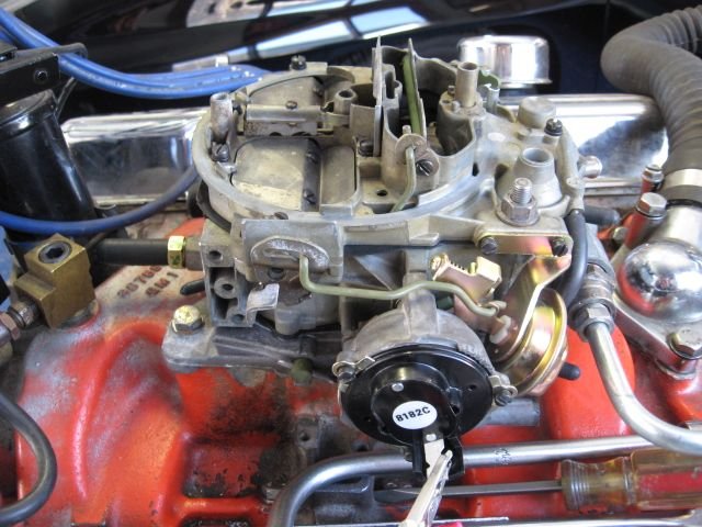

Just to add a little more info to this 1980 Q-Jet thread to those of you interested in the "correct" carb for the 1980 model year:
The 1980 carbs are visually identical to the 1976 - 1979 carbs, except they used an electric choke, replacing the hot air tube system used from 1975 - 1979. There are some differences in bowl vents (evaporative emissions), and there are differences in manual and auto trans carbs. The 1980 carbs were also leaned out a little at wide open throttle, so they need to be richened up a little if used on a modern performance application.
Here is a correct 1980 Q-Jet. This is a 7080228, which is an L82 High Performance 800 cfm carb:
Note the large nipple on the forward top edge of the float bowl for the charcoal canister:
This carb has provision on the throttle lever for TH350 auto trans kickdown cable and for the cruise control cable. Manual trans carbs have the lower part of the throttle lever cut off from the factory, and cannot be used with a TH350 auto trans without the kickdown cable attach point:
Note the choke housing is missing the hot air tube nipple, and the casting is not drilled for the nipple at all. When converting a hot air carb to electric, you need to cap off the hot air nipple to prevent the carb from drawing cold air into the housing - the cold air will delay or prevent full choke opening. It is also imperative that the gasket under the hot air choke cover be removed, since the electric choke grounds through the housing - if you install the gasket, the electric choke will not operate. Note the stock factory "L" shaped electrical connector - it requires the special mating "L" shaped plug on the wire harness. Aftermarket chokes are available with straight blade connectors:
Factory carbs had the cover attached with pop rivets so it could not be adjusted. When converting a hot air carb to electric using an aftermarket choke, it's a good idea to use screws so the choke duration can be adjusted and tailored to the application:

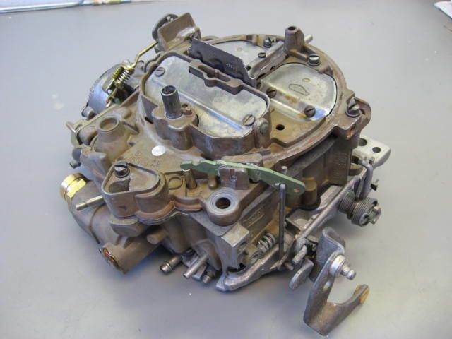

Rod (aka "rairh") has a "new" carb for his '80 on its way to him. Through the help of another Forum member Scott ("Cheeto"), we got our hands on a nice, original 1977 4-speed carb. The '77 manual tranny carb is not identical to a 1980 auto trans carb, so we had to make a few "conversions" to make things "right:"
Here is a 1977 Q-Jet. Note that the throttle lever for the manual tranny does not have the extension lever on the bottom for the TH350 kickdown cable, so the manual carbs cannot be used with a 350 automatic:
In this photo, you can see that the '77 does not have a bowl vent nipple in the float bowl for the charcoal canister evaporative system, and the choke housing has a nipple for the hot air tube system.. The rear of the airhorn also has a hot air tube nipple. The entire airhorn is a little different from the 1980 without provision for the bowl vent system:
Here is the carb after being converted into a "1980." The throttle lever has been changed to an automatic lever, including addition of the cruise control stud. The airhorn has been changed to the 1980 style airhorn, and the float bowl has been drilled and fitted with the bowl vent nipple. The choke housing has been modified to delete and plug the hot air tube system, and the correct electric choke with the "L" spade connector has been installed. This thing will run really nicely on the 1980. Compare this carb to the "real" 1980 carb shown in my previous post and you'd be hard pressed to tell the difference:
