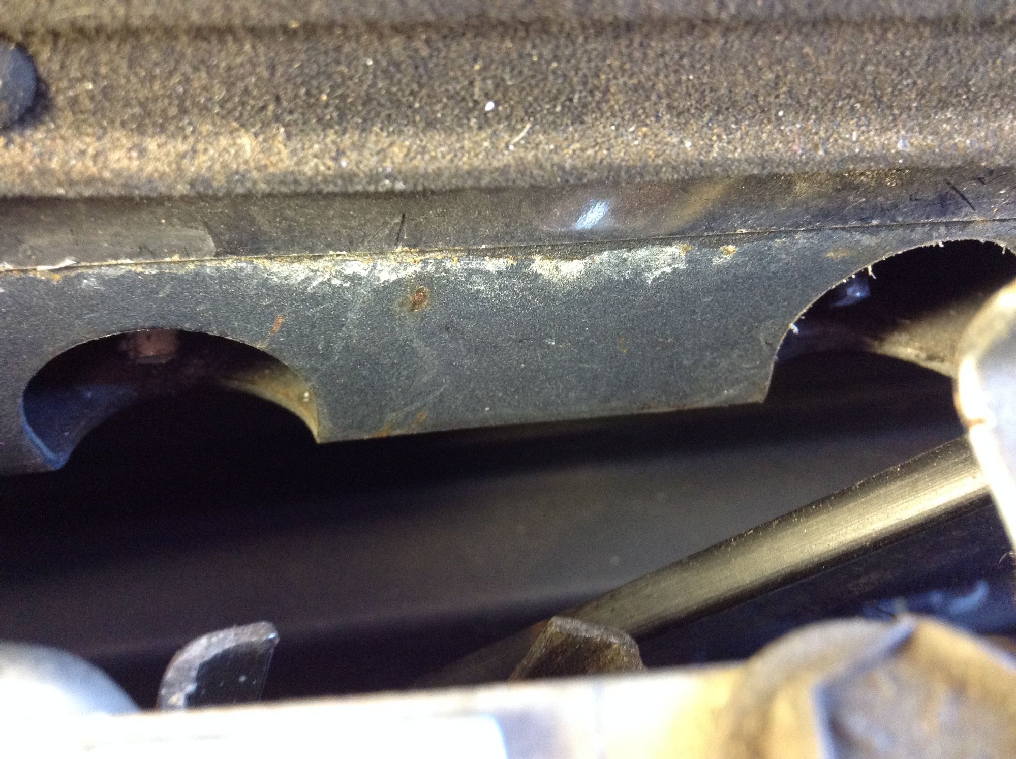

Need to replace broken sport mirror on my '77 but glass is in the way of reaching mirror nuts on inside of door. Can glass be loosened and moved out of the way or will it need to come out?

The door glass needs to come out...or at least I have never found way to allow the door glass to stay in the door and do this....and TRUST ME..I have tried.

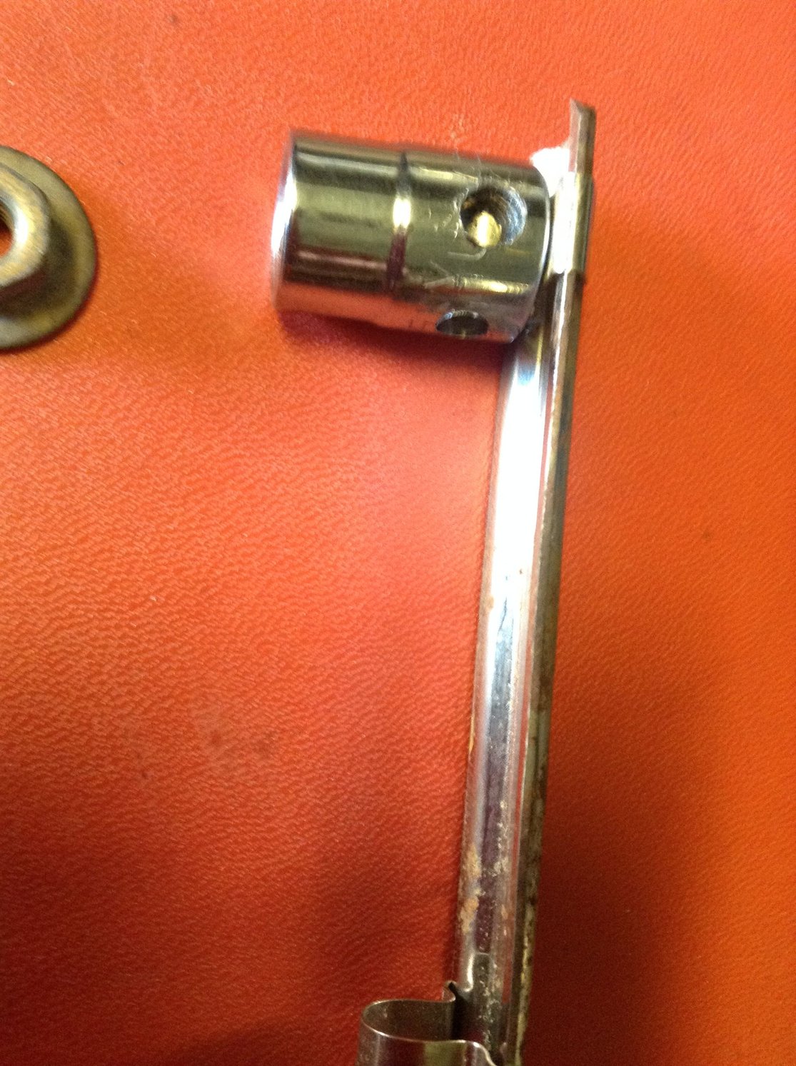

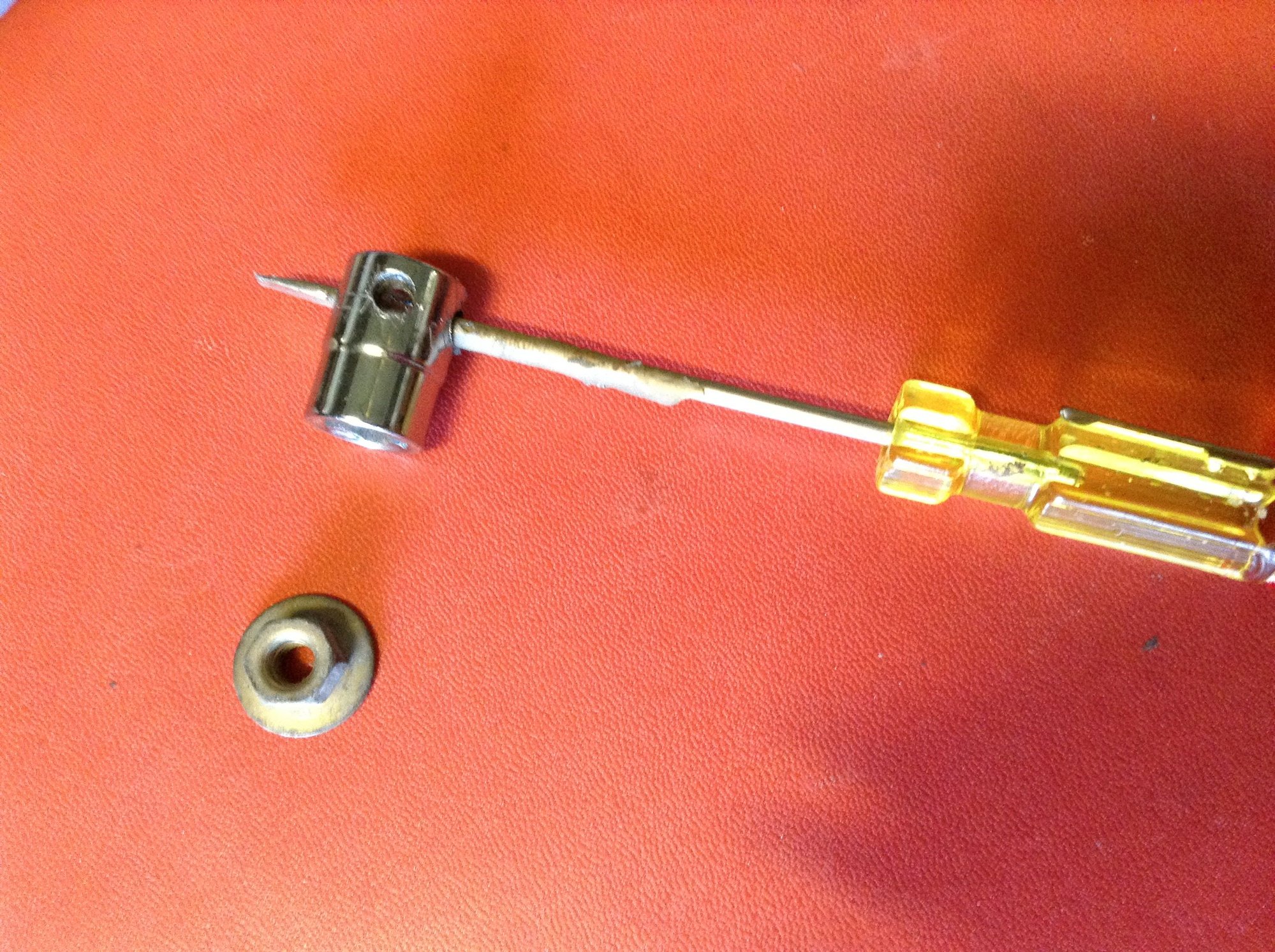

May have a solution, drilled holes in 7/16" socket (not easy, broke 3 bits and wore out 3 more), if that doesn't work see that socket holder may just fit between door and glass to tighten nut.

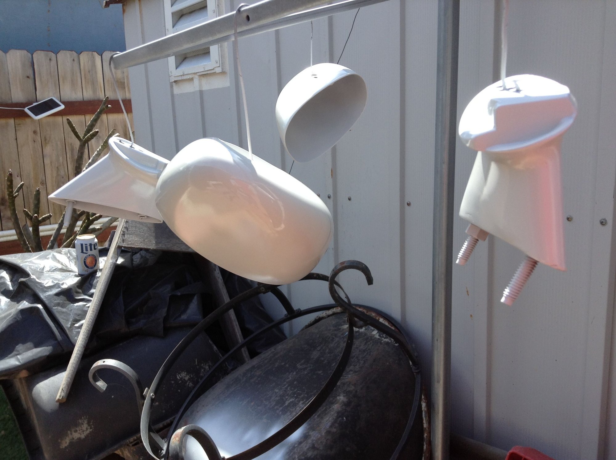

Mirror is now painted so tomorrow I'll try and get it back on car. I posted in General discussion about getting paint matched at Home Depot (local auto paint store couldn't match, don't have a paint scanner). Ended up buying a quart of Behr water based high gloss enamel that is perfect match and looks like it may work...at least for now. Painted mirror; most of driver's door; around where mirror mounts on passenger door; nose and other paint chips.
Topped off with clear so once entire car is buffed out should be good to go.

Just be careful. I see that you painted the threaded studs that hold the mirror on. That paint can act like threadlocker and cause your nut to seize up. I would clean that paint off an test the nuts FIRST before you got to put them on.
Also I would use a very small drop of removable threadlocker on the two screws that hold your mirrors pieces together. If you do not have that and want a second option...you can use RTV silicone. Just a as long as you have something that can prevent that screw from loosening....or you will doing this all over again in time.

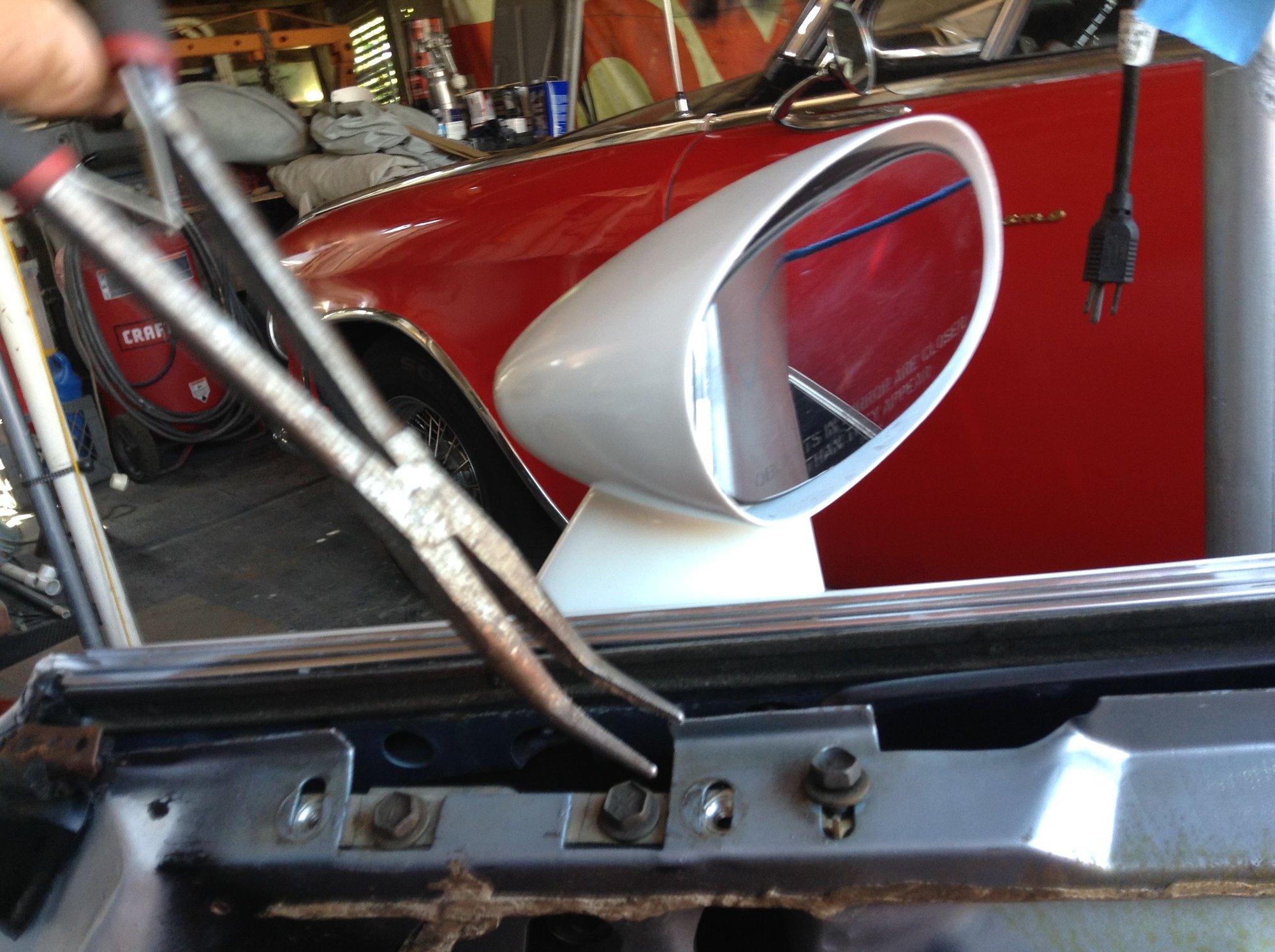

Mirror is on but my socket and holder ideas didn't work, needle nosed pliers with curves tips was the only way I could get nuts tightened.
