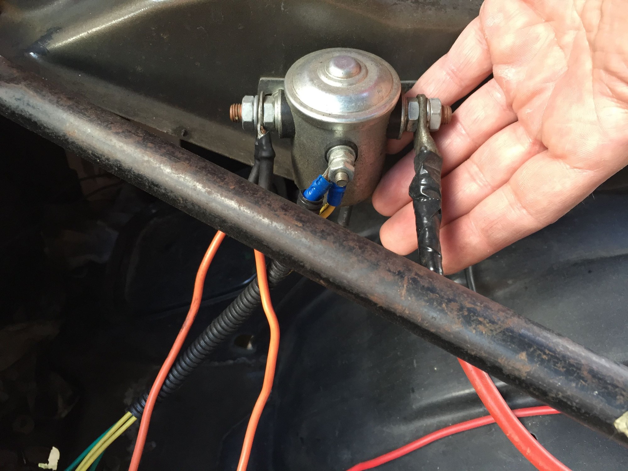

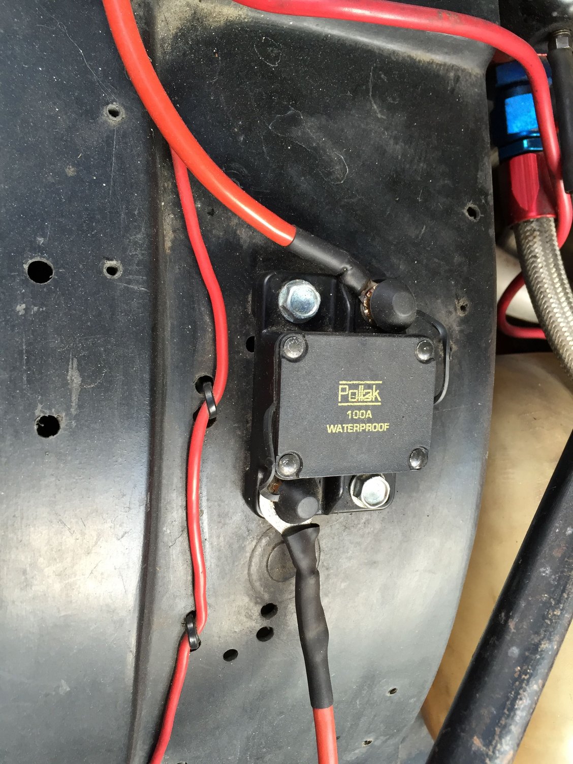

My previous ride had electric fans drawing 25 Amps each. The radiator was the biggest lump of aluminum I could fit under the hood. The relay was an 100 amp solenoid. I forget what the resettable circuit breaker was. The alt was a custom built 200 amp. Despite that, I could never relax in that car. I was always nervously eyeing the temp gauge. My concern was the temp relays would fail to fire and I’d only notice it when it was too late.
As much as I loved that ride, I want to get away from that. The fewer things that can co wrong the better.
