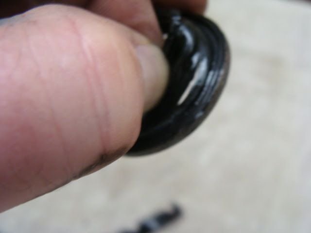

Default Found An Issue
Today I blocked off the ports of the mc. I discovered that I have a hard pedal when both ports were plugged.
Saw a very very small leak on the ground under the left rear caliper. Pulled the caliper off. I discovered that an inner piston seal had been leaking on the backing plate as the paint was destroyed.
My next issue...
I have SSBC rear brake calipers. I don't know if the factory seal kit will work on these calipers. Just to cover my *** I ordered some factory type seals. Then I discovered the kits for SSBC calipers at Summit Racing. Ordered a kit and of course it's Friday so I lose two or three days of work time.
The saga continues.

Default And The Culprit Is?
Today I took the left rear caliper apart. There was evidence of a leak on the left rear inboard caliper piston seal. I'm not saying this is the solution to my problems yet.
I'm sceptical that the front will now have a problem when bleeding them. It seems that I saw a very small drip of brake fluid below the newly installed combination valve. I'm receiving a SBBC caliper rebuild kit from Summit sometime today. So I'll get that caliper reassembled and installed. Then on to more bleeding.

GOOD !!! You're making progress !!! Remember - It does Not take a big leak to cause a brake pedal to fall...
While you're under the car having fun - try giving the lines to the new proportioning valve another 5 degrees of tightening.
Odds are decent that between the two issues - you have found your problem.
