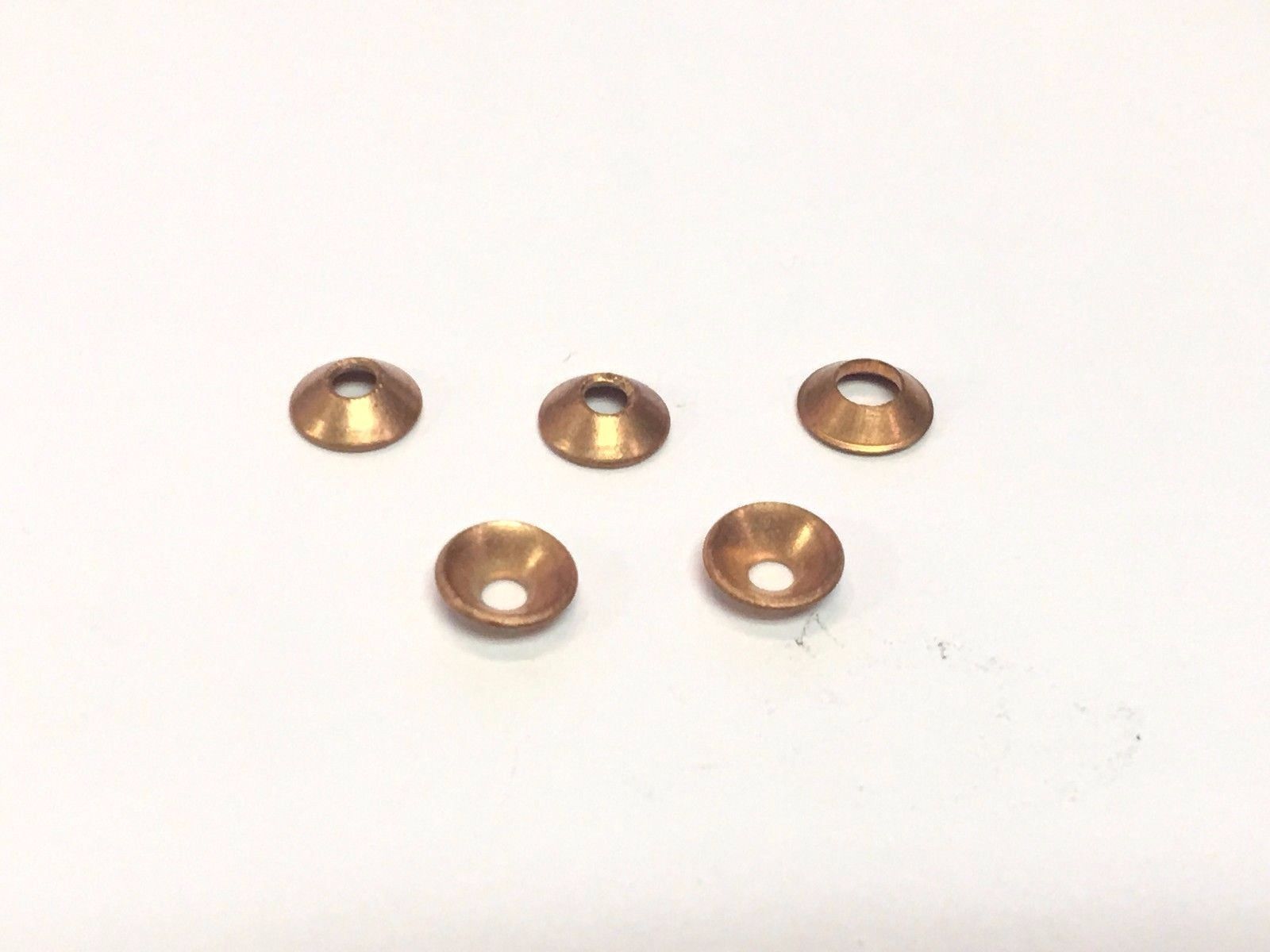

Copper sealing washers for a 3/16" brake line. Anybody use these? Have you guys seen them? Seems like a viable option on a SS line connecting to the brass combination valve. That's where my leak turned out to be. The front crossover line.
Yes I have. I used one on the elbow fitting on my fuel pump. No more leaking fitting.

Got the new crossover line installed this morning. I had a hard time connecting the line to the combination valve. I used one of the copper washers on both ends of the new line. No chance to bleed the system today as Mother Nature brought a band of storms in.

SS is really hard.....so to get t to seal 1/8 to 1/4 turns back and forth especially at the end to get it to conform. I have never used the copper thin washers

Where did you get the washers?
Scott I found them on Ebay.
Apparently they are used quite a bit in refrigeration line fittings.
