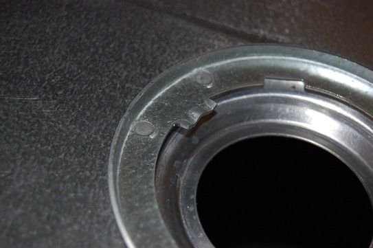

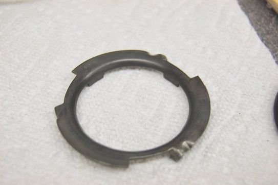

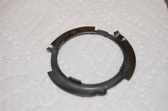

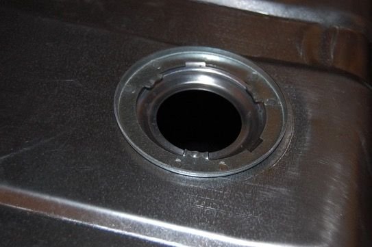

Hi Ed,
I agree with MW that having the 'tool' is a good idea. (Probably a BETTER idea then being a 'tool'!)
Also, take a close look at the mount and 'tabs' on the tank and on the lock ring too before you start to install the sender.
That way you'll be able to understand what's being accomplished when the lock ring is rotated and how the gasket seals the tank.

Eddie Salinas's Avatar
Eddie Salinas
Joined: Apr 2018
Posts: 55
[QUOTE=Alan 71;1597103327]Hi Ed,
Regards,
Alan
Great pic’s, thx
We did make a mental note of the notches, and determine how the ring needs to be installed.
Since we don’t have the “special tool” and it’s not available anywhere that we can find, we’ll have to depress the new seal as best as we can...
