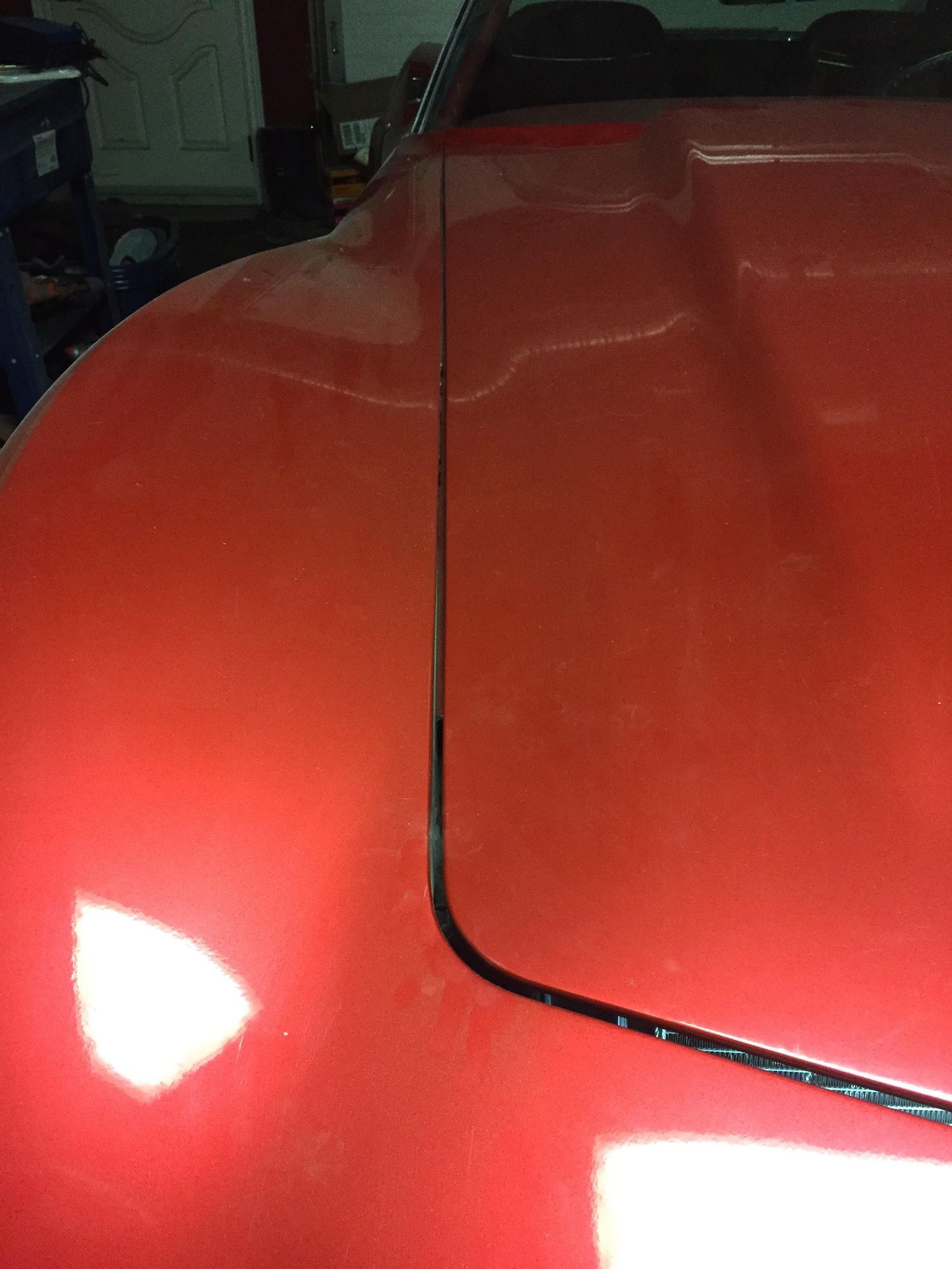

its a 75 sorry and right now the front is on stands, it was level ground an it closed ok. See pic below.

Here is a pic of what I am up against.

If you look at the hood line Dub youll see what I mean, the whole front of the hood is shifted to one side. If I can get those bolts out of the hinge then it should allow the hood to slide over and line back up.

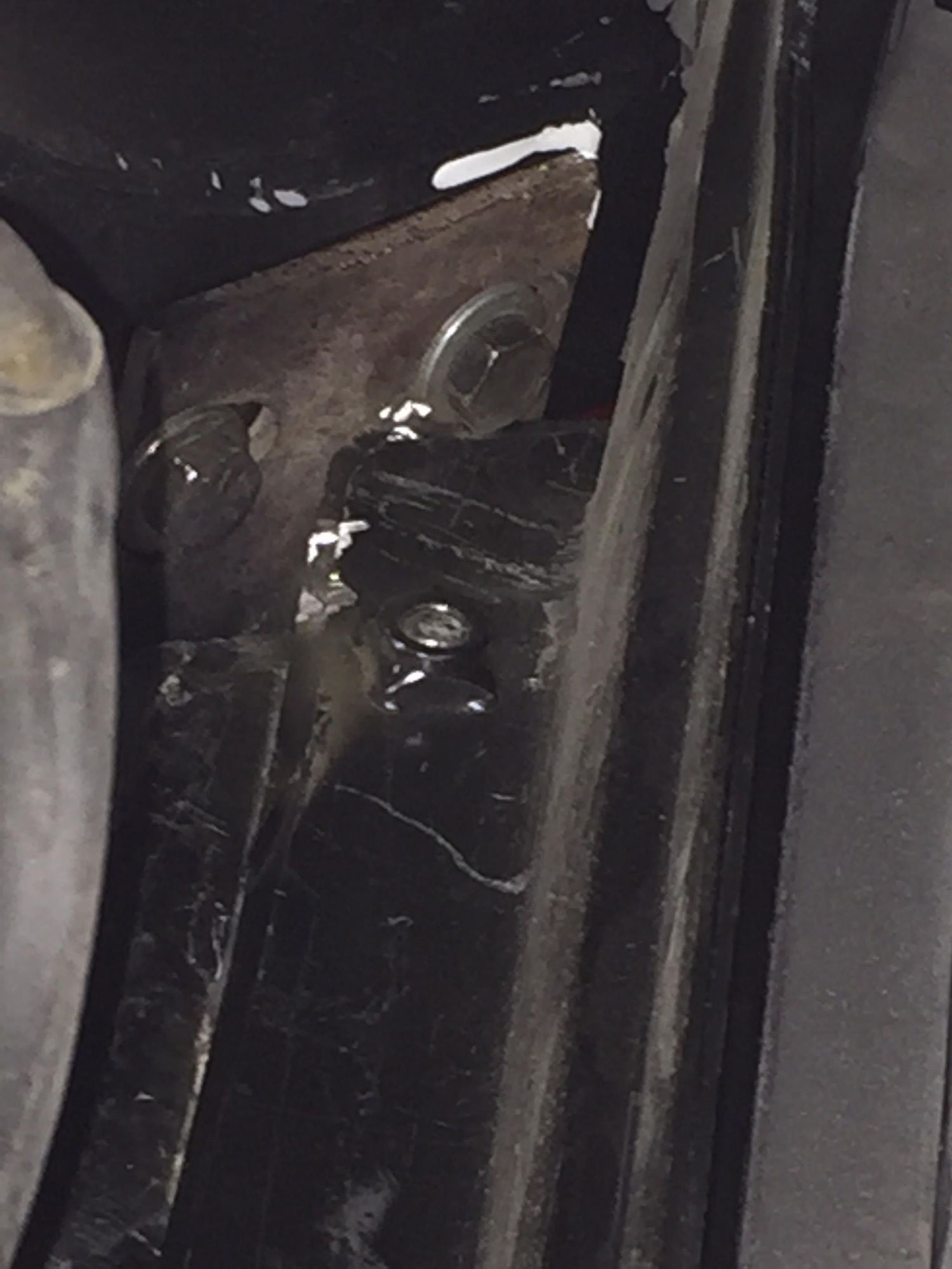

I up loaded 2 pics that should give you a clear picture of what I am up against

In your pictures it's really hard to tell what is going on. I know it's probably a real bitch to get a good enough picture.
In you last picture you said that the hood shifted to one side (appears the passenger front has shifted left). Have you tried to grab the hood close to the windshield and push/pull it to get your "shift" out while also trying to open it? The hood is super flexible and maybe you just need to flex it a bit to get it to open.
I'd try standing on the drivers side and pull the hood towards you slightly and maybe it will be enough to get it loose.

I appreciate you posted the photos...but I agree it is really hard to see what is going on there.
I am having a hard time trying to figure out how the hood hinge is binding with the radiator support. But as you stated...the part may have been made incorrectly which can throw everything off.
I have tried exactly what 'theandies' wrote and that is pulling and pushing on the back of the hood from side to side to get it to release.
I do know that I have had to get at the front bolt of the hood hinge where it is bolted to the hood before many times. I have also removed it. When it comes to the rear bolt of the hood hinge where it is attached to the hood...that is where one of those swivel head GearWrenches can come into play or modifying a box end wrench to get up in there.
I have had to also get in and l loosen the two nuts that hold the latch on the drivers side at the firewall. This is ROYAL PAIN but I have done it and you are basically doing it all by feel.
Also it appears that these hood hinges are not new and have been slotted more than what GM provided in the hinges. If these hinges are not new not new or have lot of 'play' in them. I suggest that they get replaced...or you can have problems in getting the hood to stay where you want it when adjusting it.
I swear that I could get to these bolts in your photo...due to generally...If I can see the head of the bolt I can find way to get to it.
