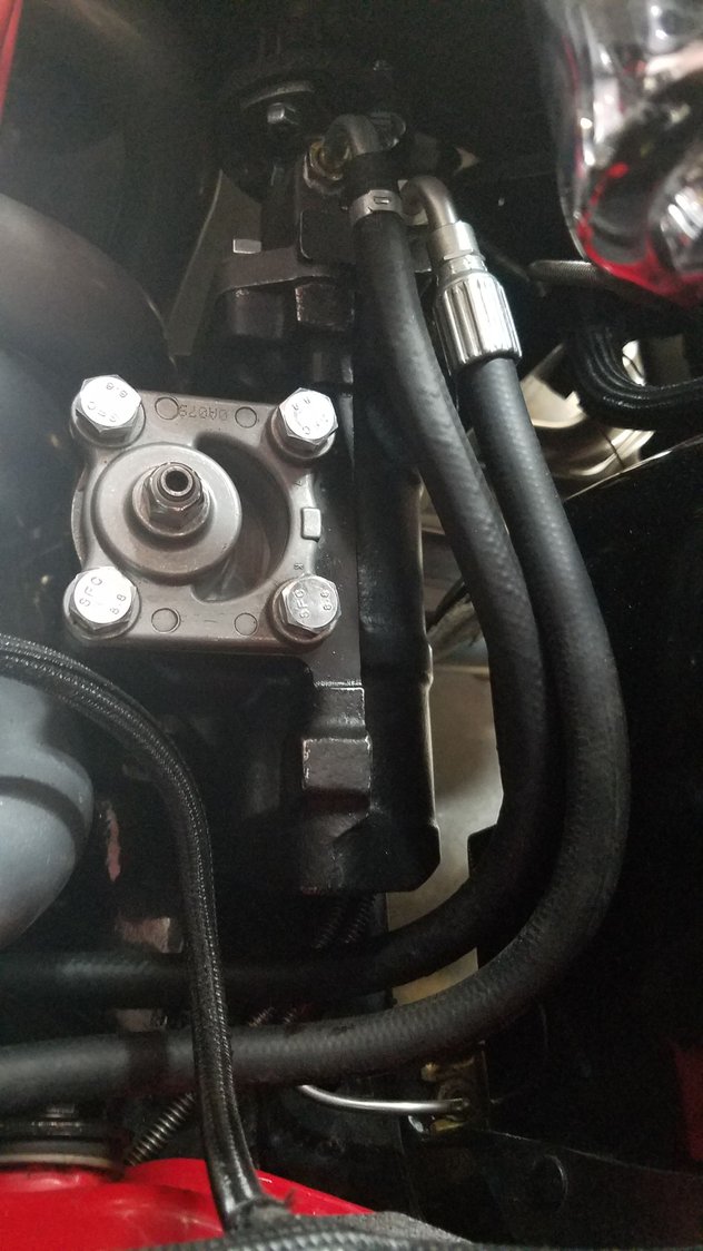

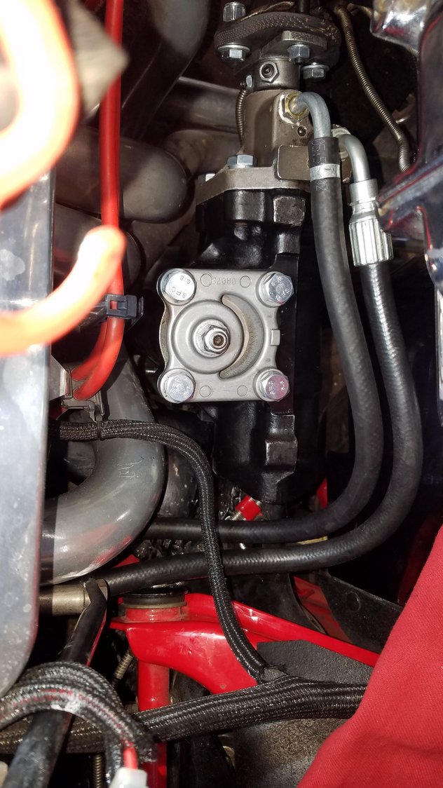

Will Hooker side pipe headers fit a C3 SBC with Borgeson steering box? Doug's Headers wont fit without dimpling. I'm hoping Hookers fit.

On my '77 with a SBC, I installed Hooker side pipe headers with the original steering box with no clearance issues.
I later changed to a Borgeson steering box, again with no clearance issues.

Fit perfect on my 1974 with Hookers!!

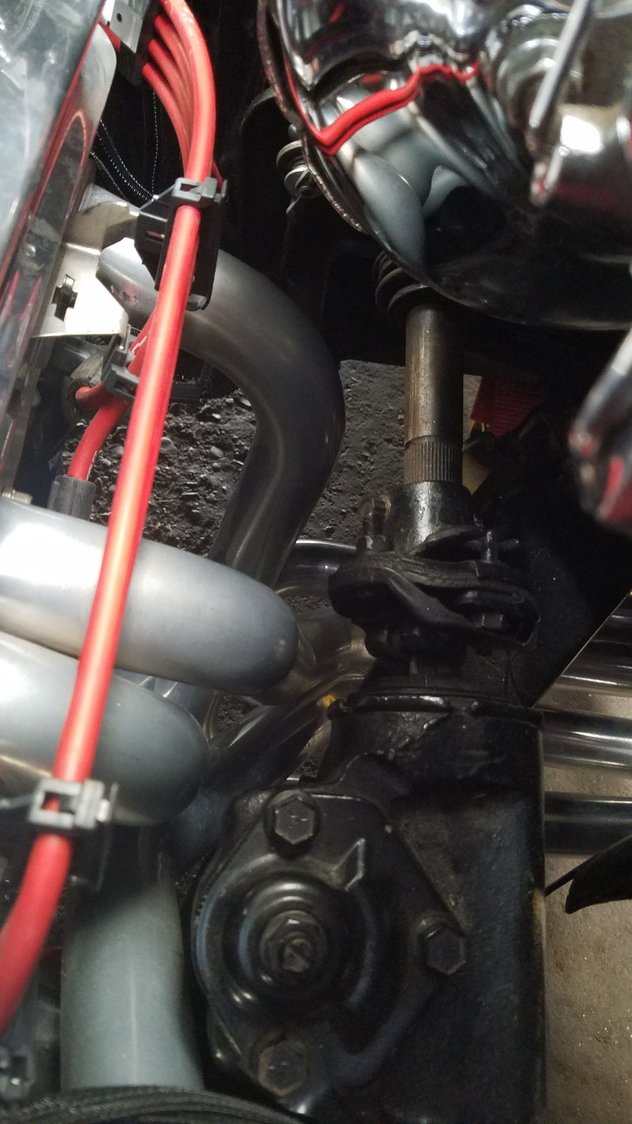

I installed a set of Dougs SS on my 80 a few months ago. It would contact the pitman arm when i turned the wheel. I put new poly motor mounts on which brought it away slightly and then took a dremel and slight shaved the pitman taking off a very small bit and now it clears fine.
