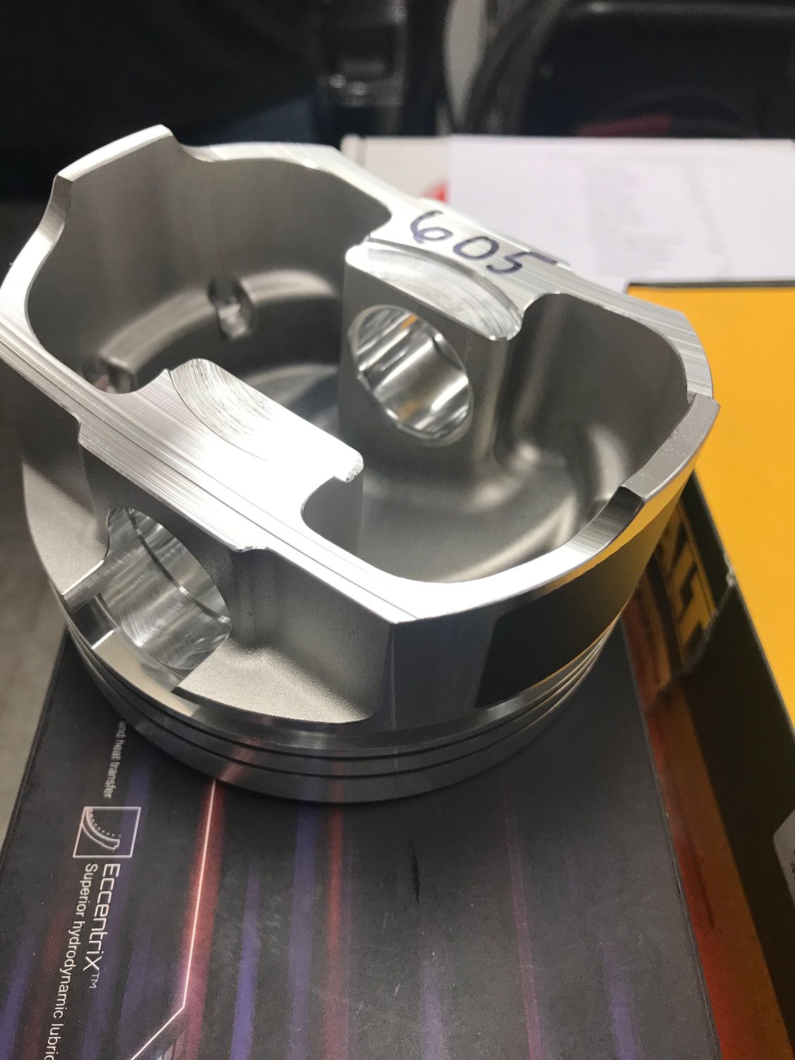

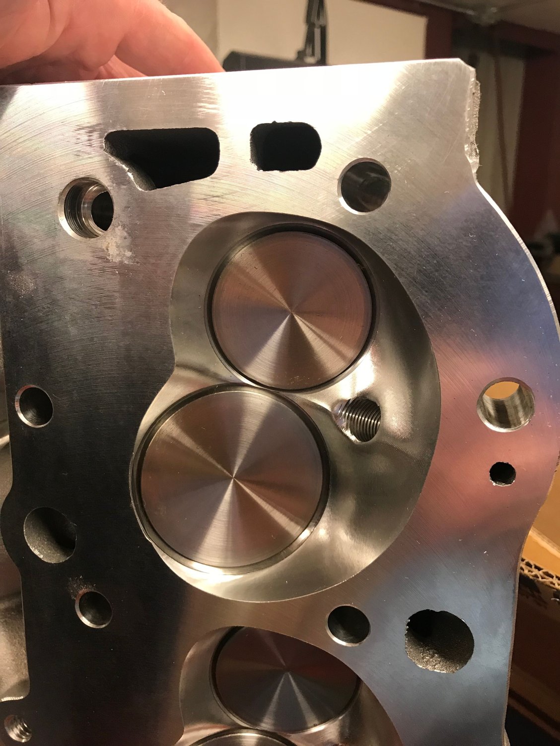

just waiting for the block to get back from the shop and will start assembly. Here’s a few pics for fun. I’d like to thankMike Lewis: The AFR heads are just as I’d hoped and ordering with you was simple.. also thanks for doing your usual beautiful job balancing my rotating assy and making the process so easy, your balancing work was top notch and I’m sure it will show when it’s in the car running. Also thanks for answering all my noobie questions.

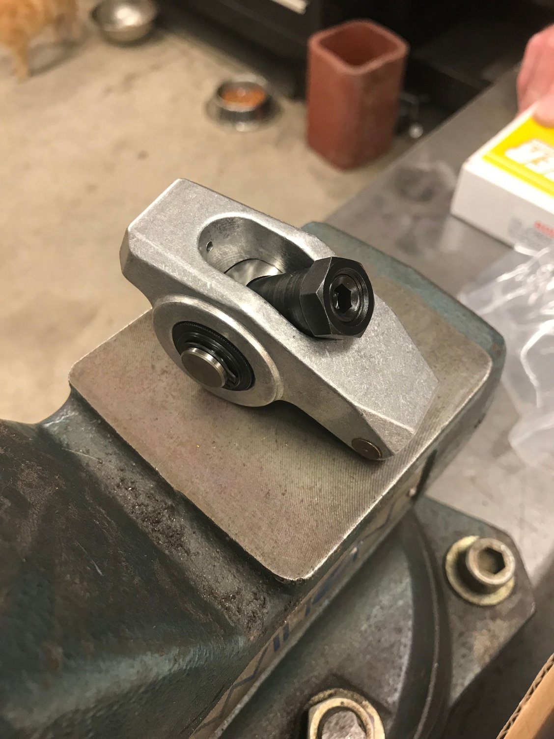

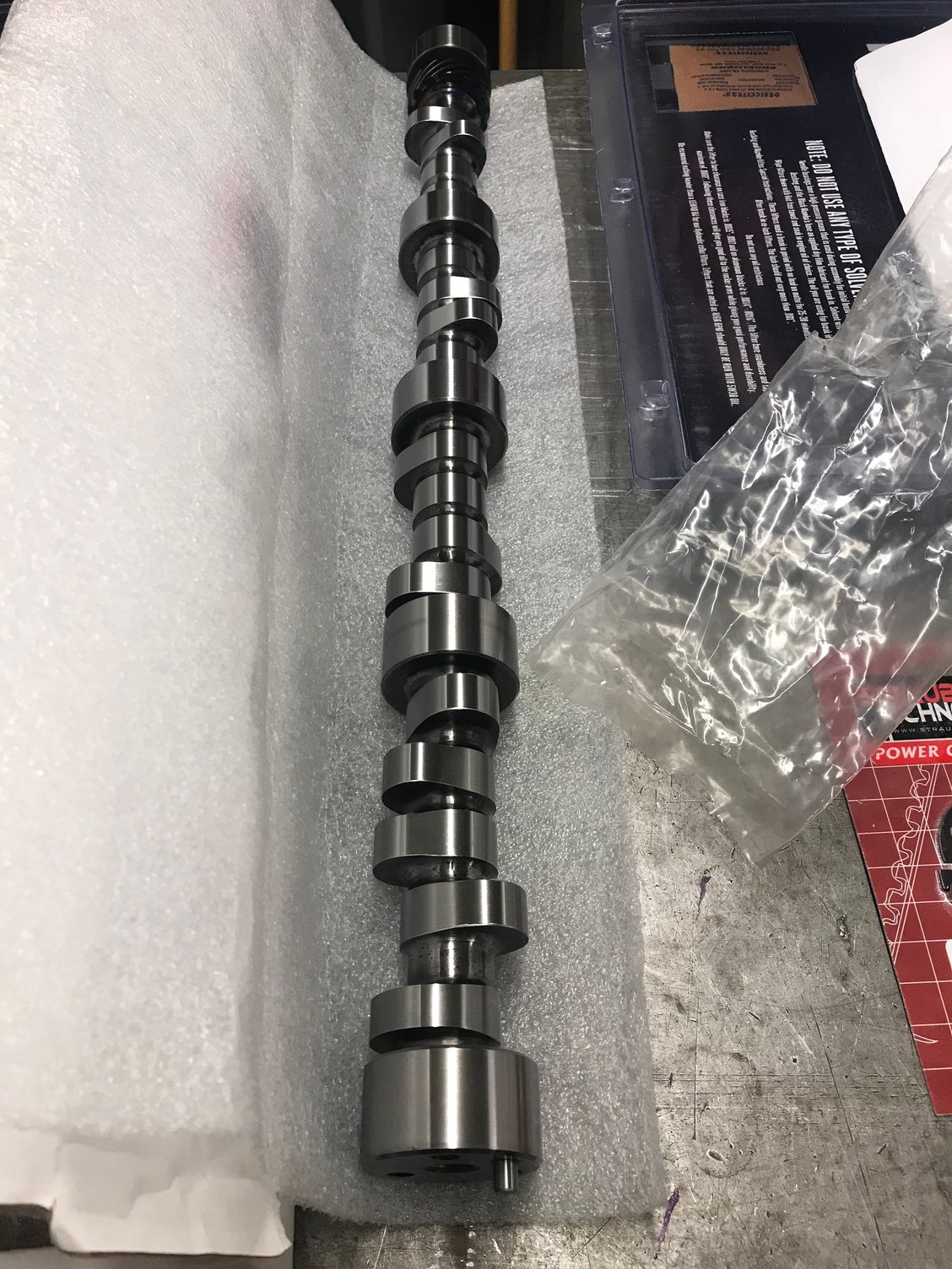

Chris Straub: cam looks beautiful as does rocker arms and lifters. Ordering process was very easy and personable, also thanks for taking all my calls and answering all my questions and helping me understand camshaft dynamics and what all those numbers really mean.

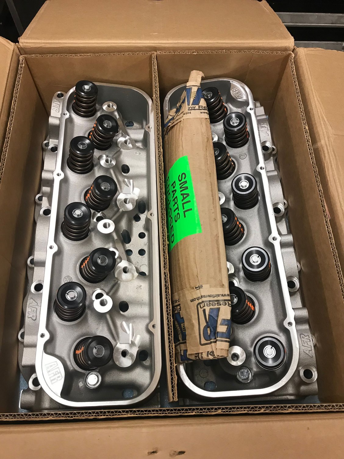

It's always nice to see a build with valves that are so big that they almost touch in the chamber
Yes I thought the valves were really cool and huge 👍

The heads look good, 265 or 290? Just like mine except for the spring color. Are you doing a solid roller? Looks like you went with solid roller springs with a 220 seat pressure.
Old May 11, 2018 | 09:04 AM
Muzzyzx7rr's Avatar
Muzzyzx7rr
Posts: 239
Likes: 17
they are the 290’s. Yes I went with solid roller from Straub. Man those afr heads look so nice I want to put them on my wall haha. Sig aren’t you running a 496 similar?

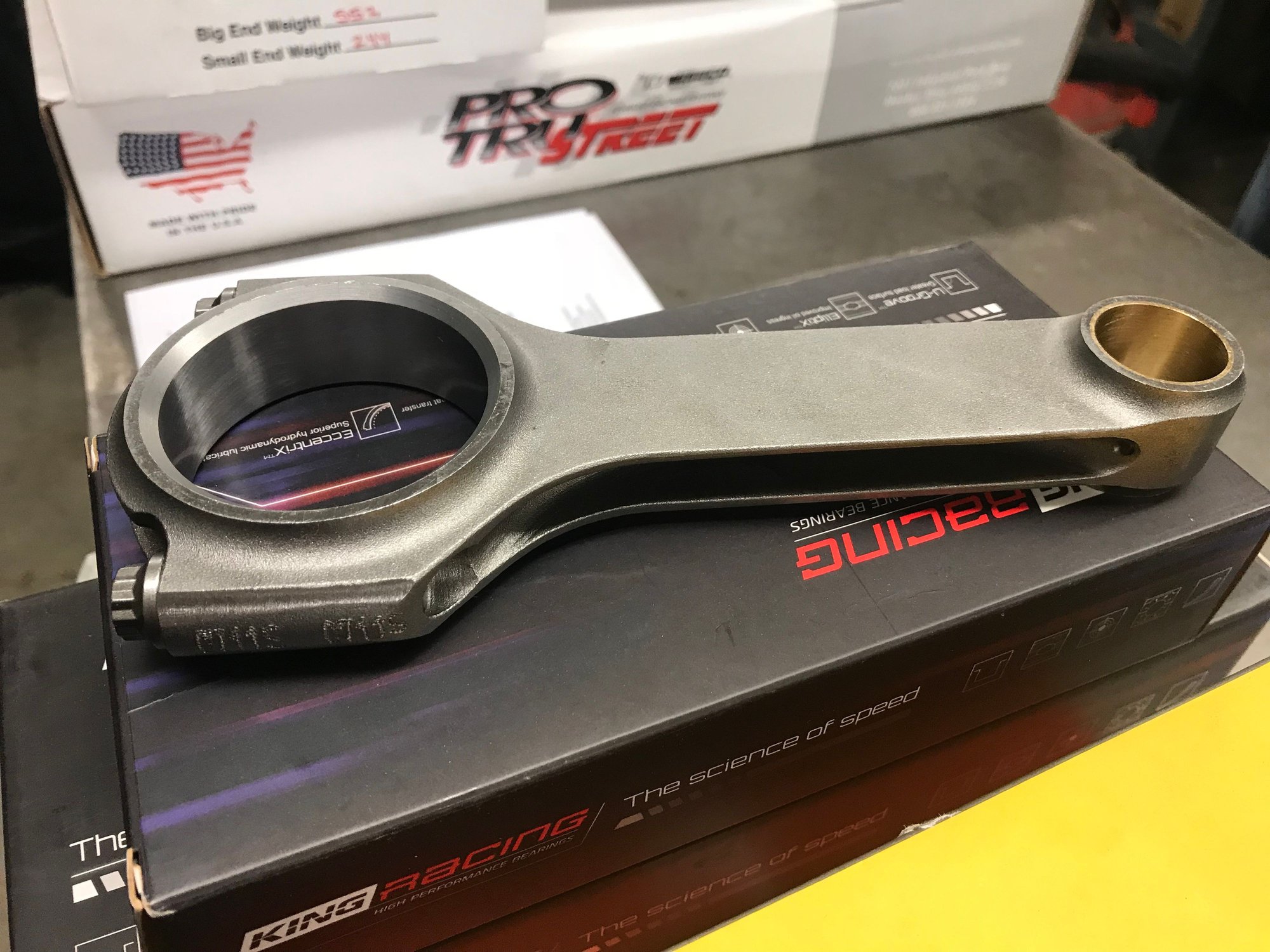

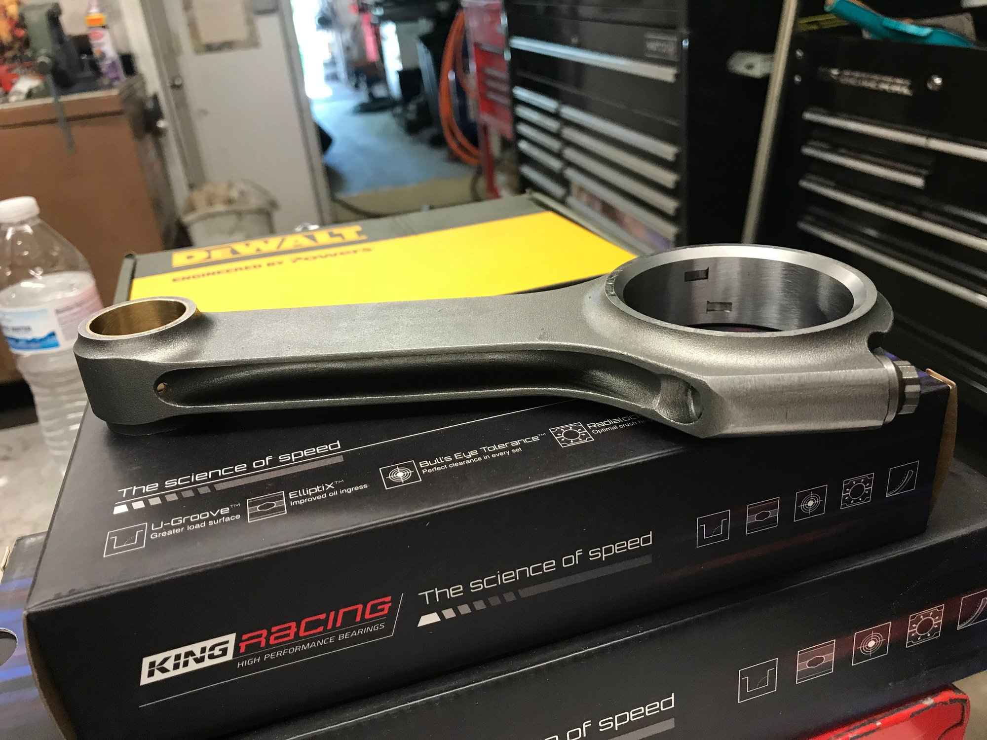

I am going 467 (60 over 454). Got a Straub hydraulic roller for mine as I did not want to lash valves. With the parts you have, you should make some good power. From the picture, looks like you have Wiseco pro tru pistons. I used most of the same parts you have. What rods did you get? I see they are H beam. I am using Scat I beams for my setup.

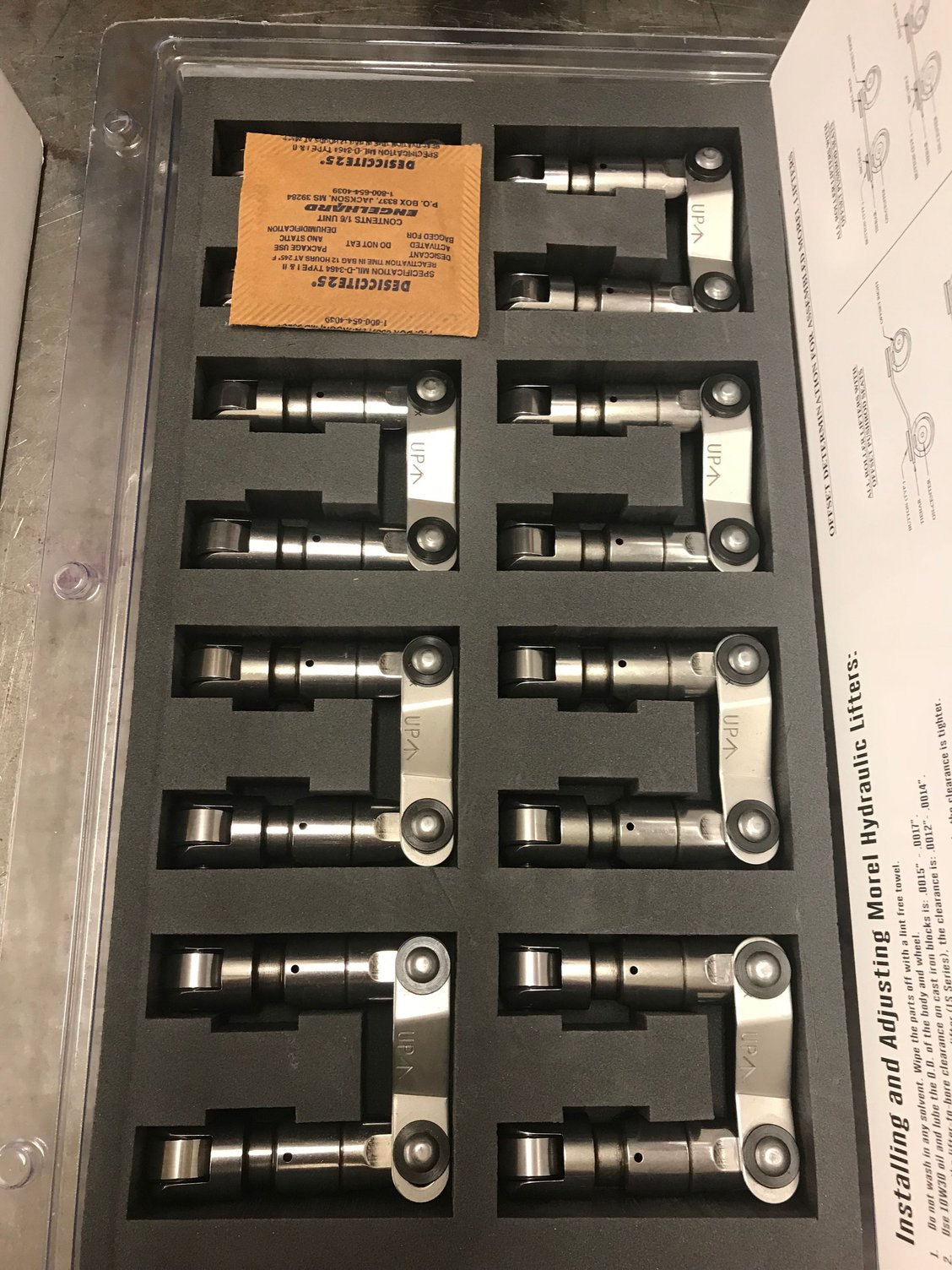

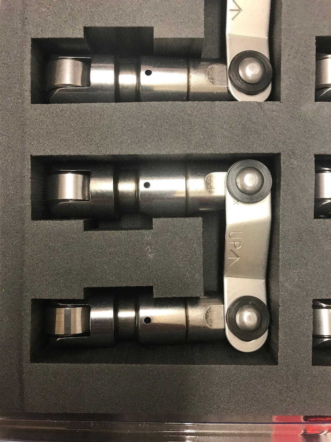

The lifters in the picture are h rollers and those are small diameter springs more like the 145 pounds on the seats

Looking forward to following your build. Love the rods. Can’t even see the seam in the big end.
yes my crank, rods, are forged scat and Wiseco +20cc dome forged all balanced by Mike Lewis. I’m pretty excited. Well that’s pretty cool it looks like we have really close set-ups. What are the specs on your cam if you don’t mind?
Old May 11, 2018 | 11:18 AM
Muzzyzx7rr's Avatar
Muzzyzx7rr
Posts: 239
Likes: 17
can you expand? Are you thinking the springs look wrong?
well thanks im sure having fun with it.
no the lifters are just just full time oiling solids. I thought the same thing when I first saw them.
I was wondering the same thing, the lifter box says adjusting Morel HYD lifters. That made me assume HYD lifters not solid.
Mine is a 229/229 .600 lift 109 LSA cam. How about you?
Gkull, here are the 2 springs that AFR specs for those heads. Mine are the h roller springs with the green strip.
http://www.airflowresearch.com/afr-8...draulic-roller
If you notice his has the orange strip, which would be the solid roller springs.
http://www.airflowresearch.com/afr-8...d-solid-roller
247/256 .640 109lsa
