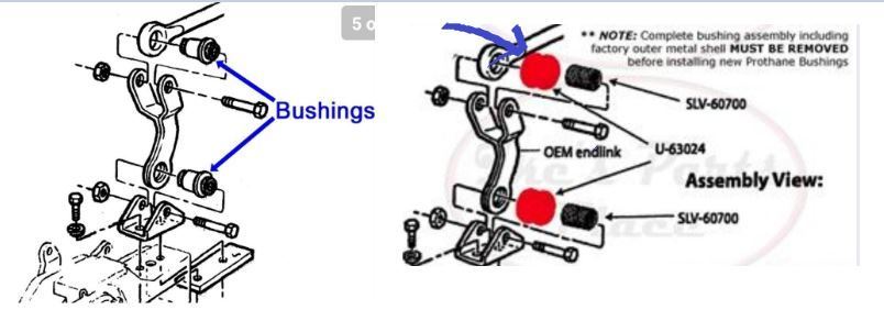

I was looking into poly bushings for the rear sway bar on my car. I was curious your experience installing them. The urethane bushings are flanged at both ends, meaning you can't get them thru the opening on the swaybar or link. If you bolt them in per the instructions above (right side) you have a metal-on-metal contact from the bar to the link and from the link the seat.
If you use the stock bushings (left side) you have rubber contacts at both side.
Am I reading the installation instructions wrong?
