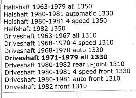

These sizes are for all 71 corvettes? Or have manual or auto trans different joints?
Old Oct 26, 2018 | 12:01 PM
Peterbuilt's Avatar
Peterbuilt
Joined: Aug 2006
Posts: 7,426
Likes: 1,559
From: mount holly NC
Default Does this help?
