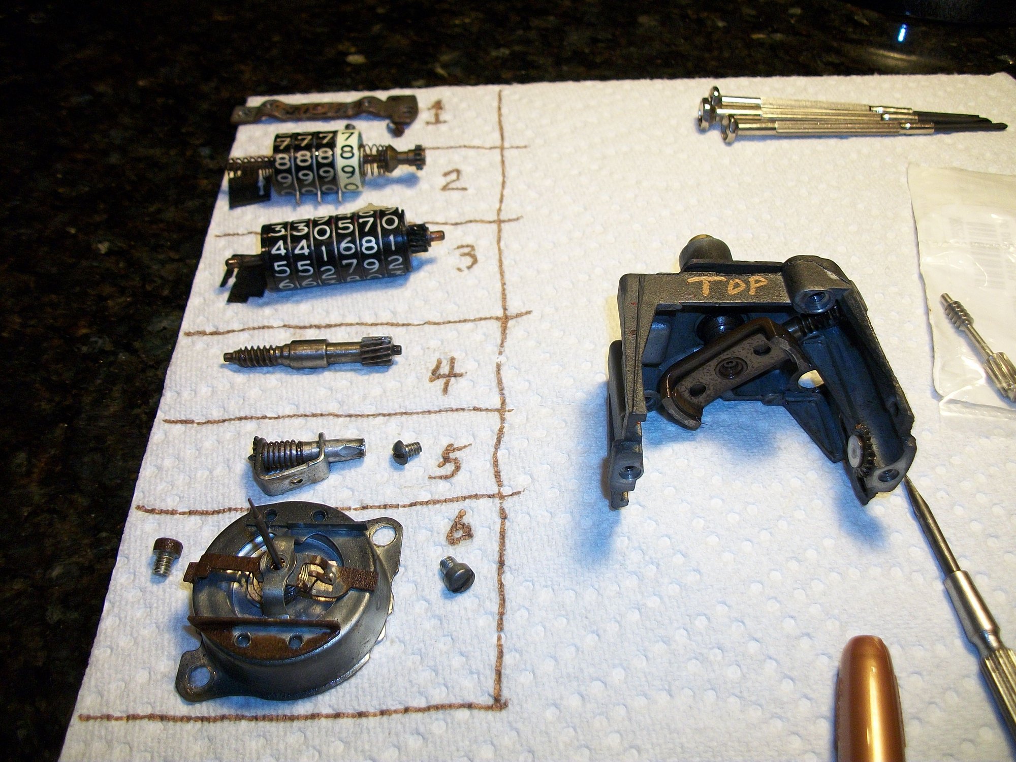

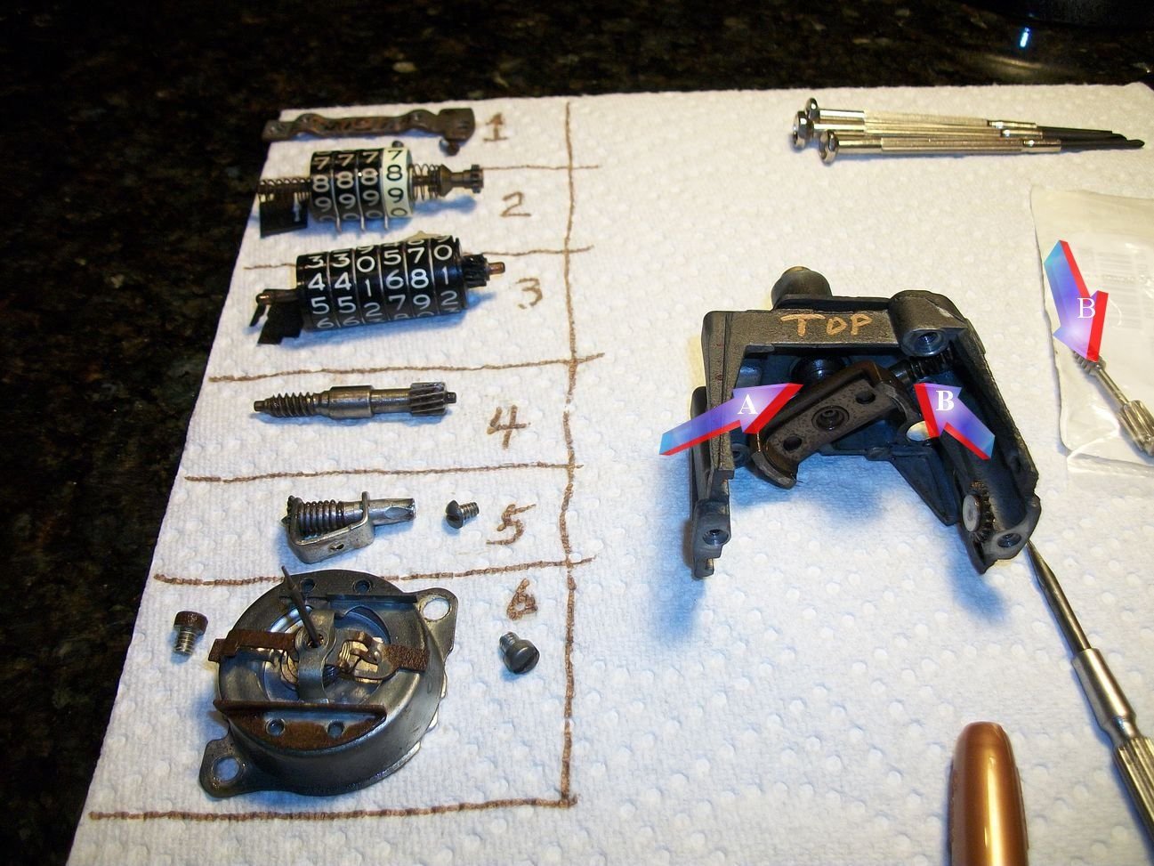

My odometer failed last year, input shaft/gear (A) and gear (B) failed. The grease on those gears had turned to dust. I tried replacing gear (B), however the shaft/gear (A) was too worn.
I ended up replacing the entire speedometer with a new one.
After some investigating, it appears that the shaft/gear (A) was used in several other GM speedometers. Some day I may come across an old speedometer that may have the correct shaft and repair my original speedometer.
I have read that the tach uses that same shaft/gear.
