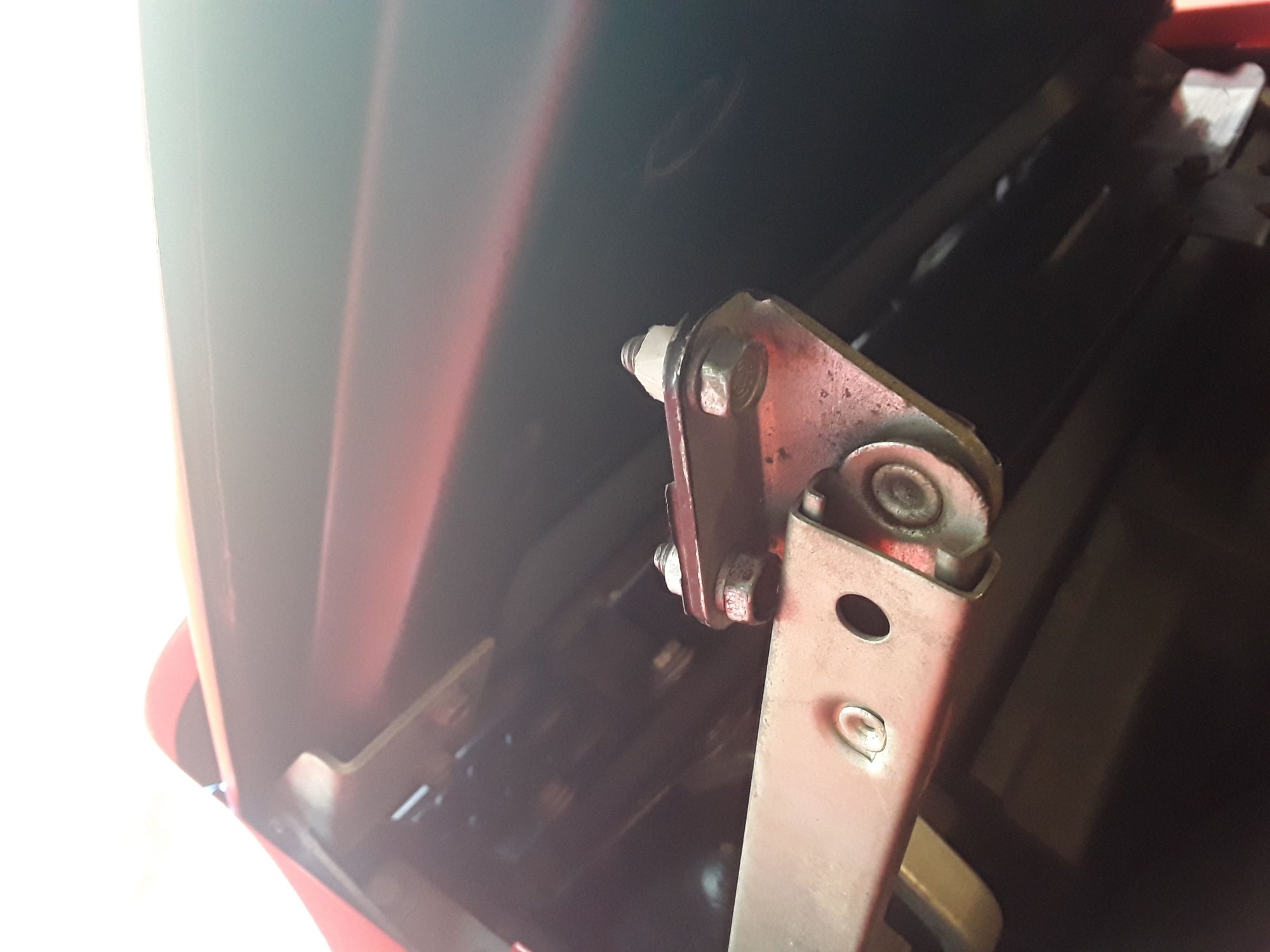

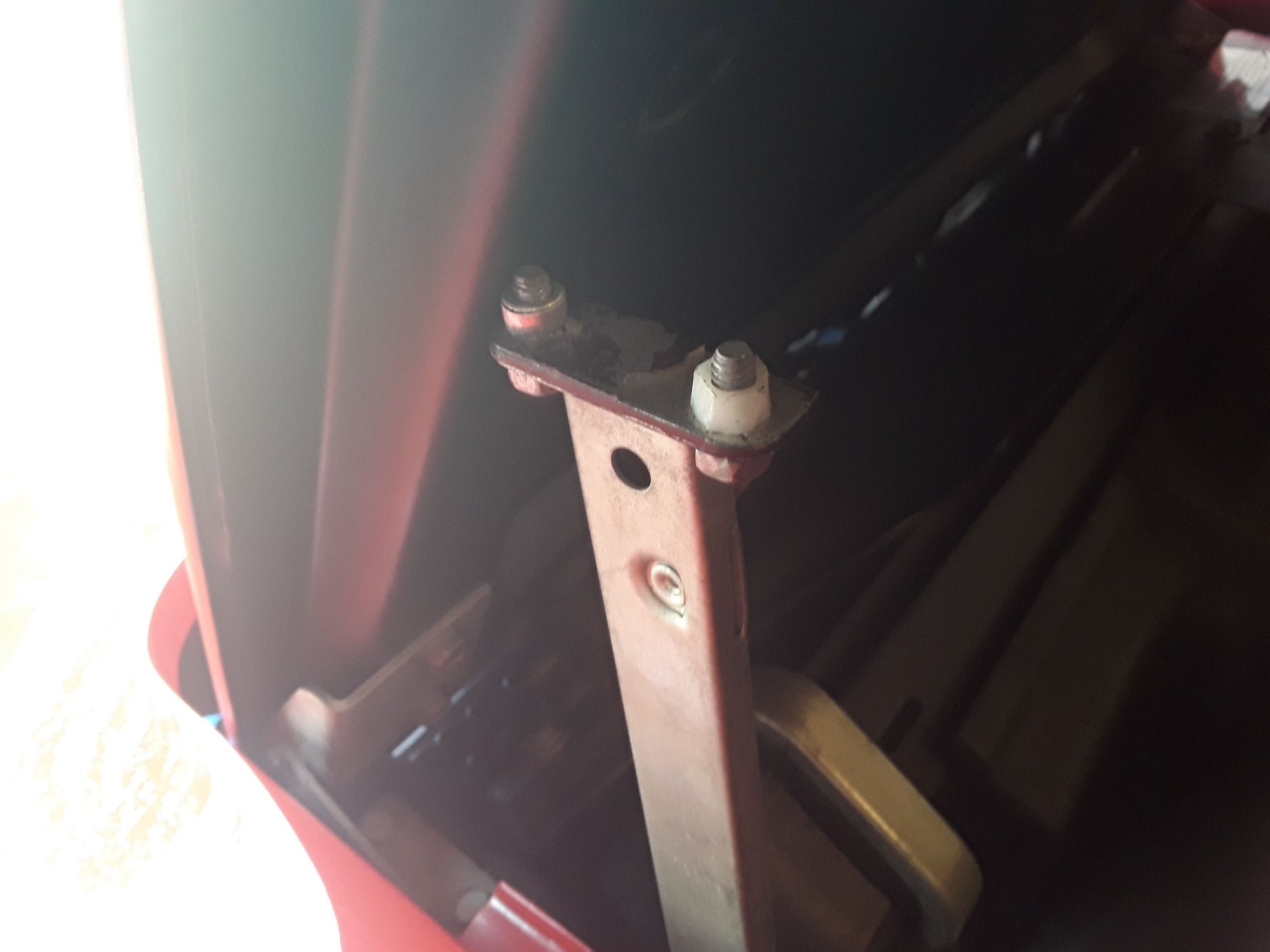

Default Here is a photo of the problem

thanks for the photos...but... what does the metal plate inside your hood look like???
Are the threads stripped out???
Is there a metal plate still there at all?? Hopefully there is still one in place.
I cannot help you fix this if you do not help out with good information.
DUB

Default The plate is not on the hood

OUCH!!!
How skilled are you?
Meaning....I know I could fix this due to having the tools and know-how.
But me telling you this and that may not make sense or you may not have what is needed to fix this.
This can be repaired a number of ways and that depends on your skill level and the tools to do the job and you willing to buy what is needed.
DUB
