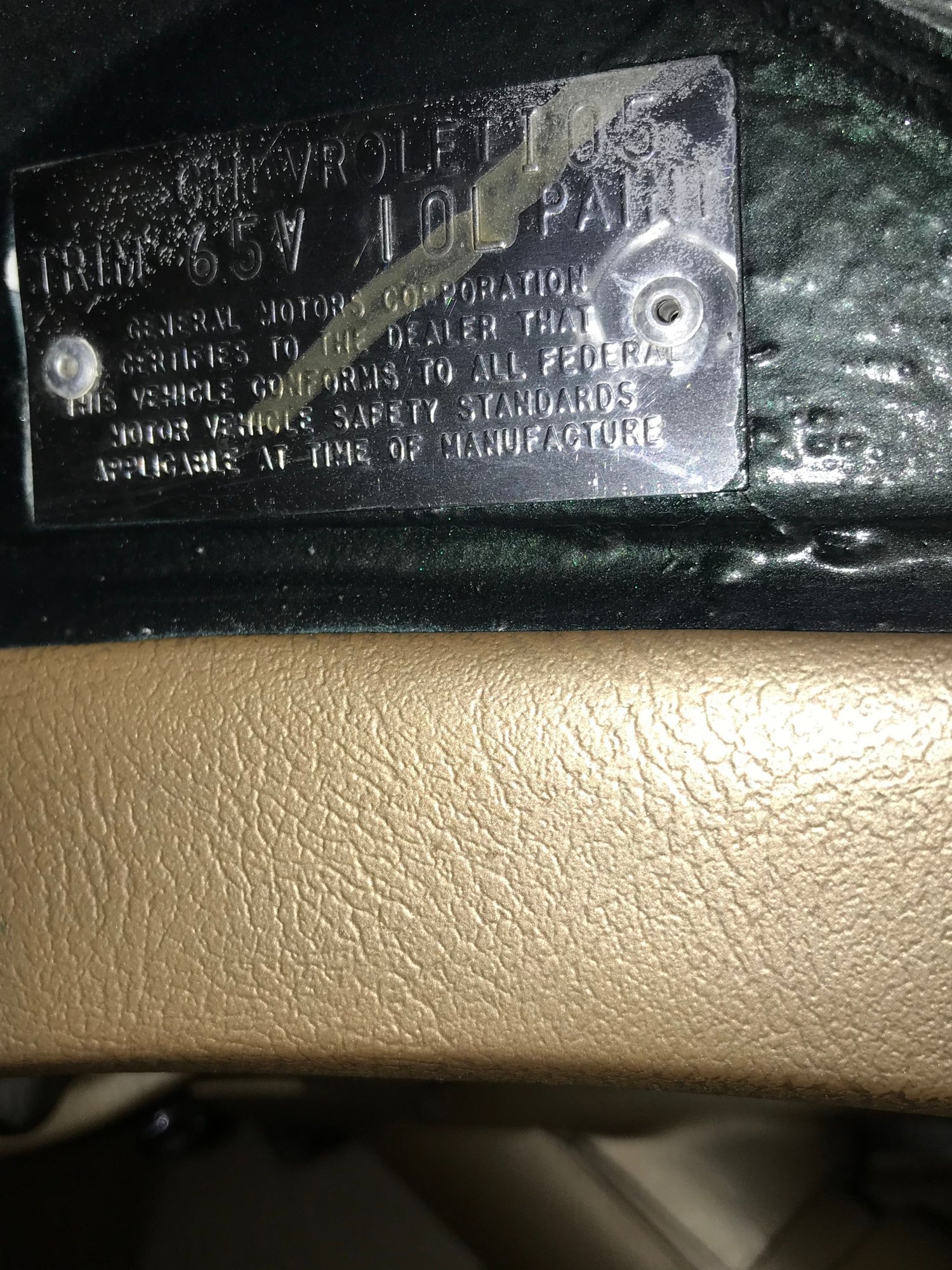

Thanks for the response. While mostly original, the car has gone through a "restoration" in the past and the tank sticker is long gone. When you say "behind the door", is that the trim and paint tag on the drivers side below the A pillar?
That is the one. It contains your paint color information, your interior color code and style, and it contains your assembly date code as well.

My tag teads I05 which corresponds to June 05, 1975? I guess the alternator could have been sitting on the shelf for a month?
