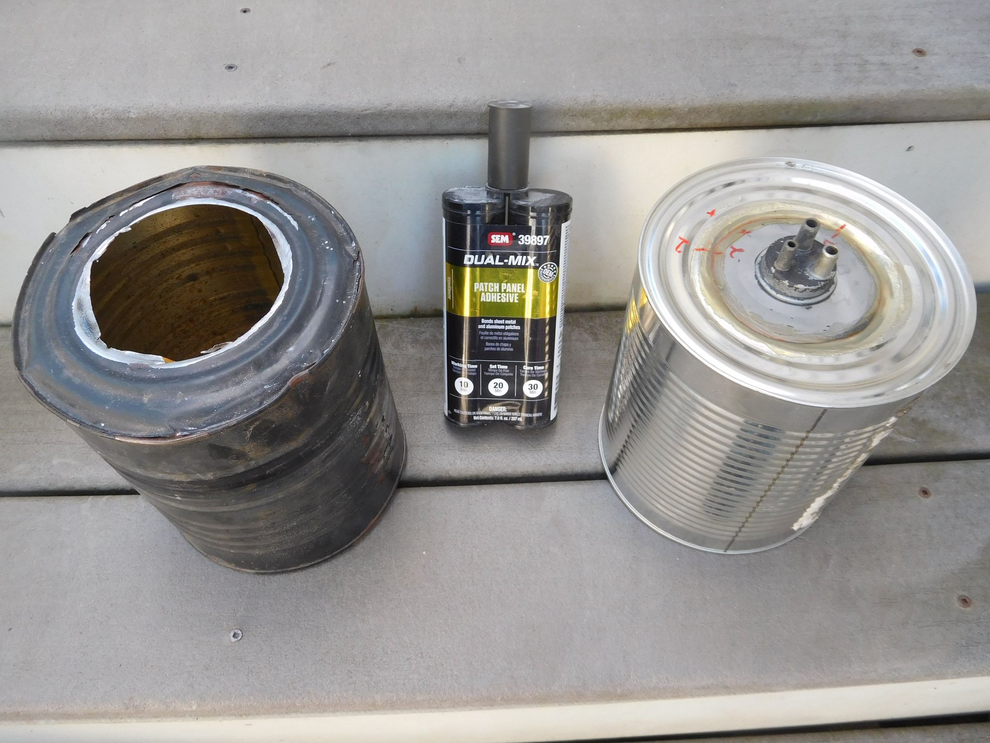

Default 4.99 Can of Hunt's Tomato Sauce IDENTICAL to Original
All fixed!

Now, before you install that tank, cap two of those fittings with rubber caps and connect the other to a manifold vacuum line. Start the engine and watch the car. Idle rpm is good; more rpm makes LESS vacuum! If it lasts more than 30 seconds, you're good-to-go.
P.S. Tomato cans may not have vacuum applied to them. If not, they don't need a heavy-duty can. Coffee DOES need the heavier can because it is sealed in a vacuum to keep the coffee fresh. Hopefully, your can is strong enough. [Boy, that last sentence didn't sound right, at all....]

I'm really interested to see how this turns out. I like clever solutions to problems, and this is right up there. I hope it holds!
Old Sep 17, 2019 | 07:13 AM
  #45
PeterMAX1's Avatar
PeterMAX1
Joined: Jul 2007
Posts: 46
It turned out great. I scuffed the can, etch primed it, and painted it semi gloss black and you can't tell the difference. It's as tight as a bulls *** when vacuum applied. The SEM product is used to hold quarter panels on vans without a problem. The only thing that will separate it is 1100 degrees from a heat gun.
MY ONLY PROBLEM IS I FORGET IF NIPPLES FACE UP OR DOWN WHEN BACK INSTALLED. I wrote in caps hoping someone will answer :-)

It doesn't really matter. If they are turned down, moisture will be able to 'leave' instead of stay in the bottom and cause rusting. But, moisture isn't much of an issue with 'vacuum'.
