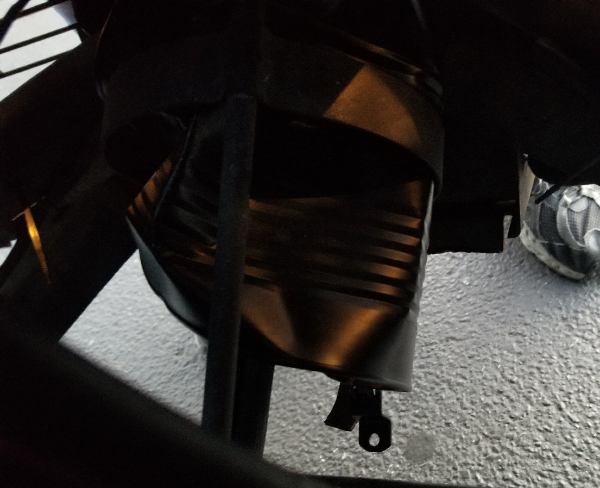

Here is a photo of the crushed vacuum can....and my car doesn't suck.
By the looks of it it sucks big time.

Buccaneer's Avatar
Buccaneer
Joined: Nov 2005
Posts: 3,532
Likes: 1,185
From: Arizona - If you don’t know CFI, STOP proliferating the myths around it...
That has to be a cheap *** CAN, no way that should crush like that.
Old Jun 5, 2018 | 07:10 PM
DUB's Avatar
DUB
Joined: Apr 2009
Posts: 19,294
Likes: 2,753
From: Charlotte NC
YEP..I would say that vacuum can is a P.O.S.
Just ANOTHER part that some jack @ss bean counter got their hands on and had to make cheaper.
