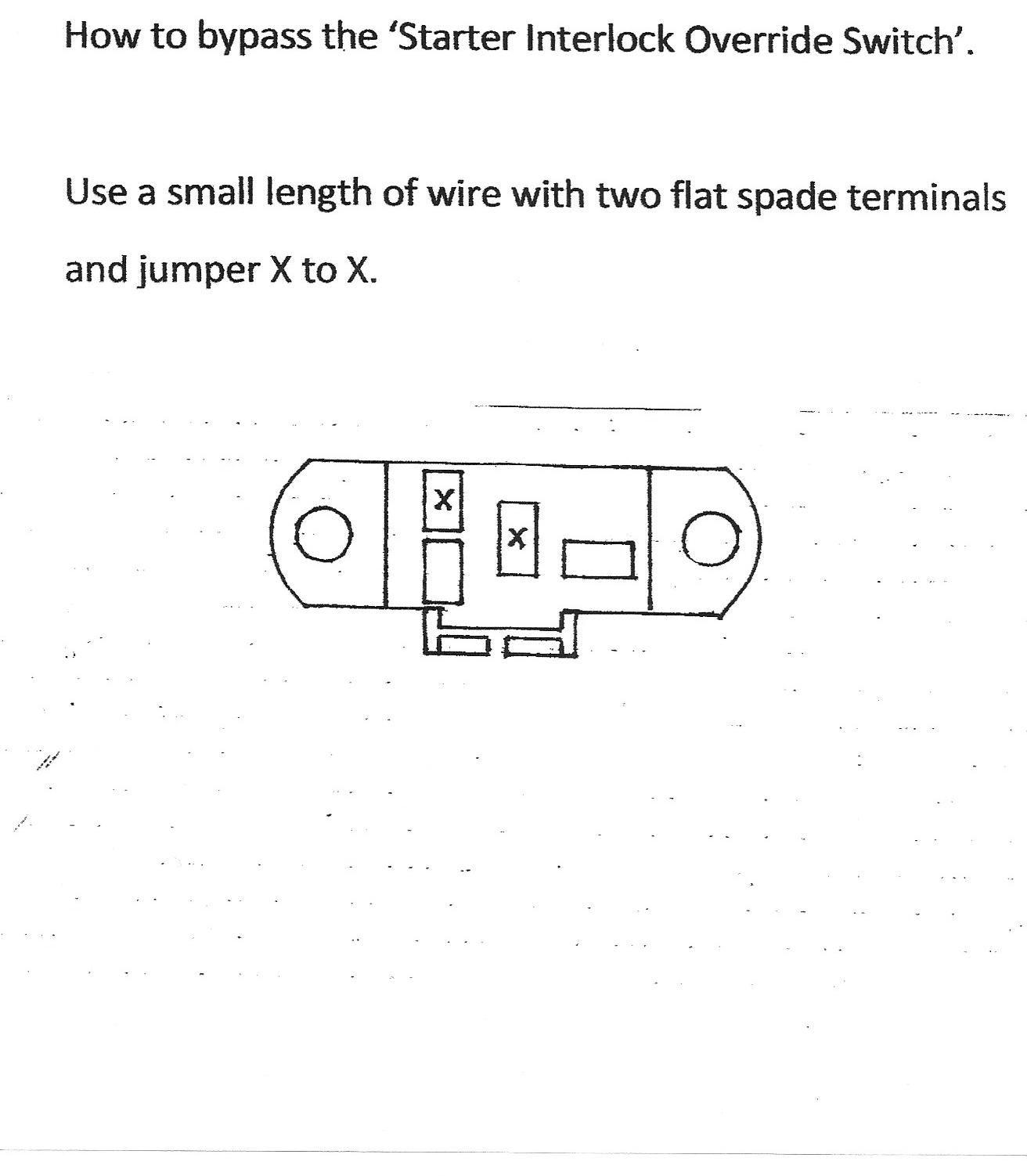

Try cleaning the terminals and use some dielectric grease.
Or leave the relay off and bypass as shown.
