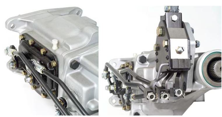

Have you considered a Long's shifter for the T-10 instead of the Hurst? I changed my 5 speed to a similar unit and there was no comparison in shift quality. It's quite a bit more expensive, which may not be in your budget, but just thought I would mention this option if you hadn't heard of them. The 5 speed version went right thru the factory location on my 76 with no modifications.
https://www.gforcetransmissions.com/...r_4_hb100s.asp
