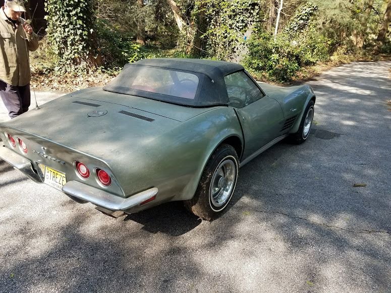

Bob, thank you for help it is greatly appreciated. I will follow up on how it's going. Here are a few pictures of what we are working with...
Old Jun 26, 2018 | 01:35 PM
bobs77vet's Avatar
bobs77vet
Joined: Sep 2004
Posts: 11,874
Likes: 263
From: Arlington Va Current ride 04 vert, previous vettes: 69 vert, 77 resto mod
looks very nice good luck with it, bob
