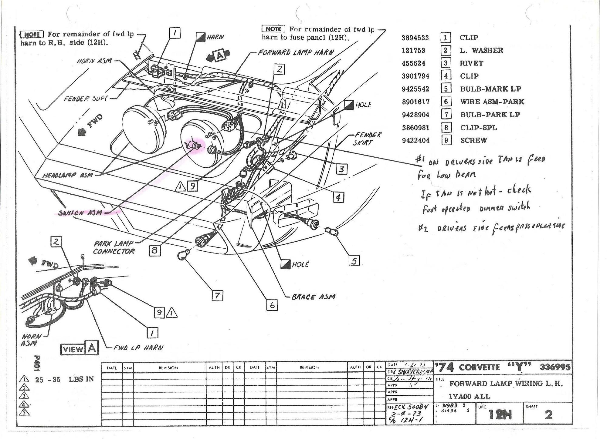

The switches (one for each headlight) are shown here:

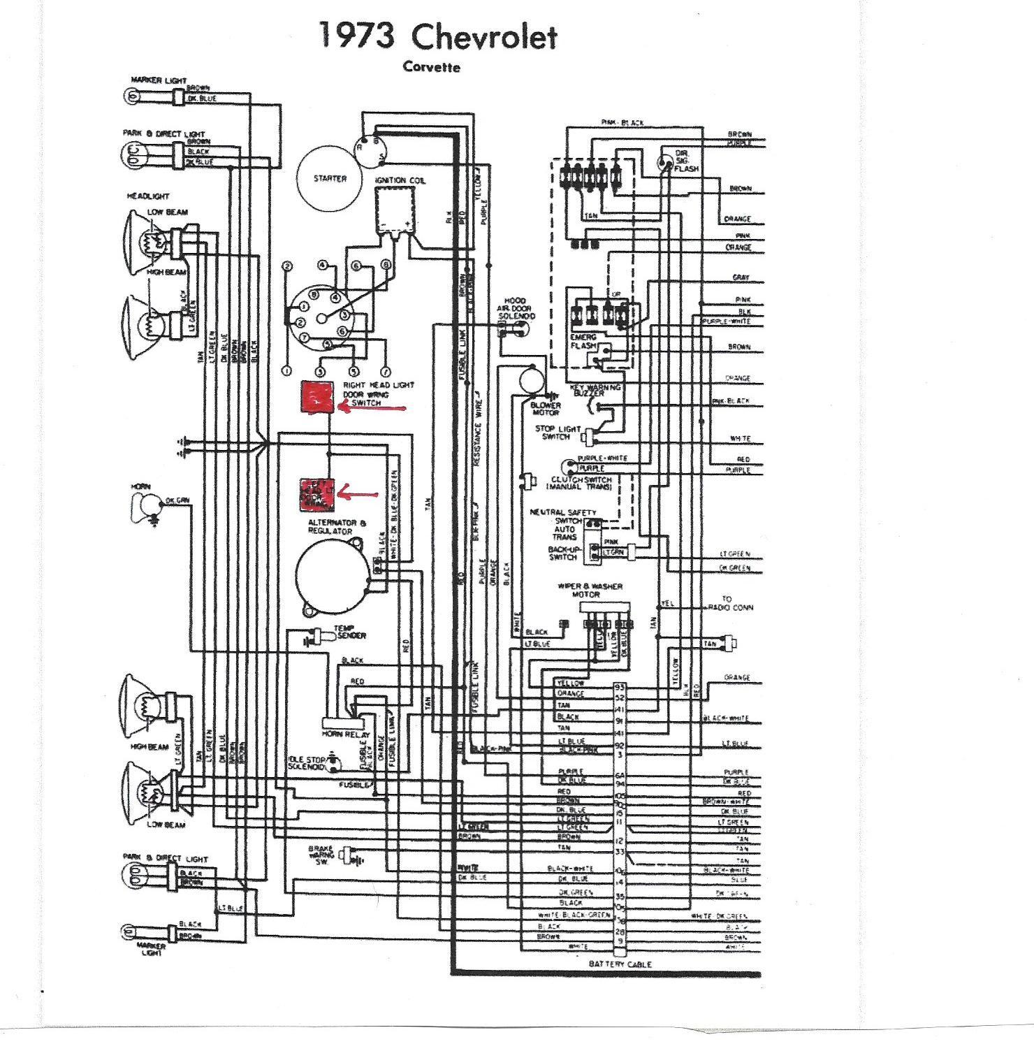

Id bet that the switch has broken. I cant quite figure out where it is in the schematic, but it’s made of plastic and threads into the housing. It breaks off at the threads and then won’t close. If you look at it from underneath, you’ll see a wire hanging down with a plastic block hanging from it.

Here they are:
