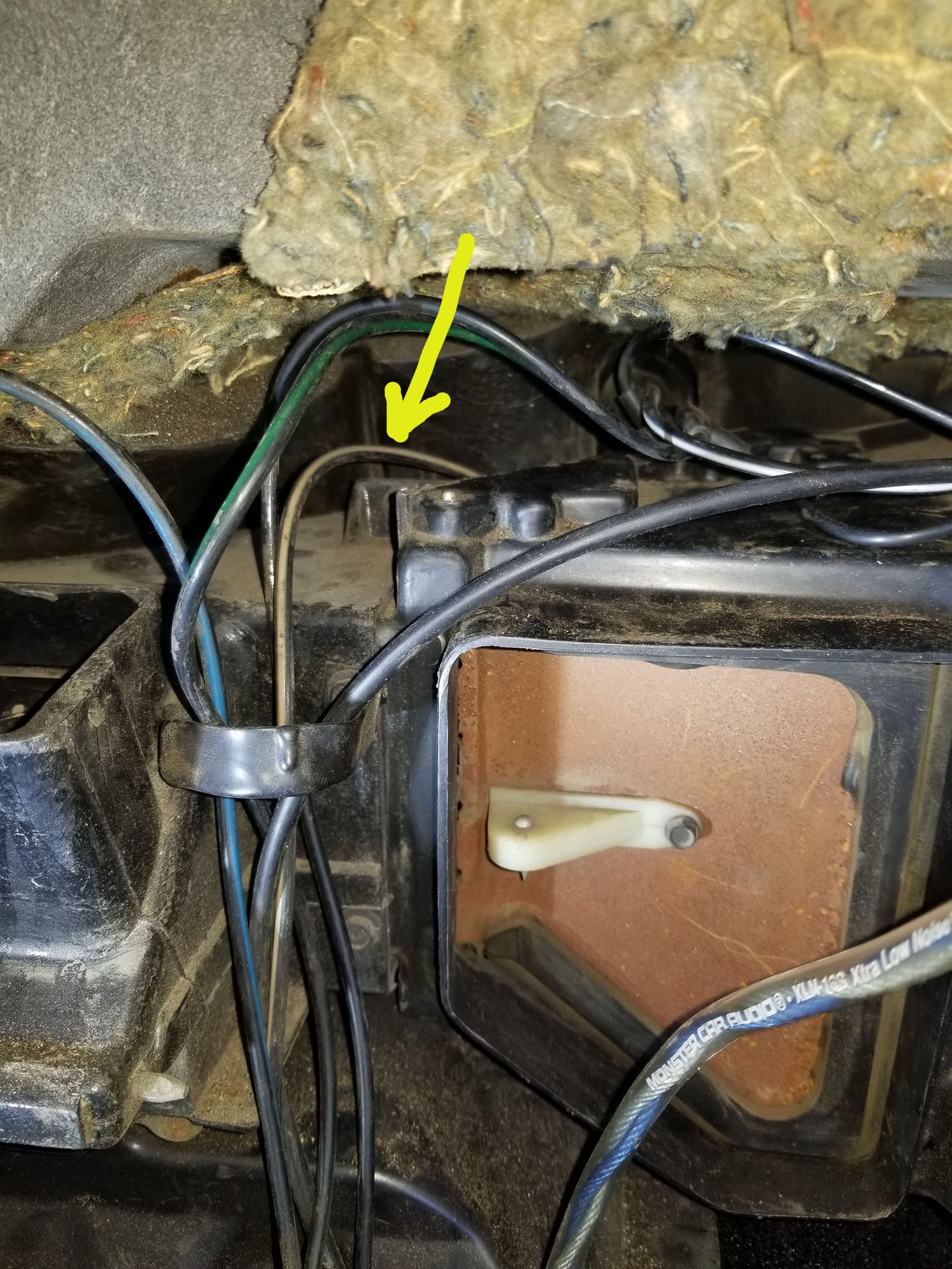

While I have the dashboard out of my 1980, I was thinking about replacing the vacuum lines from the heater control switch. It seems that the one hose with the white stripe goes down behind the unit. It controls the diverter flap. Does the entire box need to be pulled out to access the hose connection on the vacuum module?

Unfortunately, there is no other way I know of to get to that line. There just isn't enough room to get a hand in there. I would test it and not replace it if it's working. While you're at it, you should hold the vacuum on that line with vice grips and see if the door stays open. If everything is OK, I wouldn't remove the box just to replace the line.

I actually did check it and all the vacuum actuators work correctly. One big issue is the plug that fits onto the vacuum switch, its not the greatest fit and I used some grease to help make the seal. I guess I'll do the same again. I have not found any original style replacement parts, The hose replacement kit I got forces the removal of the original vacuum plug module with separate individual hoses. The green, blue stripe hoses as well as the black hose are somewhat easy to access, that white striped hose is the killer. Thanks for the infomation

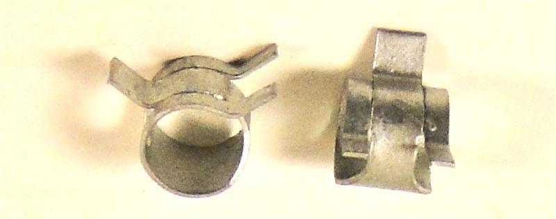

I purchased a hose kit from Dr. Rebuild. It contained spring clamps to hold the hoses on the control switch securely.
It might be too late but you can buy the clamps separately from him.
Craig

Those clamps are for the diameter of the hoses in his kit which I also have. I was going to use the kit until I came across the one white stripped hose that runs to the rear of the heat unit. At this point, I am not going to pull that unit just to replace the hose. So I am stuck with the original vacuum plug unit that fits onto the vacuum switch. I don't believe the plug was a good positive design back in 1980, never mind 28 years later.
