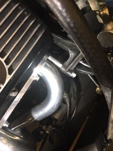

Your 77 should have the R4 compressor not the long R6. When I put my headers on all I had to do was use a piece of threaded rod in the manifold hole that connected to the ac bracket. Keep the spacer that is there as you will need it too. 3/8” rod and nuts should be all you’ll need.

My Patriot Shorty headers came with this spacer, this spacer is available at CorvetteCentral (SKU #453092 for 77' - 82')
