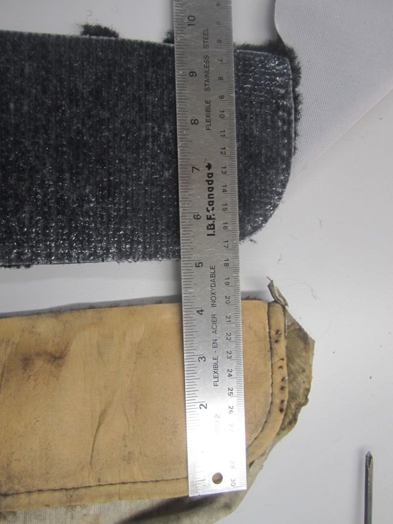

I'll add another set of images from an original set I have that show the same where the carpet / vinyl / cardboard were sewn together and also those staples in the end
And a comparison of the original vs CA repros
M
