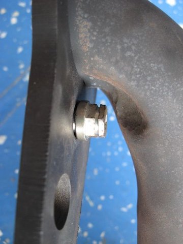

And here's why I use the 6-point, small-hex bolts with the added allen head feature:
You guys with small block Chevys have it made. There isn't a tough header bolt to get to on a SBC - it's so easy you can install the bolts with a box wrench, and even use studs. You can install SBC headers blindfolded with minimal effort. On other brands, it's different. I work on all musclecars and engines, and here is what I deal with any time I work on headers. Try to use a 12-point bolt in these locations, where you can't get the box wrench onto the bolt head. Where there is no straight-in access at all to the bolt. Or where the bolt must be accessed through the wheel well opening with a 2-foot extension and an allen tool. Or imagine installing studs on one of these engines... (Bolts shown are the Stage 8 bolts, shortened to fit this application. ONly access to the 3 photo locations shown are with an open-end wrench. Other locations can only be accessed using an allen wrench on a long extension):
