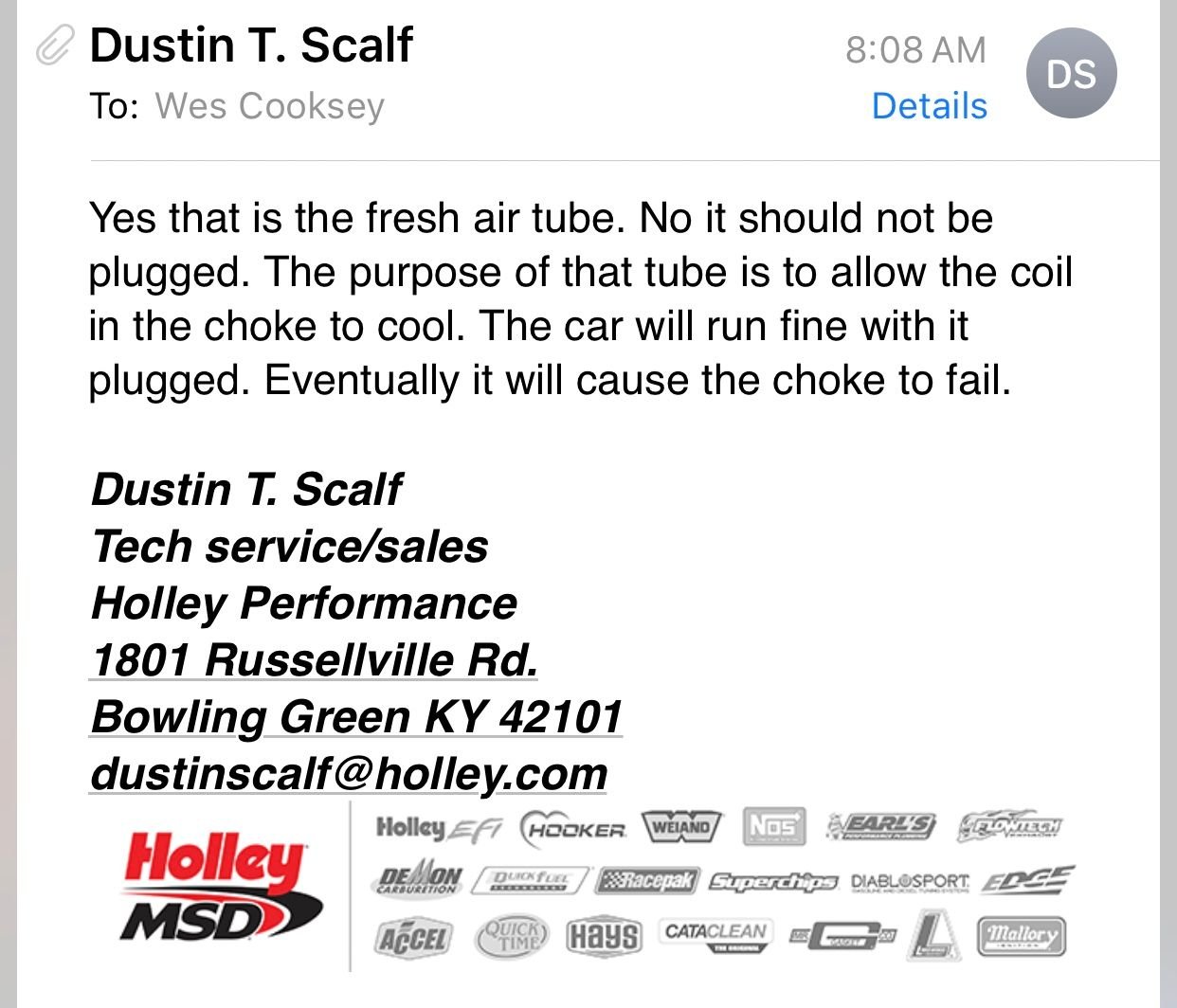

I’m talking with Holley Tech now..... they actually answered my email quick
Old Aug 3, 2018 | 04:27 PM
Jetglow's Avatar
Jetglow
Joined: Jul 2010
Posts: 561
Likes: 287
From: Louisville KY
Thanks for your help and point this out.... Hollyhocks got back with me quickly after I sent the photos..
