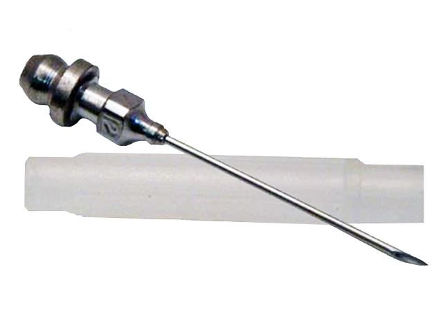

needle grease fitting
and yeah, you need to clean out all the old stuff which is going to resemble candle wax... mine did, '76... took forever to get it all out. My window speed doubled after cleaning and lubing with some good moly grease.

Thanks Fellas. If it was factory, GM sure was sloppy back then. The door handle mechanism was a big ball of dirty grease, all over the housing which will never make it's way into a metal on metal joint. I've got all the door internals out and are soaking in my parts washer. New parts and new motor on the way. Do think it was an original motor as had a big ole Ac Delco on the side. I also picked up one of those needle attachments for a grease gun to see if I can force a little in and around the joints. Outer seal also needed replaced to keep everything dry.
We must have been typing at the same time, that is exactly what I picked up. Glad to hear you had success with it.

and they work great for old ball joint boots that don't have zerks
