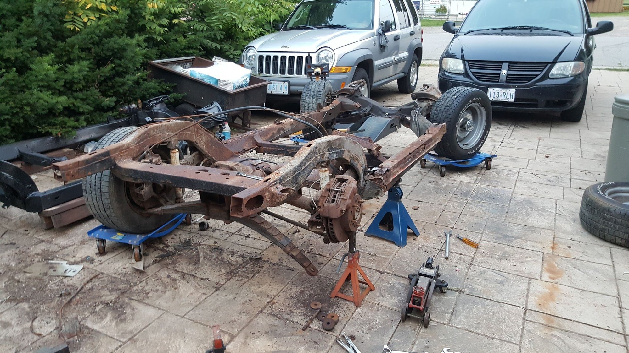

Normally, one would place a jack under the spring to release the tension on the bolt, and then lower it slowly once the bolt is undone. However, the body in my case is on a dolly in the shop, and I wanted to get the rear suspension removed so I can work on it over the winter - and get rid of this monstrosity of rust and death from my driveway.
Without the weight of the body on the car, jacking up the spring just lifted the frame... unsafely at that. So I came up with a "tool" to compress the spring slightly and release it in a very controlled manner.
It's angle iron and 3/" threaded rod. Very simple. 6 bolts (one is missing in this photo), a couple of lock washers.
And it worked like a charm!

very good idea.
sorry to say that frame looks a mess ! even got part of a birdcage stuck on it !!!
are you getting the good bits off it to swap to the newer one behind it ?

Nice idea for removing and install the rear leaf spring. Trying to install the spring without the body on can be a challenge for sure. You seem to have found a pretty good and safe way to do it.

And Yeah- that frame... it's a disaster, eh? The frame behind it is where everything will live in the end. Springs scare me.
