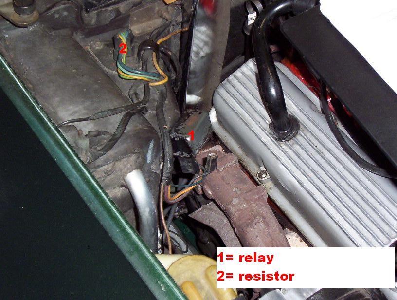

Comming home from a local car show with the ac on and I reliesed the high speed fan was not
working is that the relay under the hood or the one in the console, I can’t remember.

Underhood.
There is no relay for the A/C or blower motor under the console.

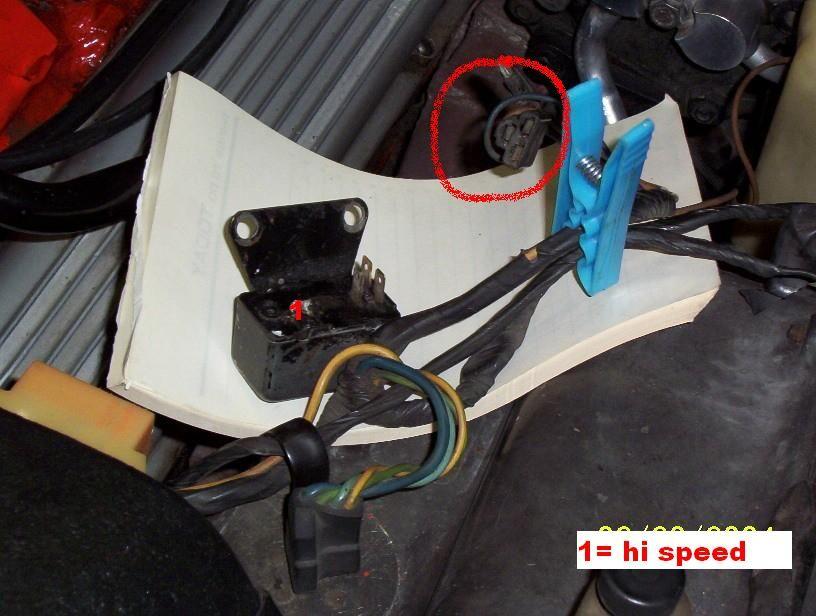

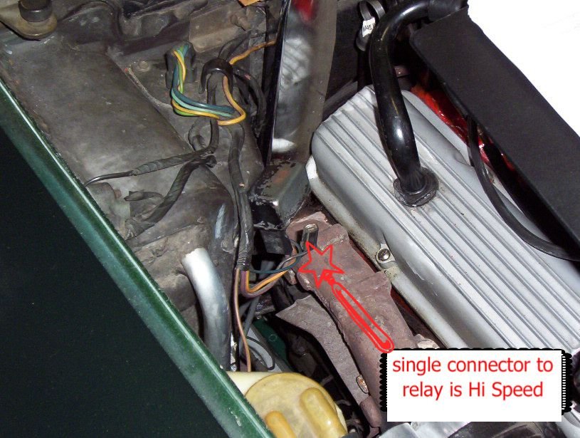

Originally Posted by Ed T
hard to see in pic 2 but this hi speed lug (1) has toasted off of the relay
Sorry I have a 69. I replaced that one last year maybe the connector came off.thanks.

This is common for the ORANGE wire that goes to the relay to get 'toasted off' the relay due to the amount of current that wire is drawing and how the connection is out there in the engine compartment where it can get dirty.
When you go to HIGH speed for the fan The resistor is no longer in play and is not a part of how the fan runs on high speed.
DUB
