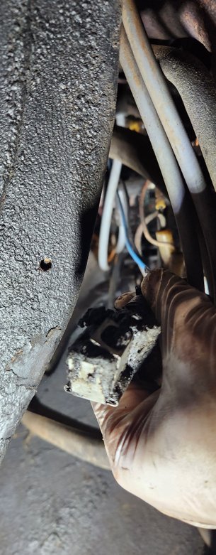

Hey guys. Two weeks later and I have not been able to find a used knock sensor. Have emailed everyone I could find through google. Have emailed specialists for vehicles that use the same sensor. Nothing. Nowhere.
So, my questions:
Can you run without the sensor? What issues can this cause in the 82 cross fire engine?
Is there a sensor that can be used instead? I understand that wiring change will probably be required.
Is there another option that doesn't include entire engine replacement?

Well, sure as **** it is still there.
46,000 mile car.....I would assume that it is still good.....
If someone wants this, PM me....buy me a bottle of Crown and it is yours!
Jebby

Jebby, can you take any numbers off the side of the sensor, it may help on the part search? Thanks.

I will get it off this weekend.....I will have to jack it up to get to it.....

Apparently you DID NOT read the explanation I wrote above to Hal on this when we were researching the knock sensor dilemma...
IF THE KNOCK SENSOR IS UNPLUGGED AND CAR IS DRIVEN, THE COMPUTER STILL COMMANDS A SELF TEST OF THE KNOCK SENSOR 2-3 TIMES PER HOUR ENGINE ON AND CAR DRIVEN.
FULL IGNITION TIMING ALLOWED. CAN BE AS HIGH AS 50 DEGREES BTDC.
NO KNOCK DETECTED. ECM ASSUMES KNOCK SENSOR FAILURE.
IGNITION TIMING PULLED BACK 30-40 DEGREES.
NOW THE ENGINE HAS ATDC IGNITION TIMING.
VETTE RUNS LIKE CRAP.

My first try would be to measure the resistance of the knock sensor to ground…..
Put a resistor close to this inline to ground.
The ECM may call for it but if it sees the correct resistance then all is well…..
The knock sensor being only a “warning function” might be ok by tricking the ECM….just a thought.

Well Jebby, I do not think that would work actually. The ECM is not looking for a resistance value coming from the ESC. The real trick would be to fool the ECM that all is well via the ESC and the 5v signal. I'm sure it can be done and may tale some redesigning, but I'm done even thinking about this subject for a while, I have other things going on that take priority at the moment. I was going to get with my EE friend and see what we can come up with, but again, that will be another time. I will let one of the newer CF WIZ kids come up with a permanent solution.

Buccaneer is correct. The early ECMs don't have the ability to read the resistor in the sensor. (The resistor in the early knock sensors is there to bleed off voltage from "rough" handling prior to installation on the engine.) Once the sensor was installed and connected up on the engine, the resistor was essentially dead weight/ballast, as the ESC circuit provides the input impedance.
You are on the right track regarding some of the later ECMs and knock sensors. The ECM looks at the knock sensor resistance to determine if the sensor is hooked up. (This method only senses that the sensor is hooked up, and not if the sensor is generating an actual electrical signal.) The later yet ECMs looked for AC signal activity on the sensor line to check for sensor connection and integrity.
Disclosure: My experience is primarily with the '84 to '96 ESC systems, but I enjoy a good technical discussion about the '82 system.

Car seemed to be running OK with sensor disconnected. Half hour to 45 min. trips, 60-70mph. Idles smooth. The stud broke off sensor leaving a hole on top. I threaded the hole today with 1/4-20 bottom tap and installed a set screw a couple turns and attached connector. Solid but I'm not sure if it's working or not. Seems to be running the same (good).

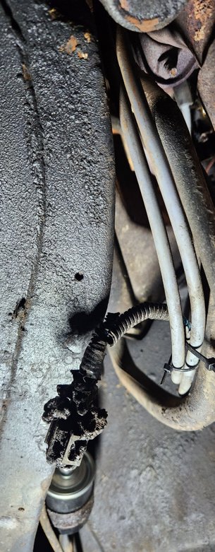

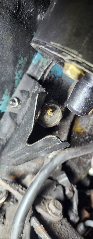

I just bought this 82 collectors edition and have numerous issues. Changed the Coil, Starter as it was having issues starting and the negative cable was getting hot. It no longer does that and it does start right away.
I found the knock sensor connector lying on the exhaust and burned the connector. Trying to look of a connector but could not find the on displayed here on this thread. So ordered one from corvette central will report back when I put it in. The car runs crappy without the sensor connected. Before I removed the sensor wire off the exhaust pipe I also tested the MAP sensor it does get 5v but on the signal wire the voltage increases from 0.73 mV to 232 mV Could this be due to may be the connector shorting out. I did not check the map sensor after taking the knock connector wire off the exhaust pipe will do that and report back. Still would like to see if some one has finally found a knock sensor in the market. It seems like a very hard part to find like many others for this Model. Buccanner you have recently responded to my thread on crank but no start. Appreciate all your guys help.
Old Dec 13, 2023 | 05:28 PM
  #60
Buccaneer's Avatar
Buccaneer
Joined: Nov 2005
Posts: 3,532
Likes: 1,185
From: Arizona - If you don’t know CFI, STOP proliferating the myths around it...
I think your ECM is bad, but you do seem to have a lot of issues going on at the same time.
