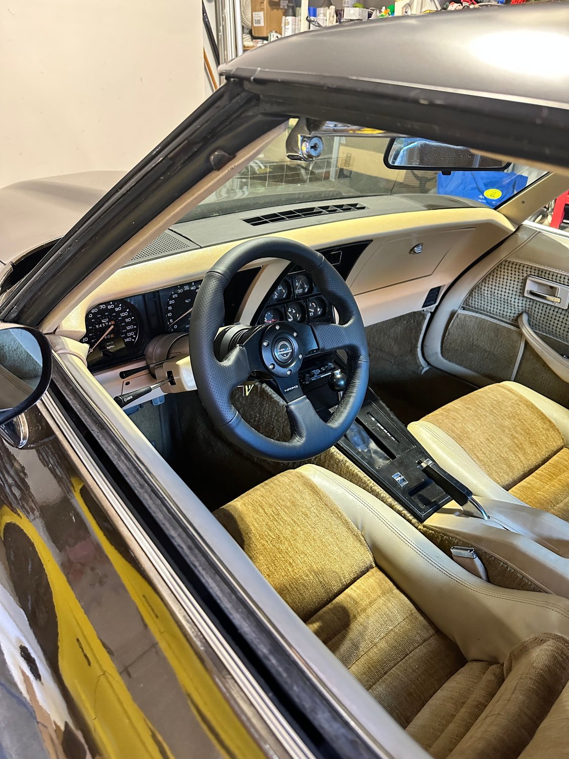

I know this thread is super old, but I recently was able to mount a NRG quick attach hub, short hub and steering wheel very easily. You loose the horn and have to set the tele ahead of time but the wheel is much nicer overall!

Your right. this is a very old thread. Did you consider starting a new thread? Maybe title it, "Steering wheel with no horn".
Or just put it up on the "What did you do to your Corvette today". Thread in C3 general.
Buy the way, Very ugly wheel for a vintage car.
