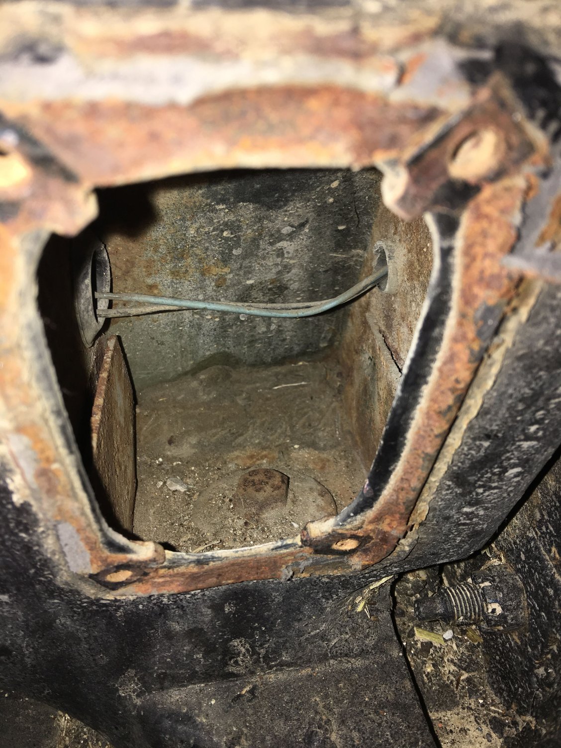

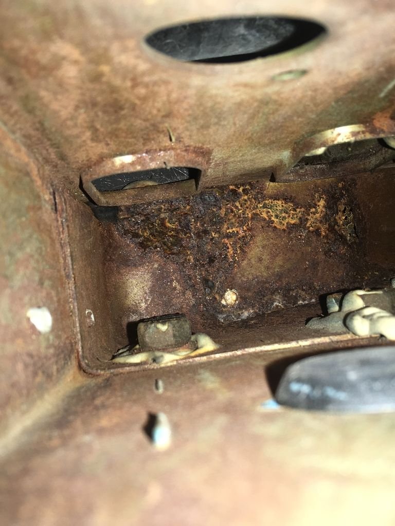

I have seen so many pictures of birdcage rust and repair (and what it takes to do these repairs) that I am getting paranoid and anxious.
The underside of my car look crisp and taps solid. Behind the kickpanels looks like this:
No rust is falling out of the doors. I can see that the riveted firewall is leaking slightly and needs attention.
Hmm... I guess my question is, how frequent is birdcage rust on decent looking cars ?

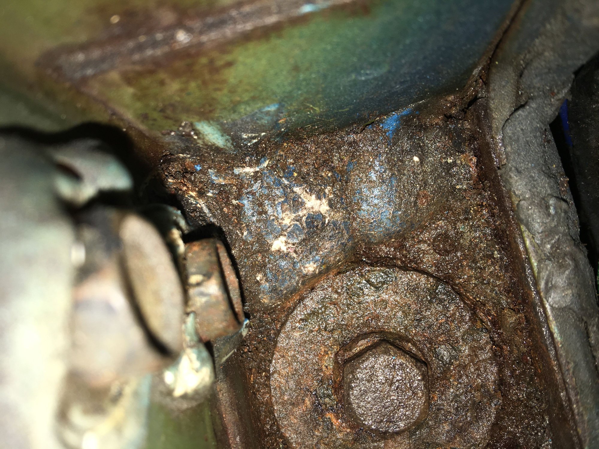

Yes, it had just rained a lot when I took this pic...

The parts look solid, but figure out how the rain is getting in, and fix it.

How would anyone know that? Your car looks damp, but otherwise pretty good.

I agree that it looks solid and is not a concern. But get the leak fixed or it won't be solid any longer.

Did some more snooping. More solid than it looks on the pics... I think I will give this concern a rest.
Is it a good idea to apply some sort of coating to this??

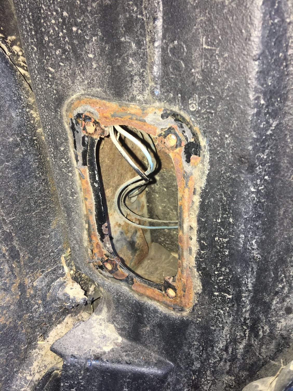

Should I spray something on these surfaces as well?

The green is zinc chromate. You won't find a better pre-mixed primer. It is toxic, so spraying your birdcage inside your garage may not be advisable. I use it on anything I can remove from the car, though, such as the center armrest support.
I'd suggest wire wheeling what you can, then using Ospho to convert what is left (brush on, protect your carpets). Alcohol wipe when done. Then what paint over that? I can't say.

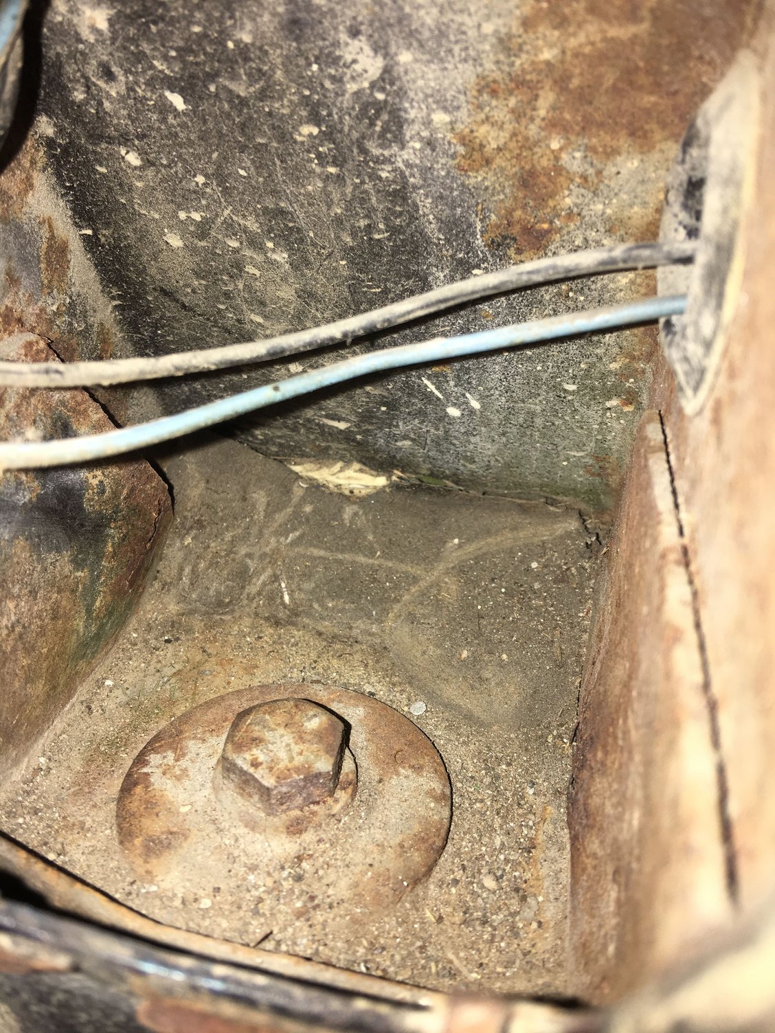

The rear looks in reasonable condition as well.

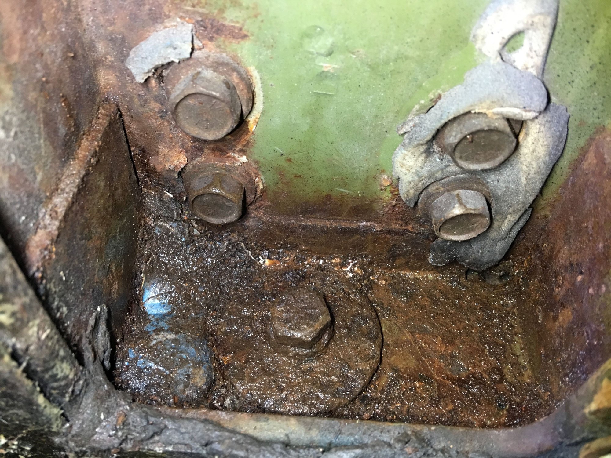

Reasonable here too

You look to be in pretty good shape.
The Ospho recommended is good stuff. You can brush or spray it. Just don't let it puddle on your garage floor. It is an acid and will etch the crap out of concrete.
For anything painted not exposed to direct sunlight, POR 15 is great stuff. Just don't get any of that on you. Nothing takes it off, you'll be wearing it for a while if you do.

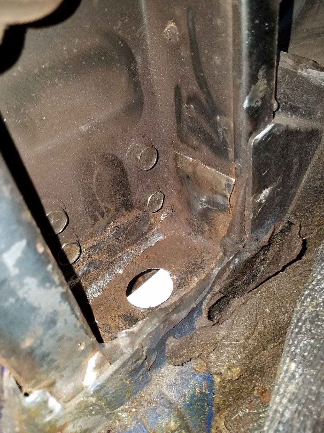

#2 look good. so did mine. when you start dissasembling i hope you dont run into my issue.
Before
After
Old Oct 11, 2018 | 09:00 AM

@gmmeyerIII Sorry but can you explain to me what I am looking at ? What the concern is... not the location.

It's rotted under/between the rubber bushings and is hidden under everything removed and cleaned up. Very common on any vehicle to remove a body bushings and find bad rust under it while surrounding areas look good.
