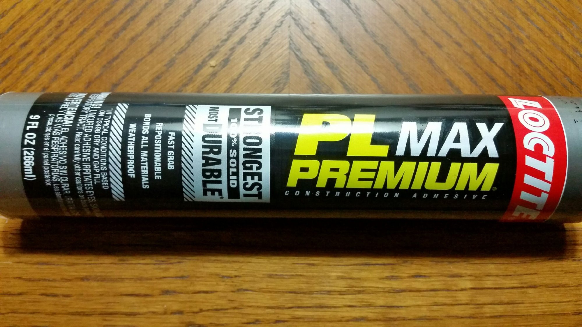

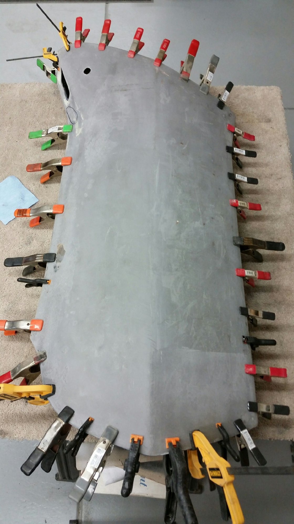

I can't remember which thread had the question of gluing door skin to it's metal frame, so I'm posting what a friend of mine did to get the job done.
Her comment: "You can never have enough clamps."
Steve

I use SEM 39747 glue... you scuff, you glue and then you clamp and you have about 1 hour of working time..... this stuff will glue oil to water... The down fall is you must have the application gun to install it.

Hope that works OK for you. SEM for the WIN!

Must be a Beverly Hills door skin. Looks like the Clamp-it family moved in.

you're going to need a garage addition to store all those clamps

YES..as Willcoix stated the SEM 39747 is also what I use and due to being EPOXY based. IF all of the bare metal is covered with the SEM adhesive it cannot rust.
